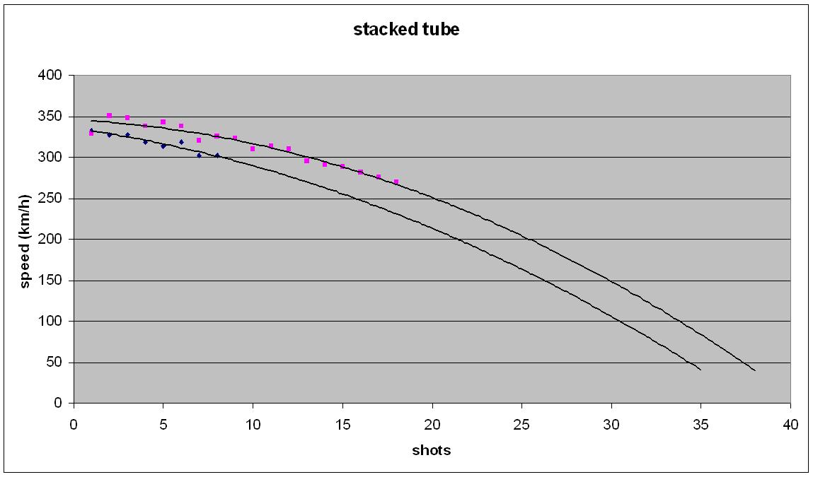

Unread postAuthor: jackssmirkingrevenge » Wed Jan 16, 2008 11:58 pm
Techincally, as you shoot, the pressure goes down (meaning less power) but the resistance on the valve is also less, meaning it opens for longer (more power) so there should be a reasonable level of consistency.

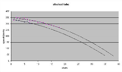

Unread postAuthor: Antonio » Thu Jan 17, 2008 8:22 am
jackssmirkingrevenge wrote:Techincally, as you shoot, the pressure goes down (meaning less power) but the resistance on the valve is also less, meaning it opens for longer (more power) so there should be a reasonable level of consistency.
Thats exactly correct. As thought I have done measurements of speed decrease over shots, and it does go down eventhough the dwell times go up. I guess bc the barrel has a certain length and a longer dwell time has no effect. I have this graph here of the stacked tube airgun (check attachment). I am not sure what bottle I used on this test though, 0.5L or 1.5L I also did this test before I had a compressor so I dont know the pressures I used.
jon_89 wrote:hey ant you know what would be really nice? maybe post a how to on this gun. :lol:
Hey yeah I know, but I am focusing on more simple guns posting whise as I think ppl should first get going on making a valve who are interesting in this project. This airgun looks good and is veeery efficient but its recocking system is slower then the other guns i made. I was ganna try to make this one auto just like spyder paintball guns. But this doesnt really work out due to leakage of the hammer. So yeah my advice is to look at my other projects and start of a bit easier. As I live in a othercountry as well I dont know what is available in other countries.
