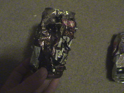

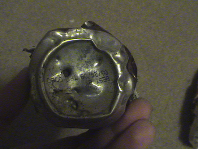

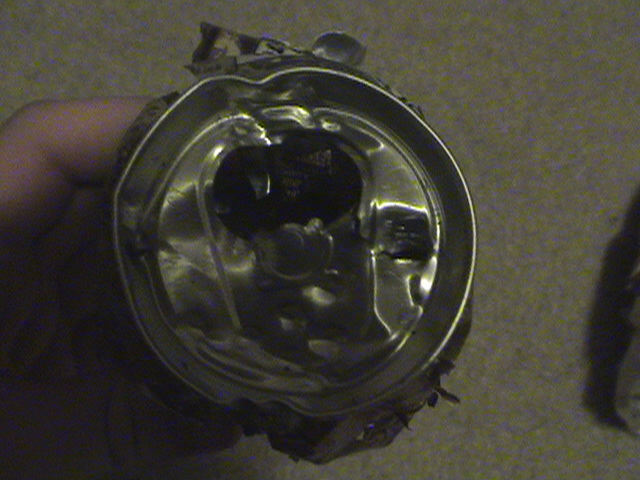

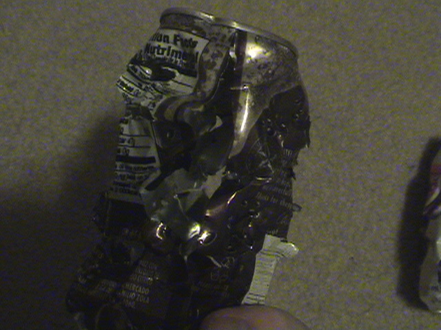

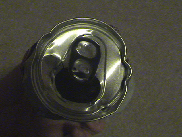

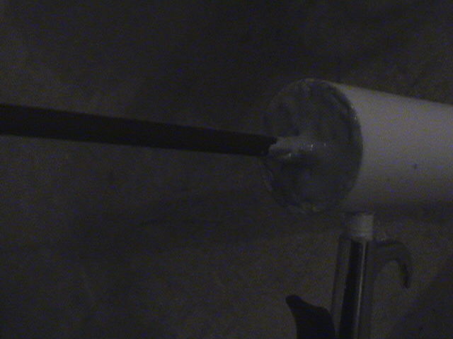

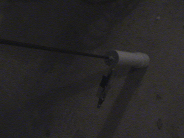

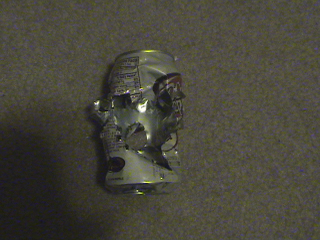

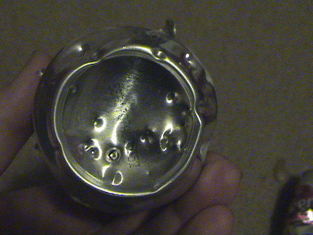

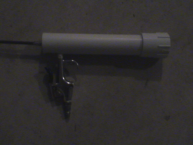

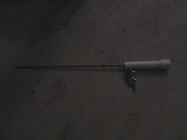

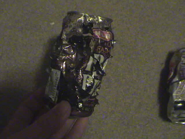

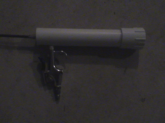

Well like the title says, this is my first BBMG. It is an inline style with an acrylic block, bought from noname. It has a 3 foot Barrel, made from 1/4" steel brakeline, for shooting .177cal BB's. As well as a 1 foot chamber. I tested it this weekend and went through 12,000, yes 12,000, BB's. I am quite impressed with its performance, as I am getting about a 2' spread at 25' and I managed to get some damage shots on the oh so original soda can. I have a bunch of old useless CD's laying around so I will shoot at those as soon as I get some more BB's. Paint is next on the list along with a barrel cover made from 1/2" pipe. Well I'm sure you are ready for the pics so here they are!!

nice for a first. what is on the connecting piece from the brakeline to the pvc? epoxy? i thought 1/4 was to big for .177 calibe bbs. and what size chamber do you have?

Specialist wrote:nice for a first. what is on the connecting piece from the brakeline to the pvc? epoxy? i thought 1/4 was to big for .177 calibe bbs. and what size chamber do you have?
1/4" brakeline fits them really nicely actually, and the connection is a disk of 1.5 pvc rod turntd down on my 'lathe'(drill) to fit in the 1.25 pipe then I epoxied the disk to the pipe and the barrel into the disk.
