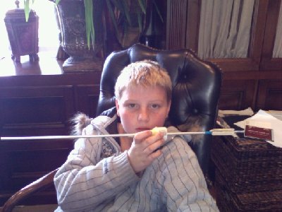

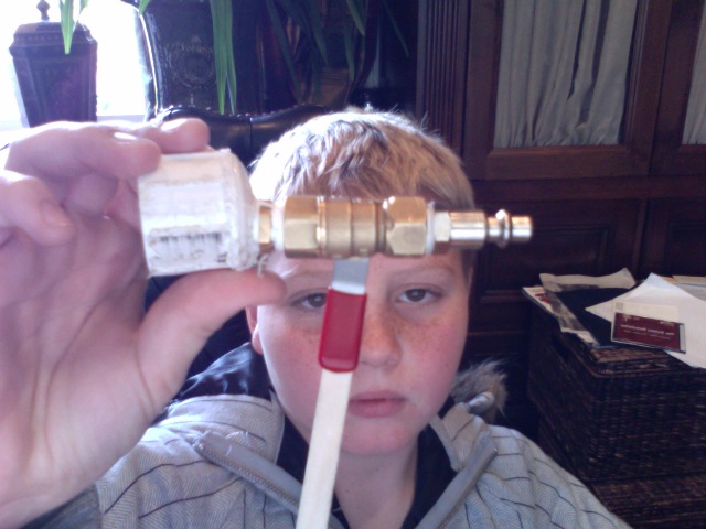

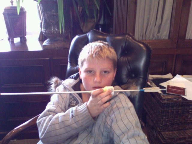

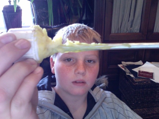

Okay here is my coaxial bb gun
barrel:2 feet of 1/4 brake line

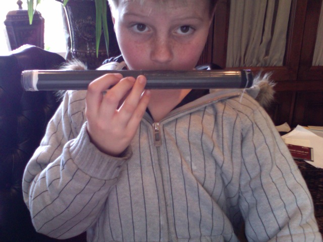

chamber:1 foot of 3/4 sch 80 pvc
exhaust valve:1/4 ball valve
Operating pressure:100-140 psi

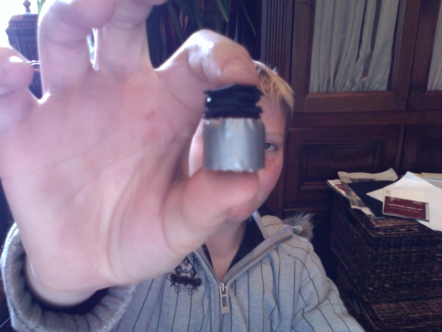

piston:1/2 inch copper end cap wrapped in a little bit of tape with two layers of bike inner tube for the sealing face.
There is a slight leak in the barrel witch I need to fix other than that it is very powerful it can shoot straight through a metal zippo lighter fluid can with a .177 metal bb. from about 40 feet away.

Unread postAuthor: VH_man » Thu Dec 11, 2008 6:29 pm
Are you sure that leak you were having wasnt the stuff you used to seal your barrel in there?
Otherwise, Nice. any shots of the cannon in its entirety?

Unread postAuthor: jrrdw » Thu Dec 11, 2008 6:32 pm
You gonna seal that barrel from the inside?

Unread postAuthor: ckman » Thu Dec 11, 2008 8:19 pm
yeah im sure because I epoxied all the way around and made sure there were no leaks.
Yea im gonna seal the barrel from the inside

Unread postAuthor: psycix » Fri Dec 12, 2008 6:59 pm
Your epoxy use is... excessive.
Nice gun. Is the barrel perfectly parallel with the chamber?
Kudos on the foot picture though! :D

Unread postAuthor: ckman » Sat Dec 13, 2008 2:08 am
yeah the barrel is perfectly parallel with the chamber
Oh yeah thx :P

Unread postAuthor: psycix » Sat Dec 13, 2008 2:22 pm
Okay good.
Any chance of a vid?

Unread postAuthor: Sticky_Tape » Sat Dec 13, 2008 2:45 pm
I'll dub thee twinkle toe. You gun is ok for a first why not give us a picture of it put together? That SCH 80 looks kind of like steel it is threaded.
