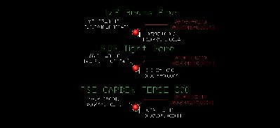

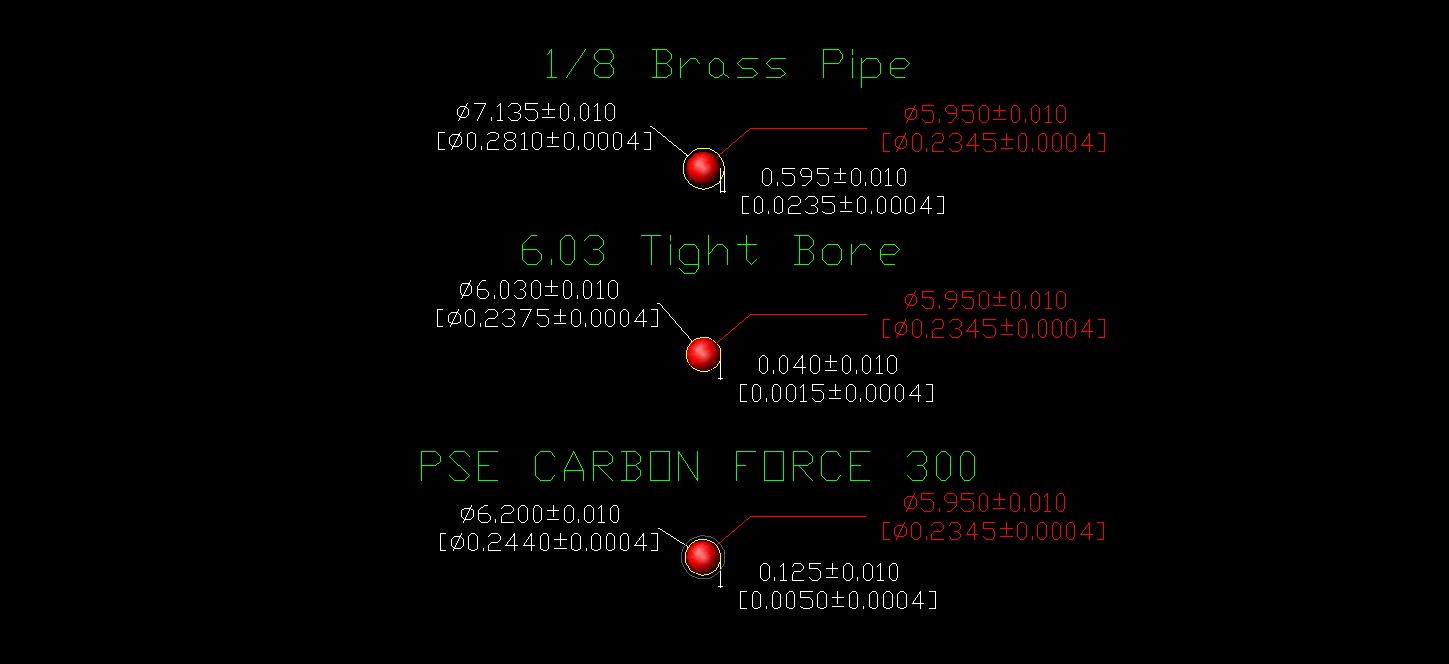

warhead052 wrote:I found out today, that a 1/8" brass nipple, is the perfect fit for an airsoft bb. I am using .12g seamless bbs and they fly excellently. I guess I need to get some longer sections of 1/8" pipe for my next project.
To comprehend how much "slop" or blowby there is, look at this drawing comparing amount of clearance or blow by.
1/8 Brass Nipple/Pipe vs Airsoft 6,03mm Tight Bore vs Carbon Arrow.

Unread postAuthor: warhead052 » Wed Jun 22, 2011 11:10 am
Well dewey, since there has to be room for the bb to get sucked into the barrel, its not that bad. Its better than the 3/8" barrel I have now.
