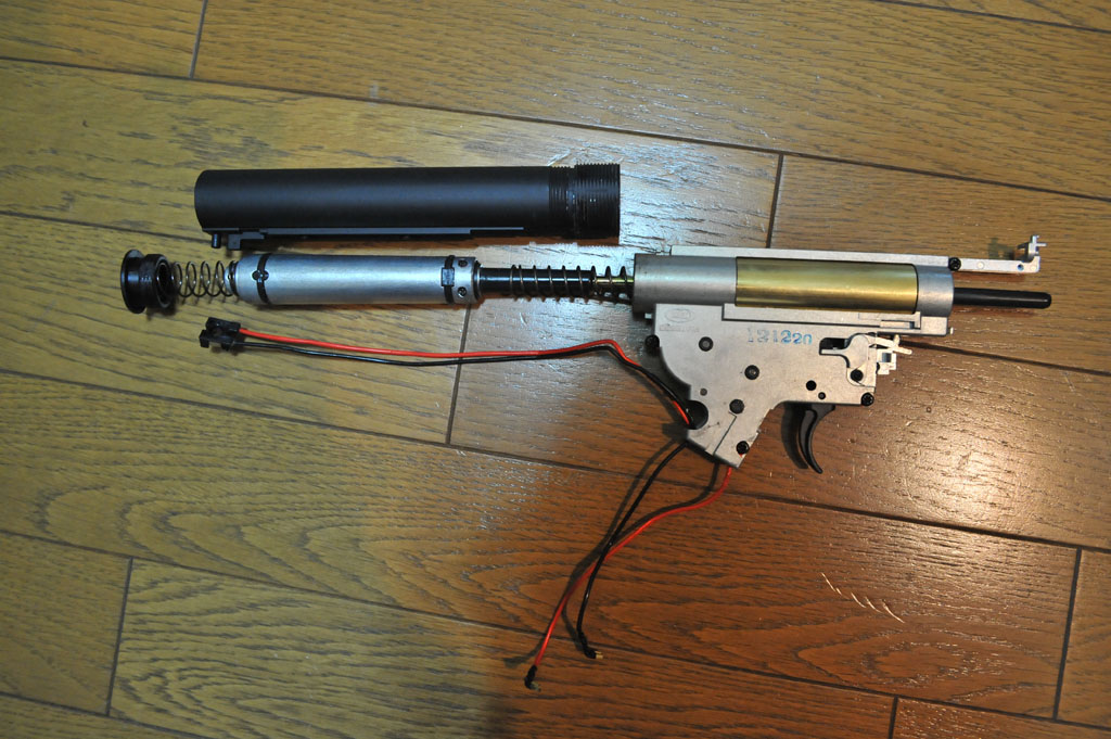

In the Marui recoil series there is a spring with a weight at the end which moves back and forth. You could have a pneumatic ram with a weight at the end which pushes back when you fire, maybe?
  • 0
here's a pic of the Marui system

I have seen that system and was interested in it until I fired one... its kinda wimpy, not to mention its just making an existing mechanical system that breaks more complicated. :shock:

Unread postAuthor: sharpshooter11000 » Wed Apr 04, 2012 12:27 pm
Yeah, kinda wimpy, almost comparable to a .22 rifle. Although with a pneumatic system that could be improved.
