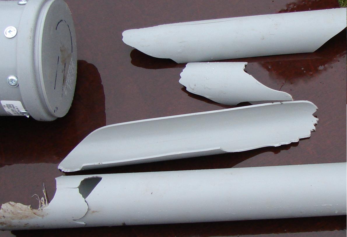

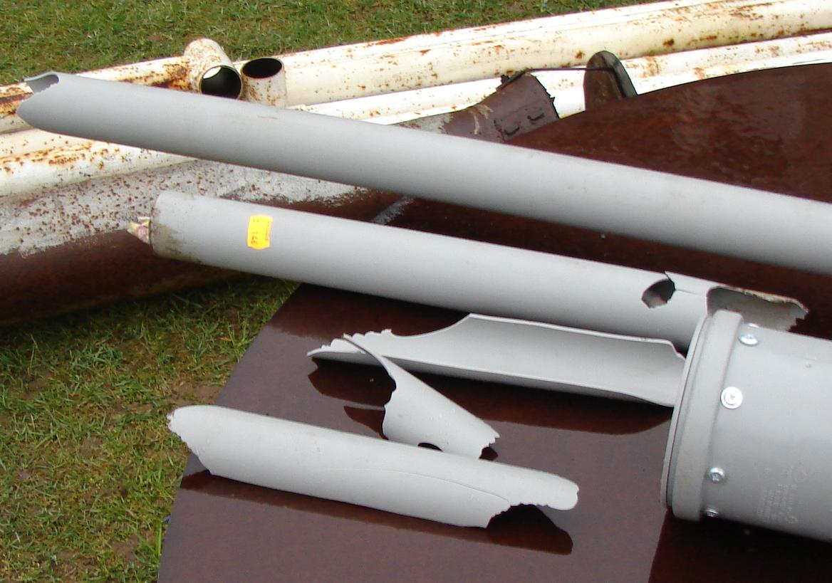

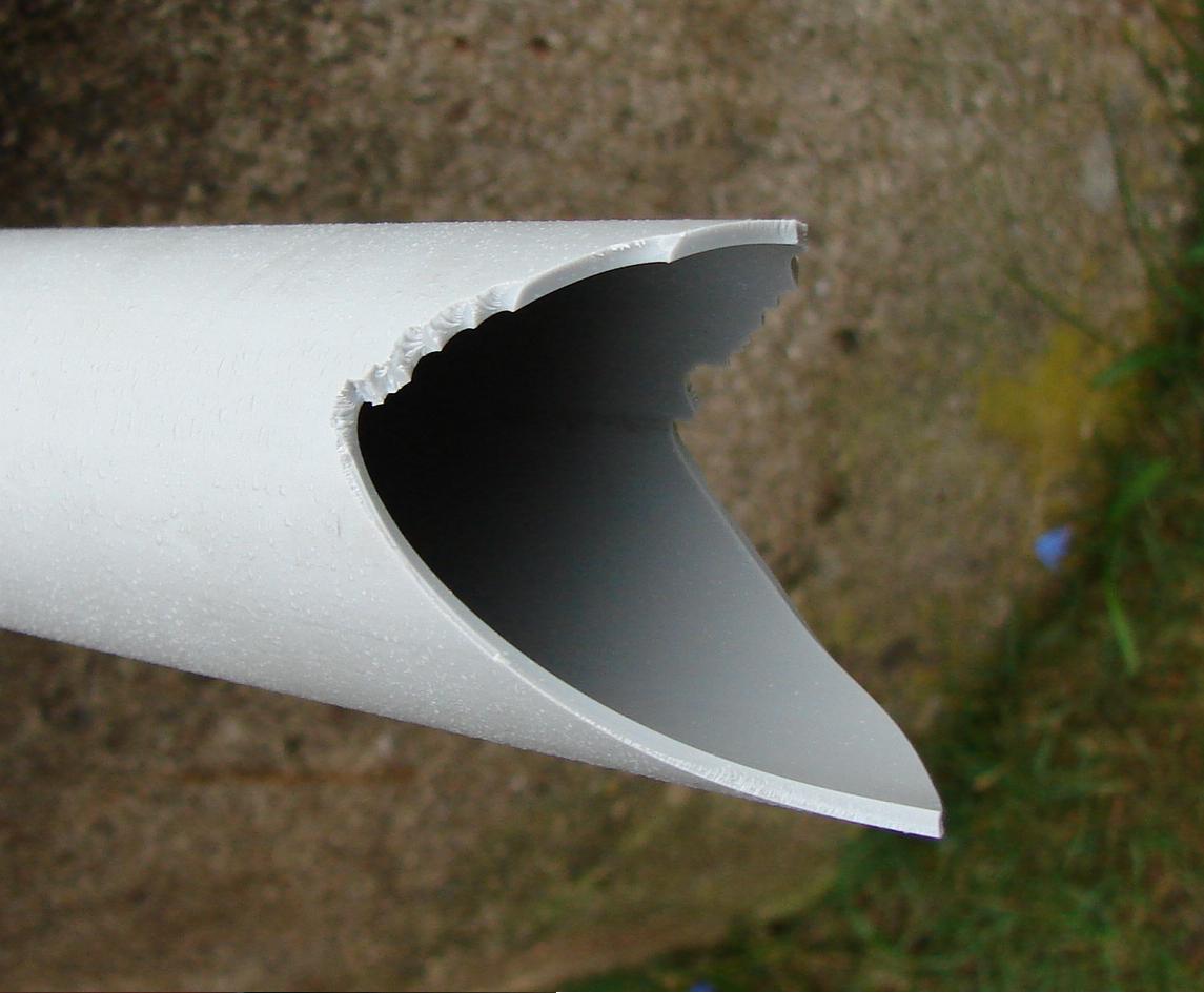

guys - I did it in cold weather ! I try to shot with my gun in cold weather. at first time barrel was great but second time it blow up... here is pictures ...

WoW lucky bastard that the chamber held up!

Unread postAuthor: Grizzlybear » Sun Apr 13, 2008 1:10 pm
I know :evil: ! In a moment it was like - sh*t what just happen? I am lucky .... My good friend was there too and he start laughing ....

I'm ignorant of PVC in that part of the world, but that barrel doesn't look anything like the pressure rated sched 40 stuff we use routinely in the US, particularly in wall thickness...way thin. Cold weather didn't help you any either.
I agree with Poland, if you can't get better quailty PVC, build out of metal.

Unread postAuthor: Grizzlybear » Mon Apr 14, 2008 2:59 pm
1. Latvia is nothing like Ukraine! Similar to Russia?- maybe but that's only because we was the part of russia in ww2(war) and we are neighbors but we get out so nothing common - end of history ! :lol:
2. The metal fittings are cheaper than PVC ? - I dont thin so ! however I have lot of them in workshop but cheaper - no way !
3. i think the PVC definitely is not pressure rated because we use them for sewerage net !

2. & 3. metal is cheaper than pressure rated PVC. I think you already know that using non pressure rated PVC is asking for troubles despite the fact that some people say its ok for combustion launchers...
