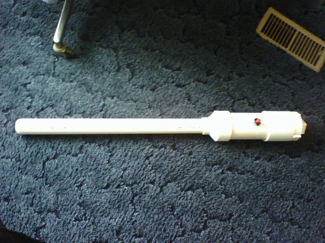

This is my first spud cannon ever
It is a basic combustion
SPECS:
Barrel : 23" of 1.5 " pipe with a beveled edge
C.C : 8" of 3" pipe with bell reducer
Ignition: BBQ ignitor from Kiblers

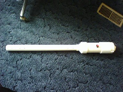

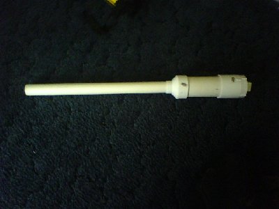

The Dry fit
Final Gluing

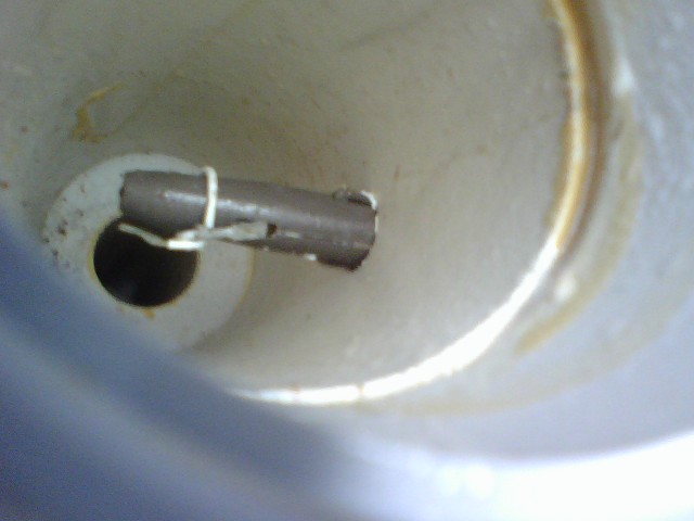

The Ignition

Unread postAuthor: brogdenlaxmiddie » Wed Jun 11, 2008 9:58 pm
Not really a smart idea to put the ignitor in the side of the chamber... Put it through a double-thick spot such as through a fitting

Unread postAuthor: hi » Wed Jun 11, 2008 10:36 pm
it looks good. i wouldnt worry about the ignitor being where it is, it should be fine. the 30 or 40 psi it generates isnt enough to really cause a problem.

Unread postAuthor: bigbob12345 » Thu Jun 12, 2008 8:37 am
Well thats a decent looking cannon.
Ratio could be better though, a 36in barrel would be perfect.
Cant resist commenting on DWV, ahhhh.

Unread postAuthor: sprayandplay08 » Thu Jun 12, 2008 8:44 am
wouldn't 36 inches be too long
  • 0
sprayandplay08
Posts: 59
Joined: Mon Jun 09, 2008 12:00 pm
Reputation: 0
Unread postAuthor: bigbob12345 » Thu Jun 12, 2008 8:49 am
Nope, it comes out at .811:1 and .8:1 is the best ratio for combustions.

Unread postAuthor: THUNDERLORD » Thu Jun 12, 2008 11:36 am
Looks a lot better than my first combustion.
Hope to see your next one.
You already know about the ignitor.
(Maybe try drilling a small hole for just the leads or use two screws to build the spark gap. Next time).
Looks like fun to shoot.
Cool that the barrel is beveled for loading. :wink: 8)
