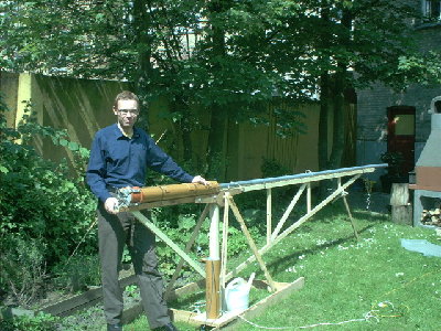

Hi,
If any of you have wondered if it is possible to shoot > Mach 1 with a butane gun, I found the answer a few months ago: It is.
The gun is made of unrated PVC pipe (somehow I'm still alive, but rated pipe is just too hard to get by in Denmark -- nobody does DIY plastic plumbing).

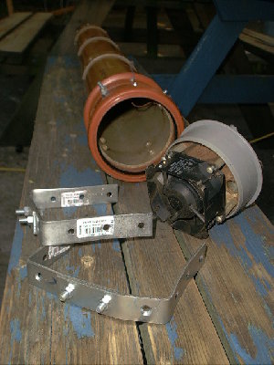

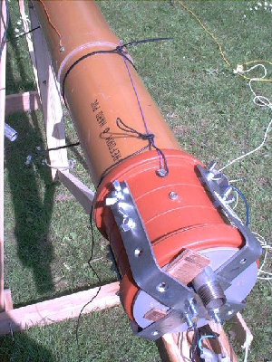

The chamber is 105 cm long, 110 mm in diameter (a long and narrow thin-walled pipe will withstand more pressure than a short and chubby one, for the same volume). The sparker has 4 gaps, evenly spaced. There is a PC fan at the breech end.

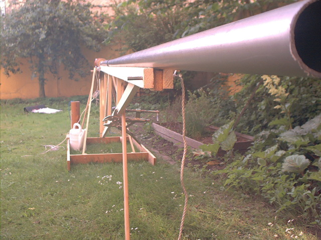

The barrel is 5 meters of 50mm OD pipe. I did some calculations, and found out that with the reletively low pressure of a combustion gun, a barrel of this length was needed.
With a perfect air/propane/butane mix, it would shoot about 280 m/s with a light plastic ball.
With about 40% oxygen in the chamber and a double gas charge, the ball comes out with at least 380 m/s (Mach 1.13) (I put a magnet in the ball and shot it through two electromagnetic coils, starting and stopping a microsecond timer. The coils were 75 cm apart, measuring _before_ the muzzle. At the muzzle, the velocity is yet a little higher).
Sonic booms are LOUD, even for small plastic balls ;)
Safety mesaures included hanging heavy rugs over the chamber, and firing the thing from a gooood distance.
Next thing must be to find out if it can launch a potato at those speeds as well. It will require more pressure, that means, more oxygen and more fuel in a better chamber.
Good fun it was anyway.
Søren
  • 0

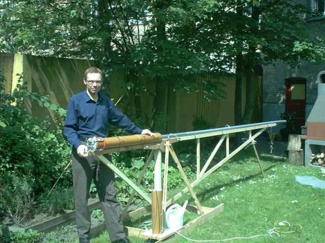

The beast
Breech end

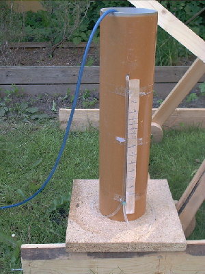

Gas meter device. It is basically a bottle with a hole in the bottom and a hose through the cap, immersed in water.

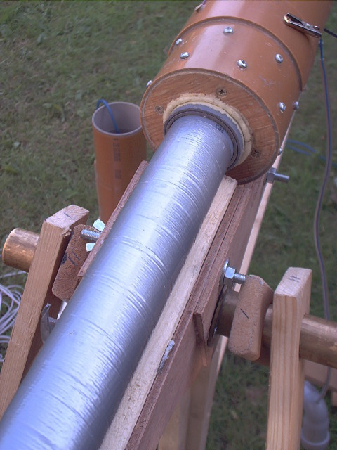

The barrel fits loosely into the socket glued to the front of the chamber.

Breech out.
Inside the chamber

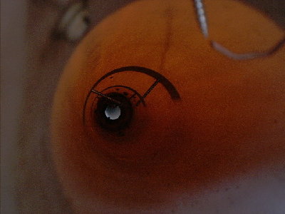

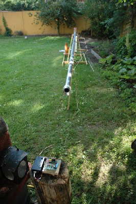

Coils in place around the barrel, and connected to mach meter.

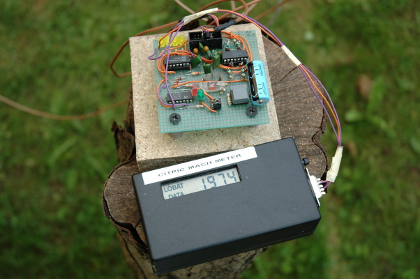

75 centimeters in 1974 microseconds. The mach meter was designed for oranges, but it works for other ammo, too ;)
