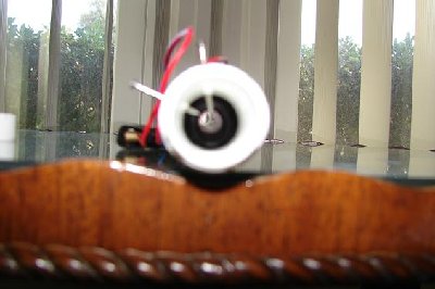

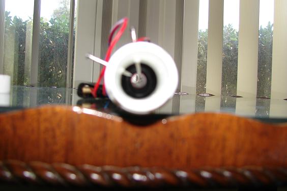

Unread postAuthor: sooch90 » Sat Nov 04, 2006 2:50 pm
MisterSteve124 wrote:You can't mount the igniter on the gun. It would fly out at very high speeds. You don't even have to mount it you can just have it dangling and just press the button. You don't need that metal box it is used specifically for grills. Just cut the wire and strip off the plastic on the outside.
all right yeah. I did see a couple of videos where they mounted the red button igniter actually on the combustion chamber.
Okay here is my idea for the ignition system.
I think the picture might be a little blurry, but you guys should be able to see it. The wires go into the combustion chamber and I'll strip down the wires from there after they pass through the drilled holes.
However, I'm a little concerned with the drilled holes that the wires go through. The wires don't perfectly fit in the holes, so there is some space between the wire and the drilled holes. How would I properly get rid of the spaces and insulate the holes?

Unread postAuthor: sooch90 » Sat Nov 04, 2006 4:02 pm
SpudBlaster15 wrote:
sooch90 wrote:should I attach the wires to the heads of the screws on the outside of the chamber?
Yeah. How did you mount that box in the chamber? Do you have a picture?
sure
It spark box is sort of just dangling inside of the combustion chamber. I guess I could duck tape it down or something...
So do you guys think that would just be okay leaving the spark box in there?

Unread postAuthor: SpudBlaster15 » Sat Nov 04, 2006 4:48 pm
That should work fine, but make sure you seal the holes that the wires run through very well. Epoxy would probably be your best bet.
