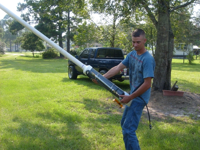

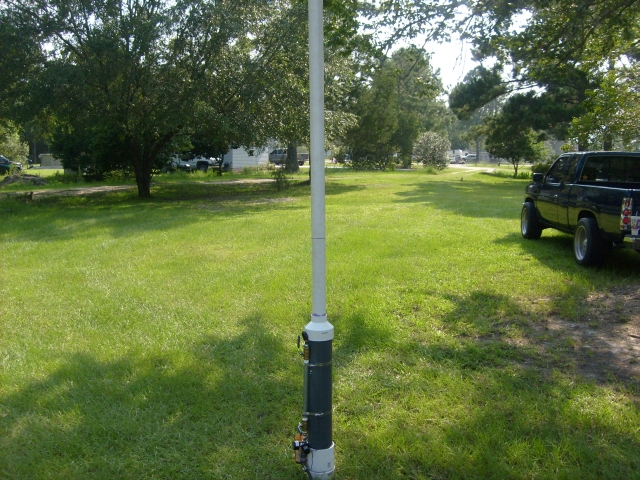

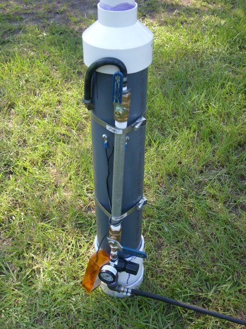

Unread postAuthor: Dornep » Sun Aug 12, 2007 8:56 pm
I will try to contain my excitement but HOLY CRAP BATMAN!
I will admit I made several rookie mistakes while making this gun that I can't go back on now. However I see this gun as only the beginning of what I plan to do with spud guns in the future. The gun still has a few things to be done to 100% complete but it does shoot and shoots well. I have no idea what the range is as it was getting dark once we got everything ironed out with the metering setup. I have a few pictures and some videos of the firing so If you guys want to see them I will upload them to Youtube and link you to them.
These are a couple pic's of the gun

Chamber and meter
