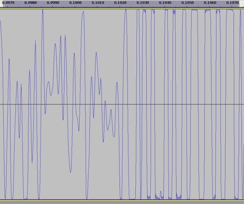

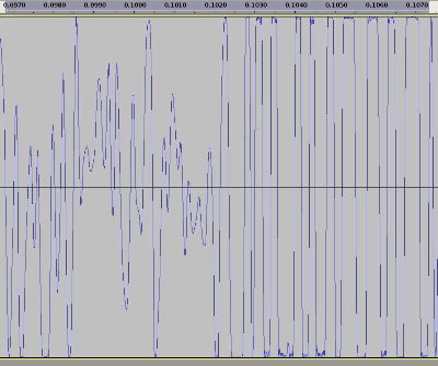

Using Audacity as already shown the details are in the shot. When the time is expanded the reverberation in the room blends the noises together, but the change in sound is very clear. I took the liberty of expanding the area of interest. There is a hiss prior to the bang so this appears to be a traditional piston cannon with a pilot valve. The pilot is relatively slow opening as evidenced by the rate of sound increase. At just after 0.04 seconds the main valve opens. It is unclear at which point after that the projectile exits the barrel. It didn't take long. While the noise of discharge is still happening the impact is very sudden with a high frequency component that is seen at about 0.1 seconds. I think this is the time you are looking for. The time between the shot at about 0.042 (Note the step in the waveform as the initial muzzle pressure wave hits the mic before the blowing hiss of discharge) and impact at 0.102 seconds. This gives a flight time of 0.06 seconds for an average speed of 333 ft/sec.
The change in volume would have been more evident if the record level was set lower so the waveform was not clipped.

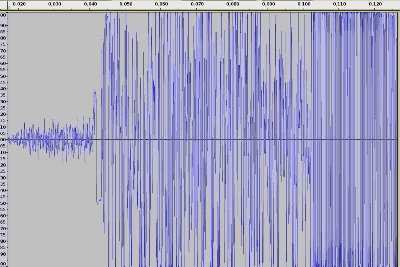

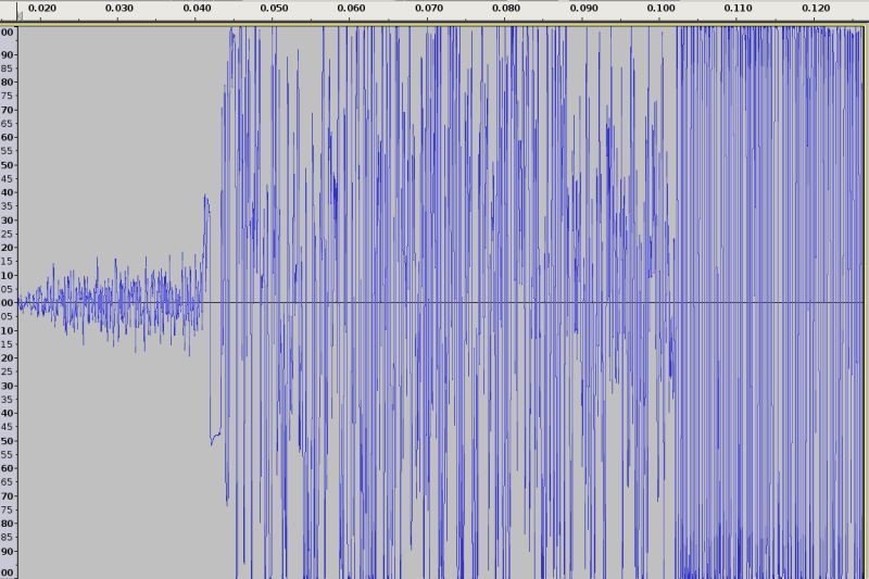

I was giving the waveform more study. The waveform I posted yesterday in a couple posts ago shows the hiss boom of the pilot and main valve opening and the projectile exit with the resulting muzzle pop. I am concerned about the amplitude of the pop of the projectile exiting the barrel right after the hiss. It did not clip the recording. This low amplitude may indicate the valve is restrictive somehow. This can be either the piston ratio is poor so the valve re-closed early, didn't open all the way or bounced off the bumper and re-closed. The valve performance is most likely affecting the performance from what GGDT predicts.
For comparison here is a hiss boom from one of my launchers. This is a dry shot so there is no second bang against a target. On this shot the pressure wave from the muzzle clearly clipped in the recording and flat topped. Edit, I added the sound so you can hear this shot.
At 400 PSI you should have double the speed and 4X the energy, enough to punch a hole in the plywood. I've been punching holes in plywood with 1 inch gumballs on 100 PSI and Splitting 2 X 4's with jawbreakers.
Again, it may be time to analyze the launcher and the valve for performance issues.
As for slow opening of the ball valve, that should not be an issue unless the piston has excessive leakage from an oversize EQ port. In the wave below, the valve was opened slowly also. A close ratio (seat to piston OD) valve will pop open even with a slow pilot valve.

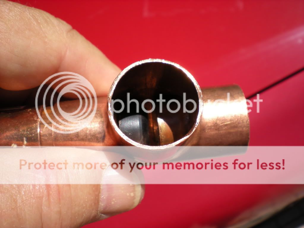

Perhaps this photo will help.Technician1002 wrote:Need to analyze the cannon and not just the sound. Care to post the cannon construction? Piston weight, piston OD/Valve seat ratio, flow path, etc all contribute to the overall performance. A very small chamber and a relatively large piston EQ can quickly bleed down the chamber pressure.boyntonstu wrote:333 fps is about half the speed that GGDT predicts.
If I had to guess, the reason for the poor performance is my slow opening of the 3/8" ball pilot valve.
What do you think might be the reason?
BoyntonStu
The piston will retract and almost disappear.
The fact that there's very little difference between the piston and barrel diameter means that good piloting becomes a bit more critical.
Is that me, or does that piston shove up the T piece so far that it has a direct gap into the pilot volume? Or does the piston have a second piece behind it?
Any chance of a pic of the piston? (Always take pictures from parts before making them unreachable)
Also the piston diameter seems very very close to the porting. This is only recommended when your piston is very tight and your pilot valve is near overkill, because this way the piston opens very late, and more air may leak out of the pilot volume before it snaps open. However, if your piston is very tight and your pilot valve is good, a "snapping" piston gives a faster opening and possibly less bounce due to the pilot volume being at a lower pressure when the valve starts opening.
