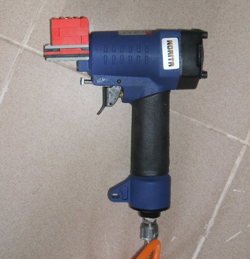

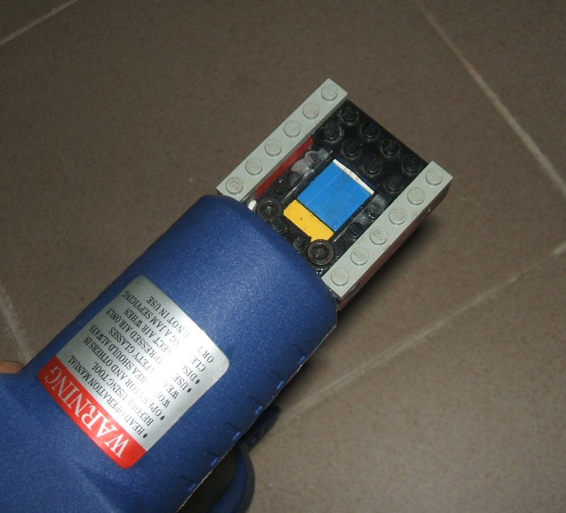

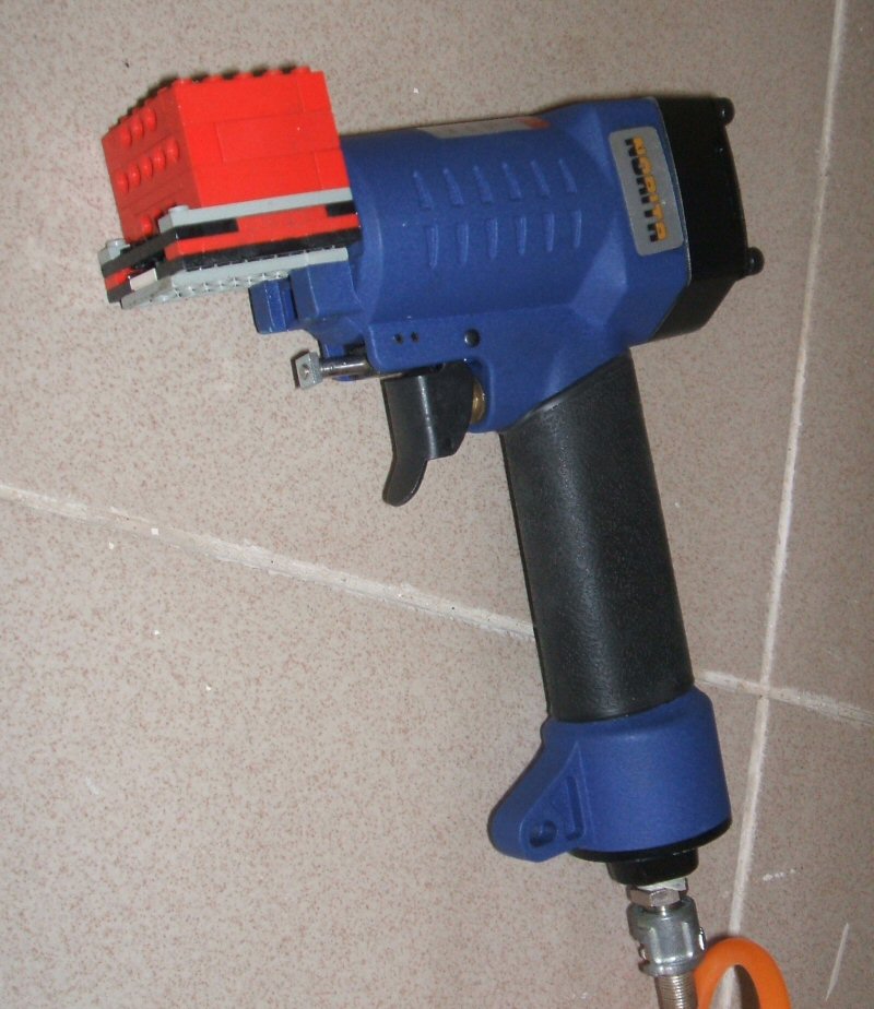

After this discussion on coin launching, I remembered i had an unused pneumatic nailgun lying around and thought I'd give it a go. The mod is quite basic, I removed the nail magazine and replaced it with mostly lego components drilled and filed as needed with two piano wire rails added to guide the coins. The mag is a simple gravity feed. So far I've only tested it at 50 psi as each impact puts stress on the lego that is holding in the hammer guide and shakes it to pieces eventually, it's going to need some proper epoxying to stay in one piece but now after testing I can see it will be worth finishing.

side view
side view
note bolt over trigger to disable safety mechanism.
mag removed to show piano wire guide rails epoxied in place.

I suppose that these coins will not fit through your chrony? What speed do you estimate?
Sadly they don't fit, I'd say velocity is in the 100-200 feet per second range.

you should put some rubber band on one side of your "launching rail" that'd give the coins a spin.

I rebuilt it and the epoxy's curing as we speak. What I did was assemple the unit upside down, pouring epoxy into the underside of the blocks as I went along. This means that not only will they be glued together but also that there won't be any hollow spaces in the construction that should make for a more heavy duty unit and i can take it to 110 psi and do some real damage :D
