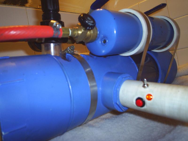

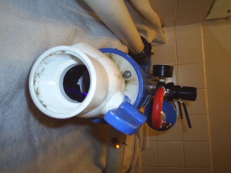

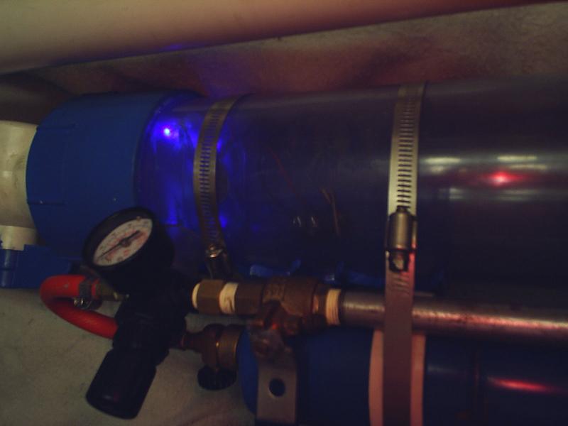

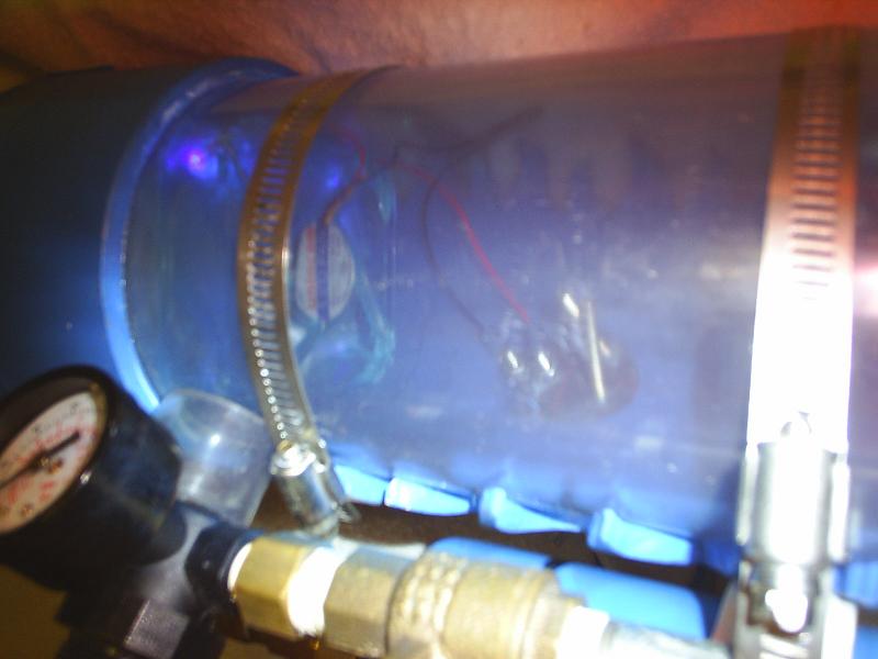

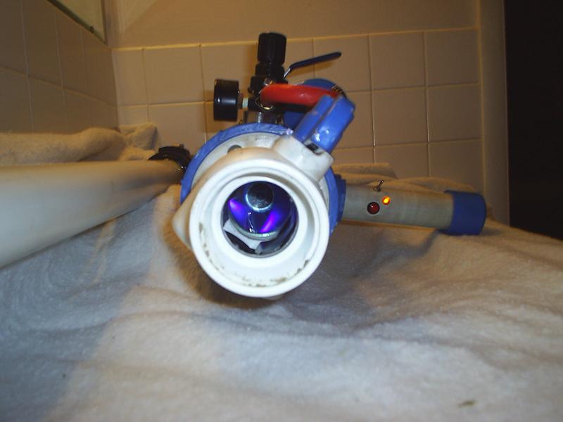

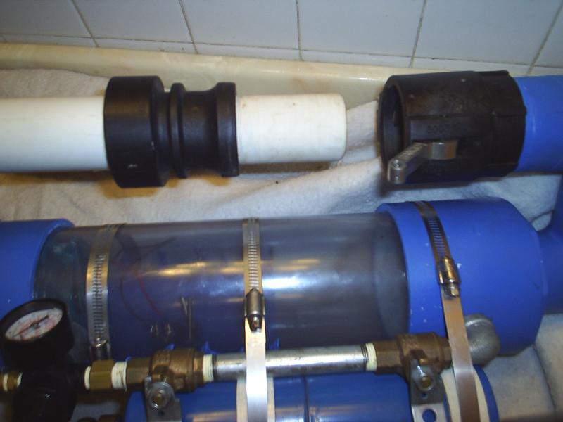

So after 5 and a half months of waiting for parts from Joel and a month of me dicking around with it I finally finished the second edition of the launcher I broke last Halloween: The Blue Flame (I).
This time around I extended the length of the 4" pipe by 4". (So now it's 14".) I also did away with the DWV elbows and added cam-locks and a propane tank track. The flame-notched saddle was repainted and bored out a little to allow for better wire-routing.
I also did away with all exposed wires. Now there is nothing that can get caught or cause ugliness. The fan and stun gun controls are ALL in the handle. Yes, no project box! The leads go right through the chamber using machine screws.

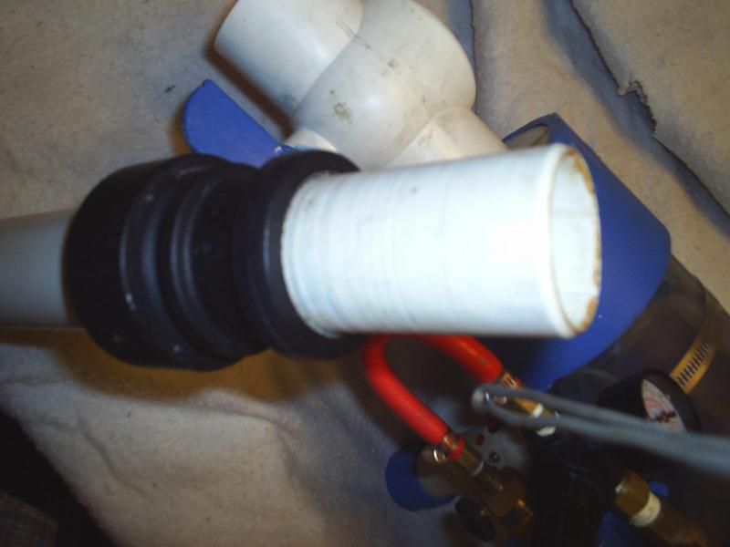

This gun is compatable with most of my barrels including 1.25" sch80, 1.25" sch40, 1.5" sch40, 1.5" sch40 rifled, 1.5" sdr21 (golf balls), 2" sch40, 2" sch40 rifled, 2.5" sch80 (racquet balls), and 2.5" sch40 (tennis balls). I suppose I do have the adaptors to stick on my other barrels but I don't bother to.
The rifled 1.5" sch40 you will see below was modified by Joel to fit through a cam-loc and allow for breech cutting. Normally 1.25" pipe is the largest pipe to fit through a cam-loc but with some lathe work it can be done with 1.5". I found out while explaining this to Joel that Boogieman also requested the same mod job from Joel.
I'll let the pictures do the rest of the work. (Click on 'em.)

irwinner wrote:
wait thats just a normal pc fan, it can acually wistand that pressure? sry im new at this, never seem a fan used before
Well on his gun the PC fan is outside of the chamber, but if their inside it still doesn't matter, the pressure goes out the barrel, not directly to the fan...
Back to top
sgort87
PostPosted: 06/28/2006 0:26 AM    Post subject: Reply with quote
The Gort
<b>Donating Moderator</b>
Joined: 18 Sep 2005
Posts: 869
924.49 Spud Bux
I put the fan on the outside? Really? I coulda sworn I... Well I guess not then...

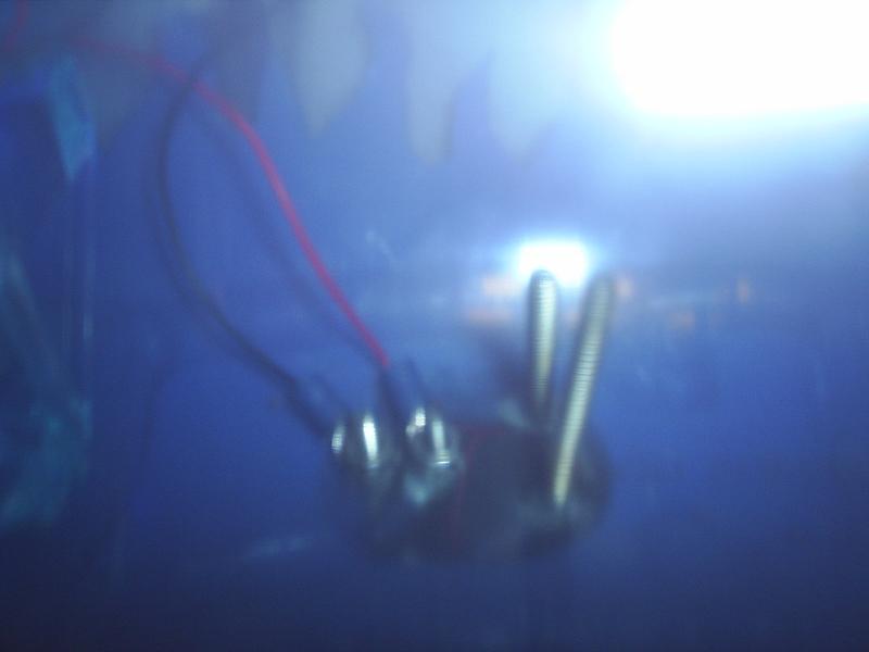

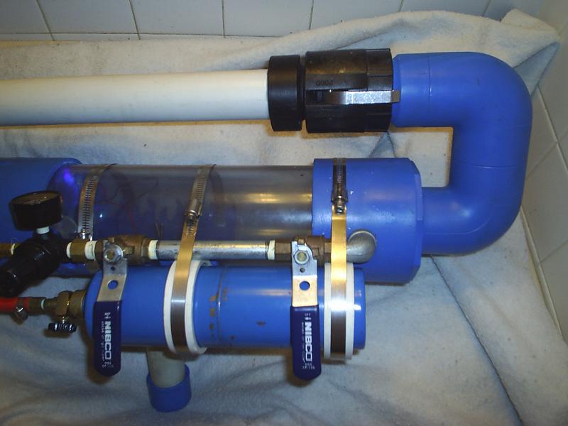

No, it's definately inside the chamber. It's an 80mm 4 LED PC cooling fan. Picture 3 on the bottom row shows the electrodes for the spark and the screws for sending 12V of electricity through the chamber to the fan. You can see the red and black wires that lead to the fan.
I have no external fans, just that one.
The pressure does gto to the fan but what happens is that the pressure is all around it and in it so it doesn't matter.
