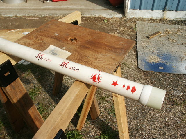

Funny you brought up the topic of gumballs in bulk. I bought a box a few years back too except it was the 1 inch jumbo that is sold for a quarter in th e big machines. The box of large one only had 850 per box. It was my favorite ammo for the Mouse Musket. It wasn't semi auto or anything. I do have plans for a semi or full auto combustion Gum Ball Machine... Gun. Plans are under wraps at the moment on the chance I'll be able to build for the contest.
Mouse Musket and Plywood with the gumball hole.  This is sadly retired.
