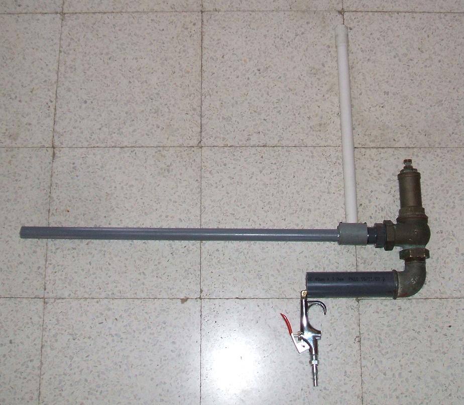

Herewith the latest prototype in my series of pop-off auto launchers.

The heart of the system is a modified 1 inch pop-off valve coupled to a simple tee/detent magazine. I think the low power can be attributed to the fact that the pop-off operates at a maximum of 3 bar (circa 45 psi) and for a relatively short interval, but still, nice to see it operate quite reliably :)
Here's there complete setup:
JDP12

I'm not even using it at full pressure, the problem is that for it to pop, there is a minimum level of flow (otherwise it will just hiss) and since this beast has 1" porting, the flow requirement is too high for my compressor to supply.
ramses wrote:I have to say, though , that a EV+popoff seems much more powerful, as well as compact. Are there any advantages of this, beyond having 1 less part.
If you're talking aboutthis one, psycix is running that at 30 bar, that's 10 times the maximum rating of my valve and for reasons pointed out above I'm actually running much lower than that, I doubt it's popping at more than 20 psi (though I'm feeding 110 psi into the chamber).
The advantage of this system is that it's more efficient as all the air goes through the barrel, it needs to be tuned in terms of spring strength and chamber flow but this is also true of a QEV/popoff system. It really doesn't get much simpler as a constant flow auto valve, unless you use the projectiles as a "valve".

It's already a very tough spring, at its maximum 3 bar rating it's having to hold back around 15 kilos of pressure. The problem as I explained is that it needs a certain amount of flow to work as an auto valve. It's to do with the amount of air going into the chamber versus the amount of air being dumped by the valve. For this reason I can't currently use the valve at its maximum rating.
One possible solution would be to reduce the chamber size to almost nothing.
Also, I agree wholeheartedly with your assesment of marbles as very poor ammunition, I wish there was a better large calibre ammunition that was in plentiful and cheap supply.
Worth noting too that for a relatively low rate of fire, the tee/detent breech was more than adequate to provide a reliable supply with no double feeds.

psycix wrote:Can't you pressurize the piston (or diaphragm) from behind? (instead of a stronger spring)
That might actually work, I can make a gas piston out of a 10mL syringe that fits instead of the coil spring which will have a 1:3 area ratio to the main piston seat so pressurised to 300 psi it should hold 100 psi... hmmm...

What I've done is made the chamber smaller (dramatically so, practically tapped the blowgun directly into the valve) so it gives me some leeway when playing with flow rates. We'll see how it performs at 100 psi.

Curing as we speak, I hope it's reinforced enough to take the 300 psi it needs to hold back 100 psi at the seat (and the subsequent pressure spike when the piston pops), we'll see.
edit: might take a bit longer, I was pressurising it to remove the piston, which didn't budge till about 100 psi then shot out into the wall and shattered *sigh*

Technically it can still be made to work, the air spring was completed and it works, but it needs a bigger chamber to cycle and I never bothered making one.
