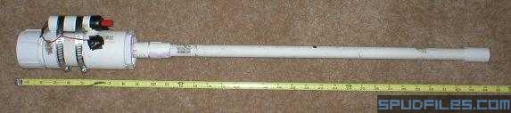

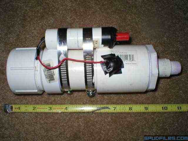

This is my first and only mini spudgun. My friend wanted a gun to shoot blowgun paintballs (in case you dont know blowgun paintballs are .50 calibre) so I suggested a Mini. This was the first time I had ever encountered a mini and DAMN was it a PAIN IN THE ARSE! the fuel mixtures are horribly diffictult to get!
Anyway, the chamber is 2" x 9" with a male adapter and a threaded cap instead of a cleanout. Cleanouts below 3" are very inconvinent so I used this instead. It allows for more room to put in fuel and since the threads are on the outside, they dont get all gummed up with residew. The barrel is .5" x 2' which, with wadding, fits blowgun paintballs nicely. It has a stardard BBQ sparker and one spark gap.
Luckly, I got to give this one away to my friend so I dont have to deal with its crap anymore!!!
<img src="http://www.spudfiles.com/official_pics/MINI3.jpg">
If you want to build a mini, beware! They are a P.I.T.A.!!! You will have to mess with fuel ratios until you get one which will work. Though they are pretty cool....
I plan to build a new mini (for me) with the same basic design, however using a flint sparker instead.

I built 3 mini's in the last week or two and they range from about the size of the one shown to 5 and 6 inch chambers.
getting the right amount of fuel seemed really difficult at first ,then I found out that wasn't r eally the prob. The problem was that the thick 1/2 " chamber to barrel fitting is thick walled and seems to make it hard to get detonation . I really don't know why . As soon as I replaced it with a short metal piece also 1/2" but with thinner walls than the plastic . I started getting detonation nearly every time. With this i n mind I built the other two with 3/4" outlet and they fire nearly every time. So this might help someone who is building a small cannon. Use the largest barrell and outlet you can and if needed ,reduce it a short distance from the combustion tank.
