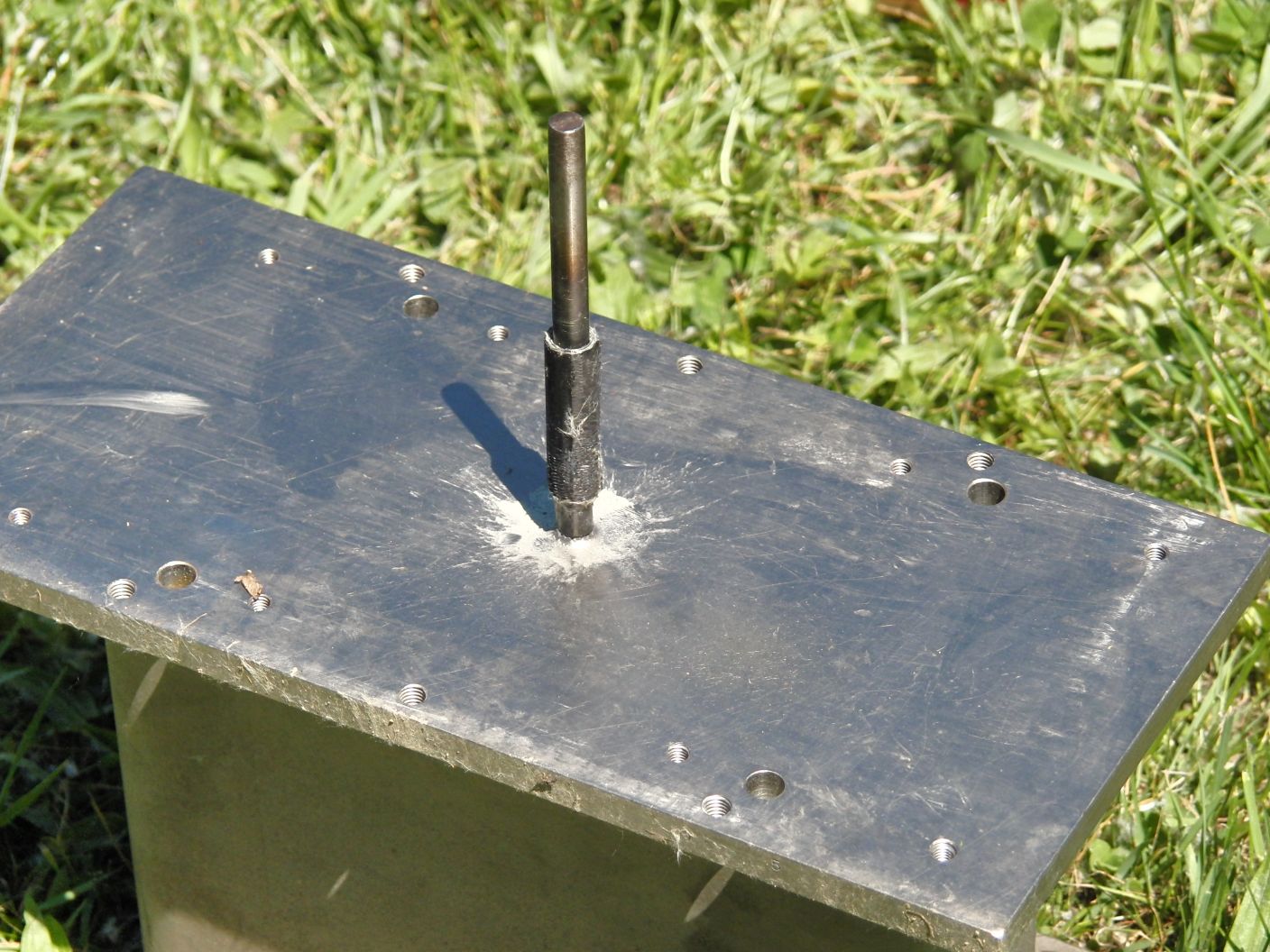

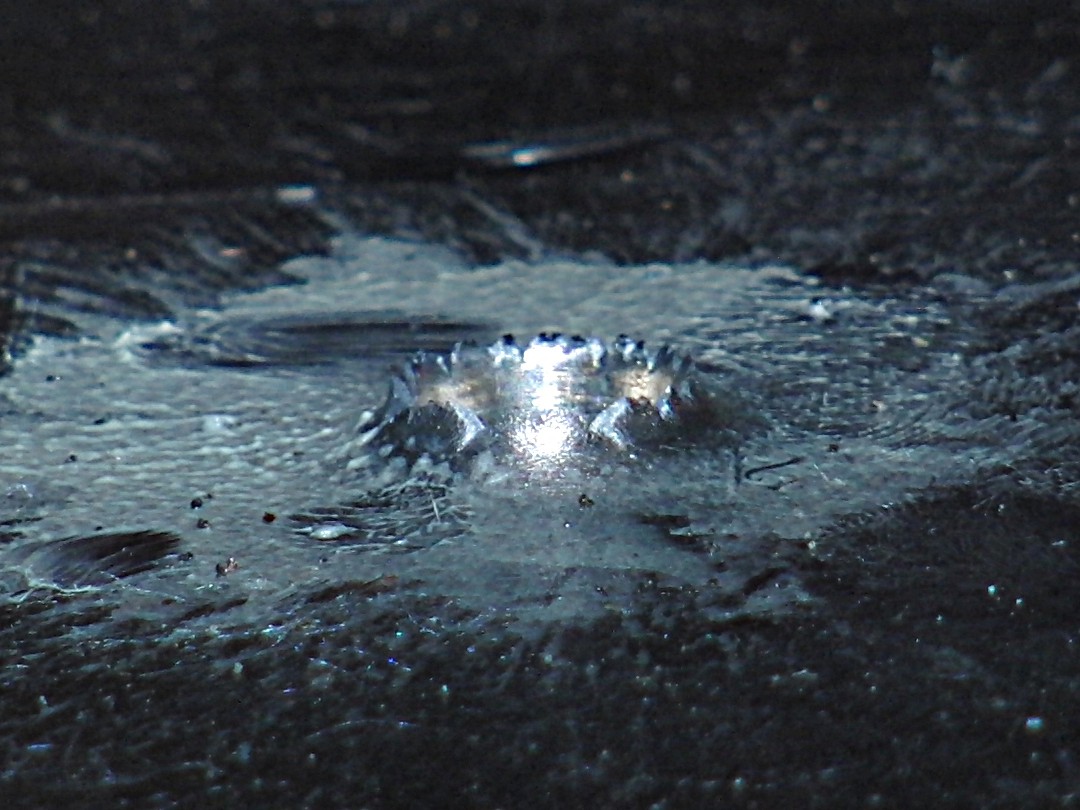

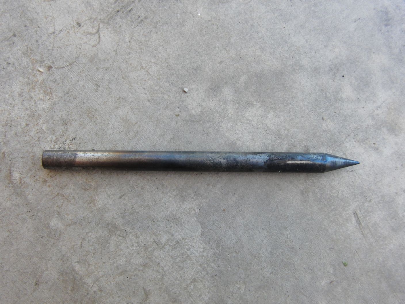

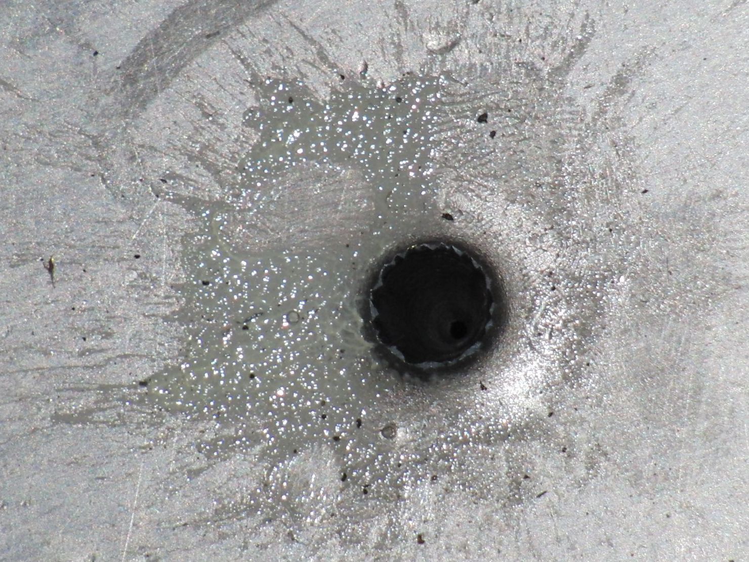

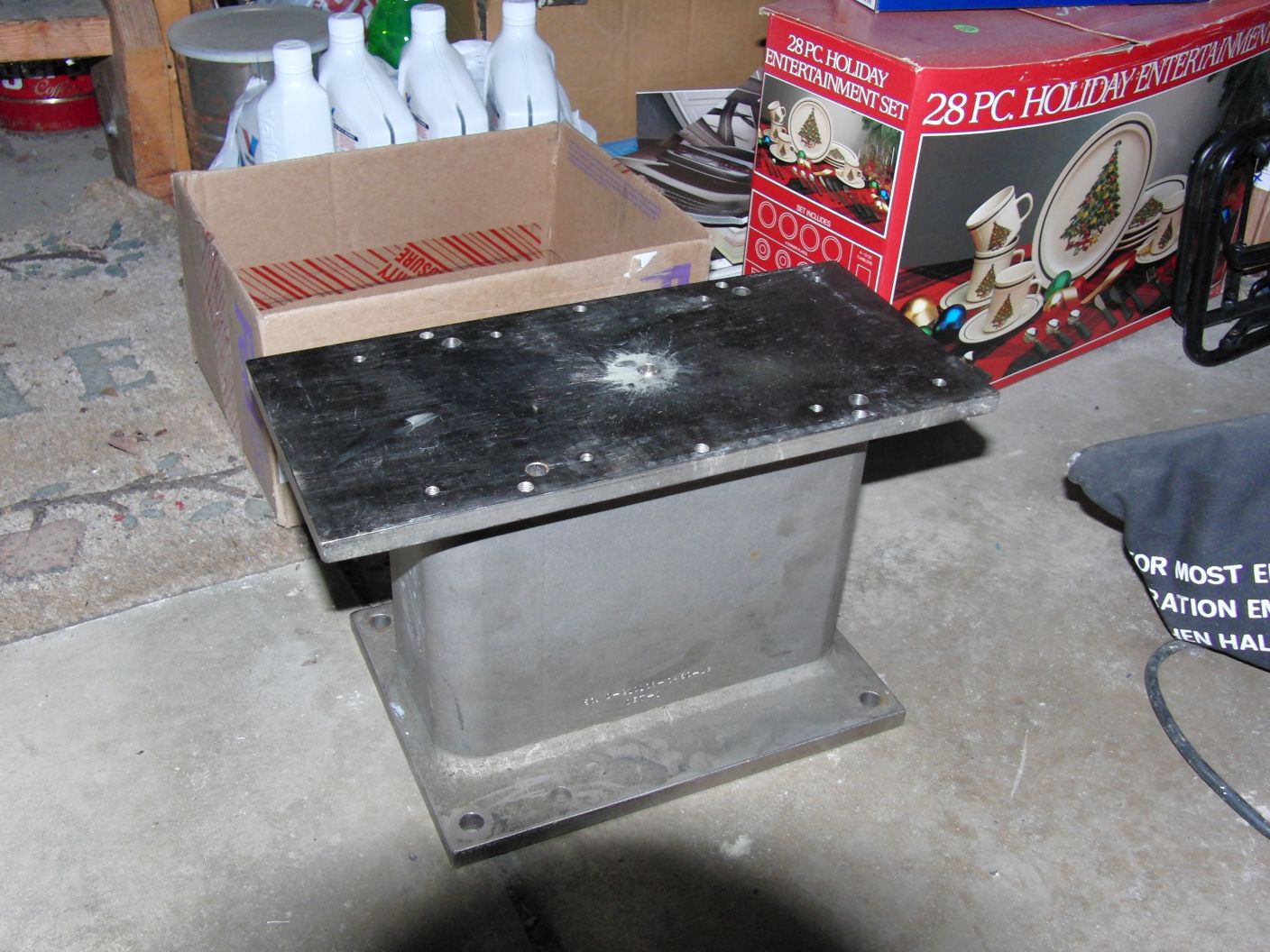

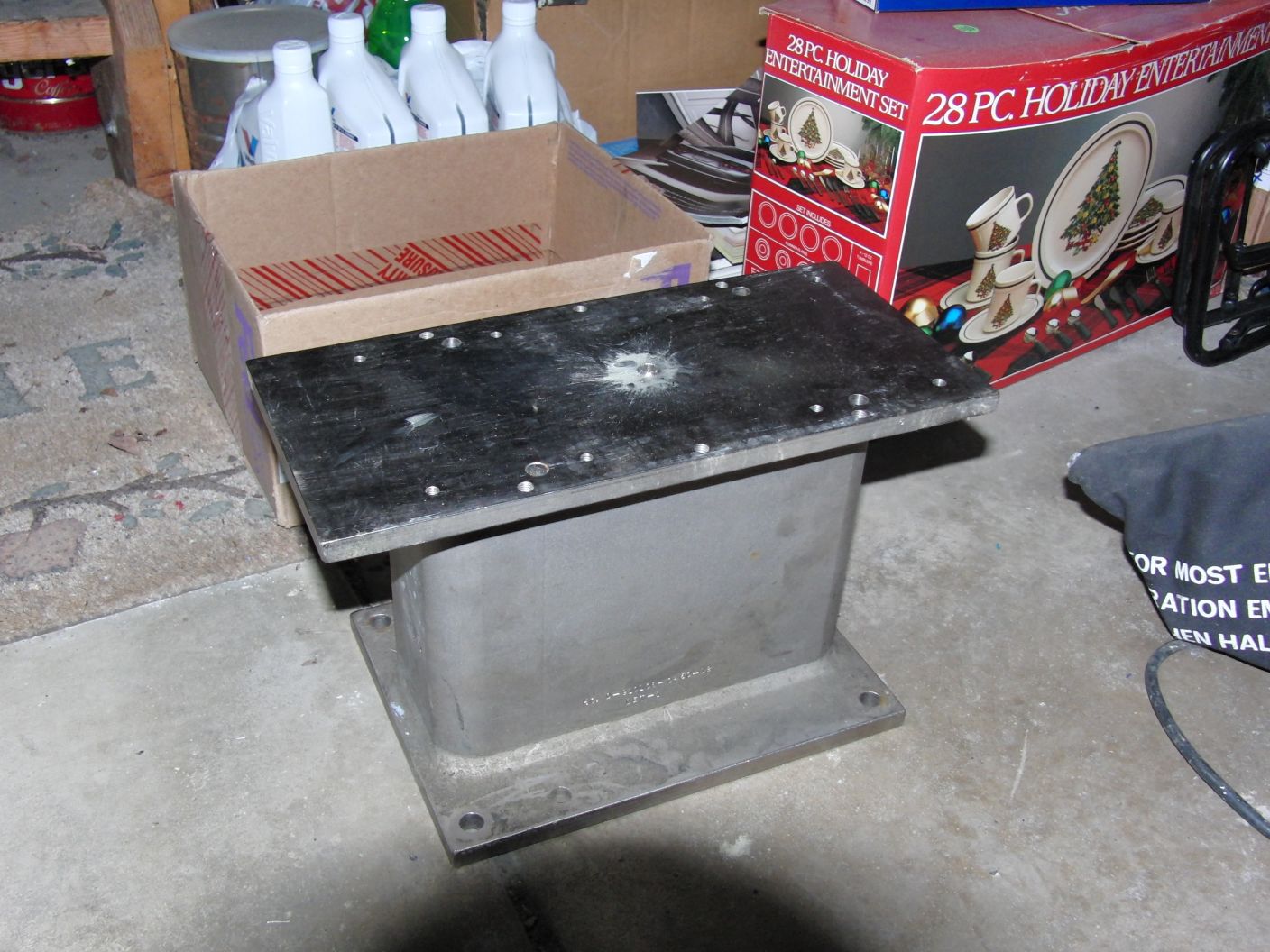

Today I dusted it off for an extra credit video for school. I ended up shooting a wanna-be APFSDS round at 1/2" steel plate.
Hardened O-1 drill rod
3/8" Dia,
5.84" long,
~15 degree tip.
It is interesting to note that the dart did not deform noticeably at all.
Enough talk; time for damage pics and 1200fps video:
hole again
hole again
hole
hole
target
target
dart in hole
dart in hole
dart
dart

Holy crap, that is beastly!

I take it that it was doing somewhere in the 200 m/s range?

Edit: yes, rag. HGDT puts it at around 650fps, but I have to leak some air out or it won't ignite for some reason.

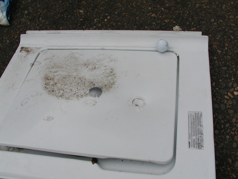

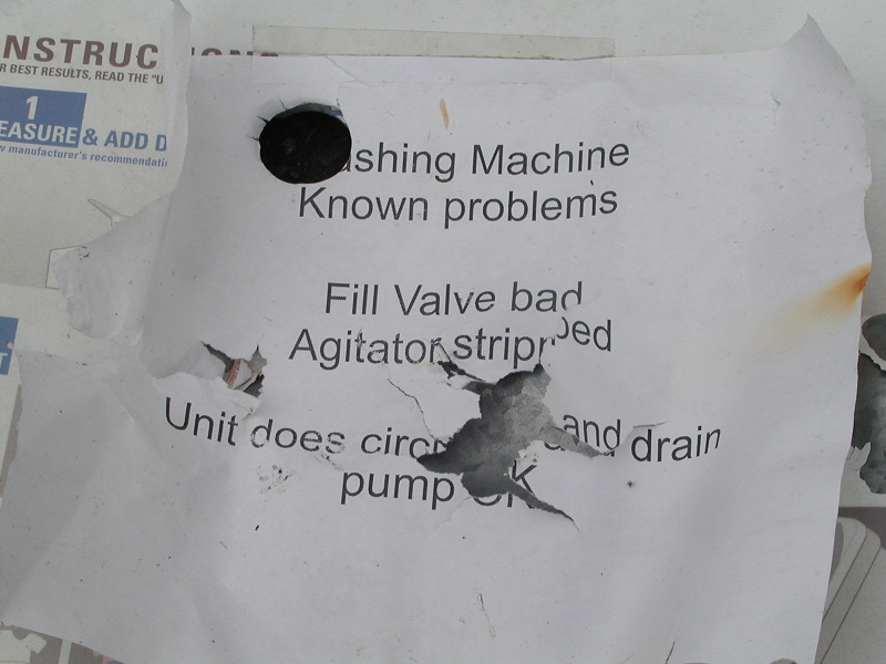

White goods, washing machine, refrigerator, etc. Pics below from the marshmallow cannon. (Not a Hybrid)
I used to know the mass. I took the weight of a bag of mini marshmallows and then counted them. Divided the weight by the quantity to find the weight if each. I don't remember the mass.
The edge of a piece of 1 inch electrical conduit makes a nice hole.
Dent in the lid and the projectile
