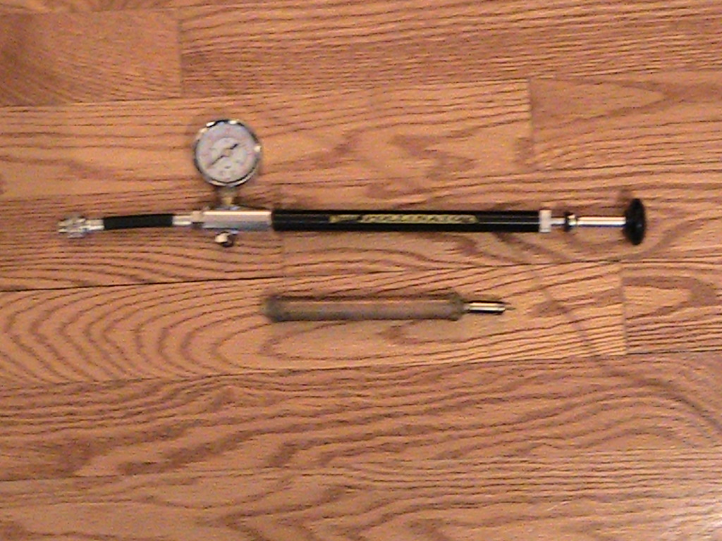

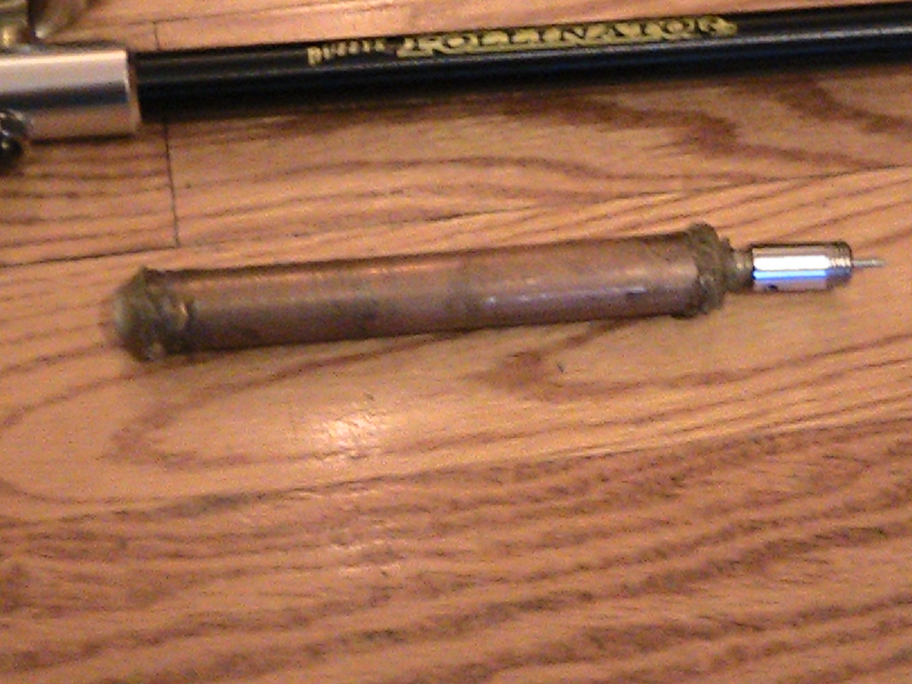

i havent made a mini in a very long time and i want to get into pen guns so i thought id start with a prototype.

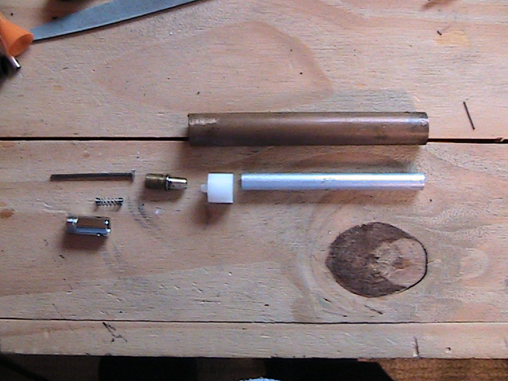

main tube 1/2 inch copper.
caliber 6mm

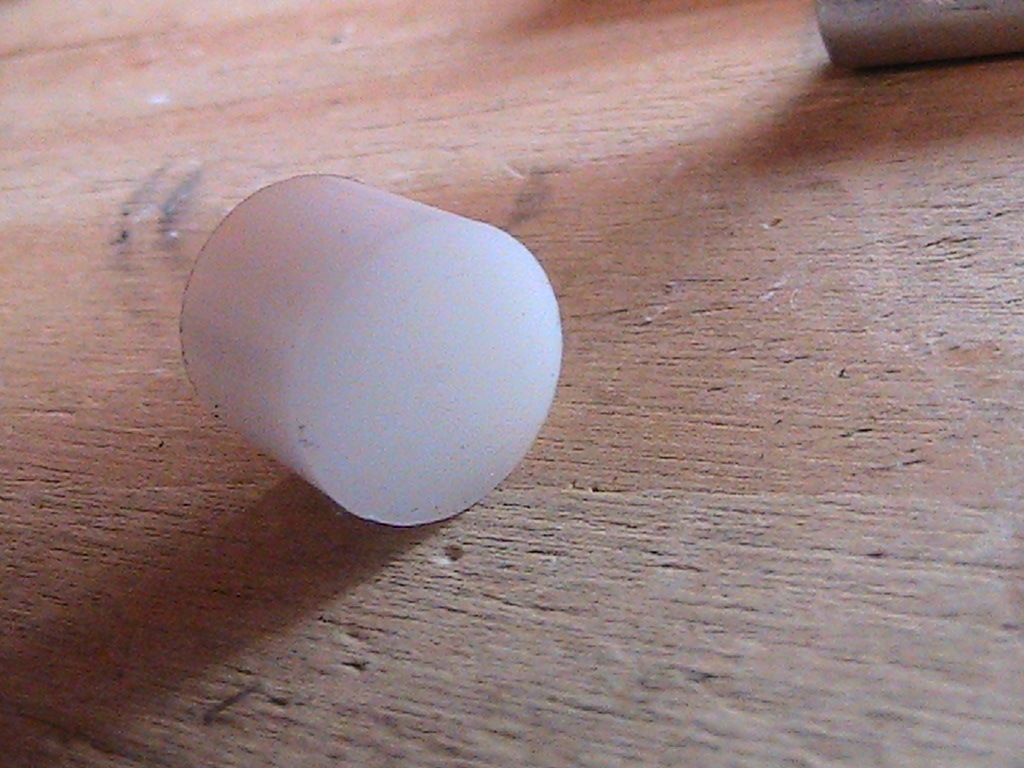

piston machined nylon

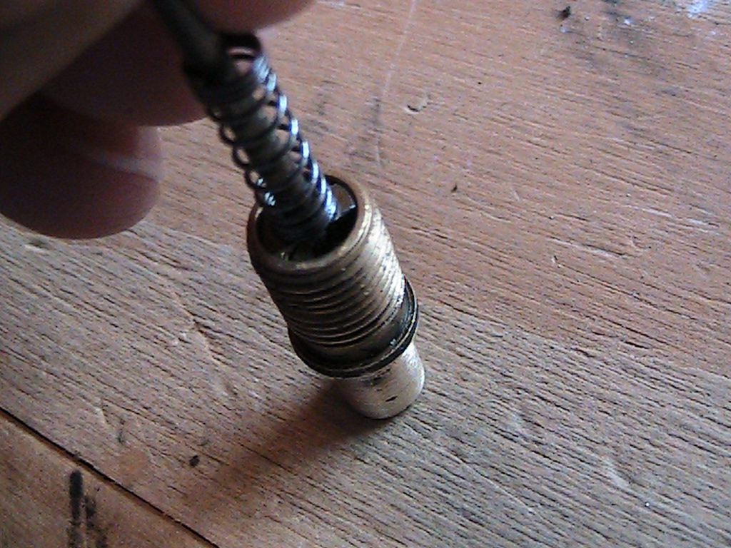

valve schrader
pressure 250psi

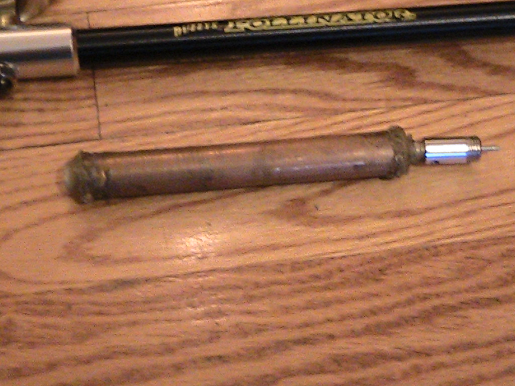

it works pretty well and sends bbs flying rather nicely. i used jsr's method of using a drill bit to keep the barrel centered while the epoxy cured. i hope to make a few brass pen guns with lighter machined nylon pistons
thanks
new mini

Made use of my trigger idea, I see
Looks good for a concept, I'm sure you can do a lot better.
Not a bad effort, did you put any rubber seals on the piston or is it just nylon against metal?

Nice effort
though it looks like you could trim that excess epoxy off and the copper itself is begging to be polished. Does the nylon seal leak at all?

its just the nylon and is leak free as i smoothed out the back of the barrel for a perfect fit.jackssmirkingrevenge wrote:Not a bad effort, did you put any rubber seals on the piston or is it just nylon against metal?

yeah i would do that but its just a protoype for smaller penguns. btw what is the best way to polish the copper?pneumaticcannons wrote:Nice effortthough it looks like you could trim that excess epoxy off and the copper itself is begging to be polished. Does the nylon seal leak at all?

You can use fine grit sandpaper...
