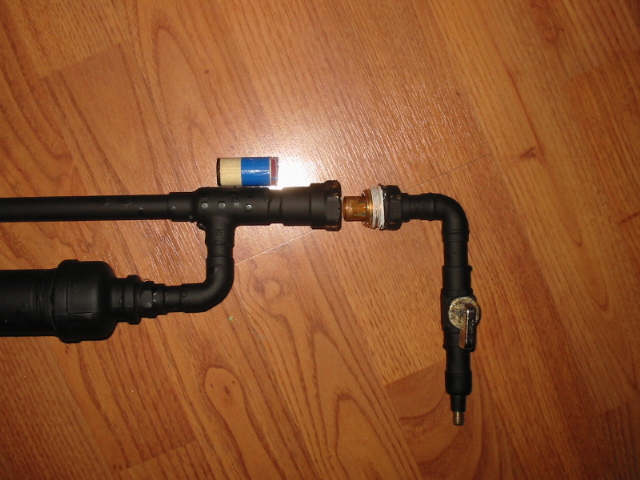

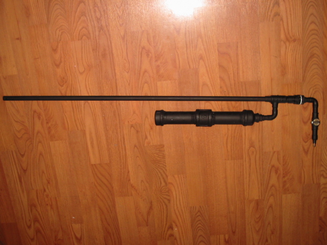

This is my copper rifle. I'm not going to go into detail on this post but if you have any questions you can post them here.

 Description:
The rifle valve setup.
 Filesize:  154.78 KB
 Viewed:  37 Time(s)

brogdenlaxmiddie
PostPosted: 03/02/2008 13:13 PM    Post subject: Reply with quote
Colonel
Colonel
Joined: 22 Jul 2007
Posts: 504
709.65 Spud Bux
I love the simplicity Cool
Back to top
bigbob12345
PostPosted: 03/02/2008 13:14 PM    Post subject: Reply with quote
Experienced n00b
Major General
Joined: 01 Dec 2007
Posts: 1516
370.57 Spud Bux
great gun
some specs would be nice.
Back to top

Thank you, I like to keep the cost down Very Happy .
Edit: Ask what specs you want and I'll give you them Smile .

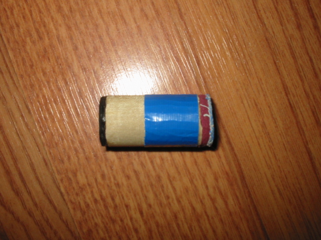

What did you make your piston and sealing face from?
Back to top
Sticky_Tape
PostPosted: 03/02/2008 14:54 PM    Post subject: Reply with quote
Brigadier General
Brigadier General
Joined: 31 Jan 2008
Posts: 900
1110.37 Spud Bux
The body of the piston is made from 3/4 inch poplar dowel and the sealing face is 2 layers of neoprene supper glued on there is exactly 1 layer of duct tape around the body of the piston and circle of foam on the back of the piston that is supper glued to the back of the piston with 7 layers of duct tape to protect the foam from rippage.
 Description:
Piston
 Filesize:  161.28 KB
 Viewed:  23 Time(s)

how far does your piston travel?
what is your pilot volume?
what type of valve are you using to pilot it?
and how does it work with the schrader valve?
why didn't you use epoxy for your piston?
what psi are you using?
and how far does it shoot?
what is your ammo?
Back to top

how far does your piston travel? : About 1 inch.
what is your pilot volume? :Unknown but small.
what type of valve are you using to pilot it?:1/2 inch mini ball-valve.
and how does it work with the schrader valve? :The shrader doesn't have the needle thing in it that makes it a check valve.
why didn't you use epoxy for your piston? :Wood was availible cheap and it was light while epoxy is a little pricey and heavier.
what psi are you using? :As high as my pump will go {160 psi max}.
and how far does it shoot? : Haven't done range shooting but I have big hopes for it to go about 500 feet.
what is your ammo?: Darts.

1" of piston travel seems quite large. if you went for the d/4 'rule' it should only have 3/16" travel, that extra 13/16" is extra pilot volume you have to vent. probably doesn't matter with the ball valve, but if you were to try a blowgun it might not work. nice effort any ways.
3/16" seems like the barrel wouldn't be open too much and why would people fuss about putting padding on the back of the piston doesn't seem like it would be able to accelerate too fast.
Far too much...
looks massive to me, if I were you I'd have the ball valve fitted before the bend.
Otherwise, looks great - how about some damage pics?

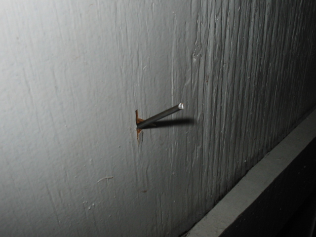

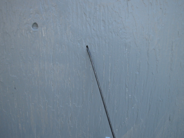

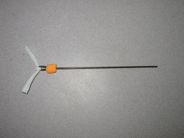

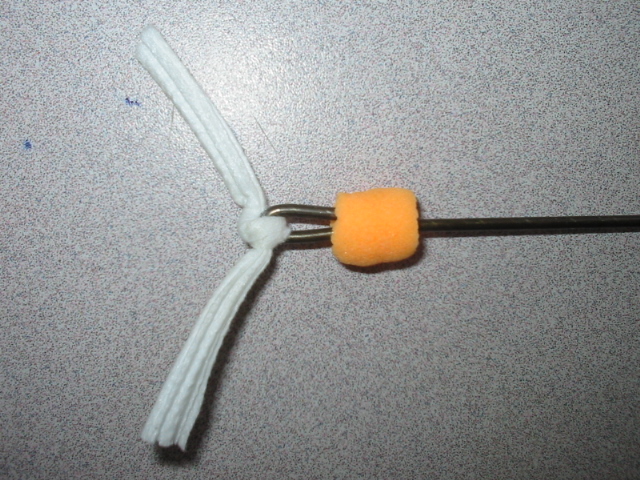

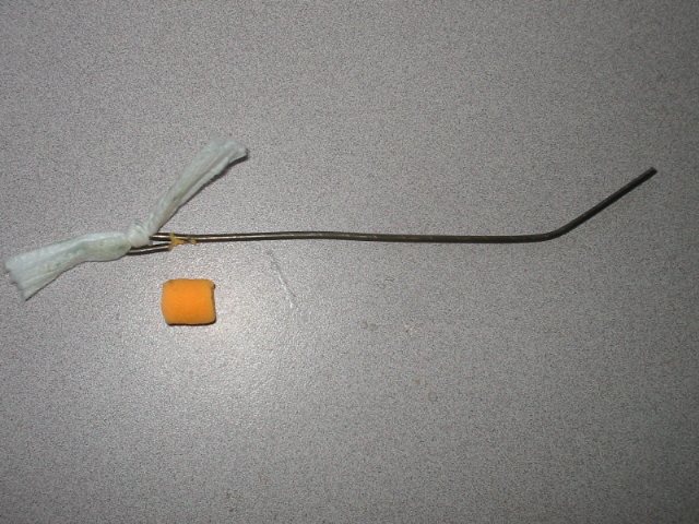

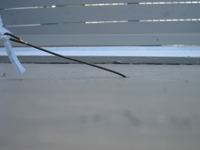

Here you are, this is a dart that I shot at my shed door.
 Description:
This is a dart that I made out of
wire coat hanger, an earplug, super glue, and the core of some cord.
 Filesize:  187.42 KB
 Viewed:  17 Time(s)
 Description:
This is the close up of the back of the dart.
 Filesize:  223.95 KB
 Viewed:  22 Time(s)

 Description:
This is the exit side.
 Filesize:  104.79 KB
 Viewed:  18 Time(s)
 Description:
The dart stuck in the door and bent.
 Filesize:  110.96 KB
 Viewed:  19 Time(s)
 Description:
This is the dart after fired.
 Filesize:  202.5 KB
 Viewed:  17 Time(s)
