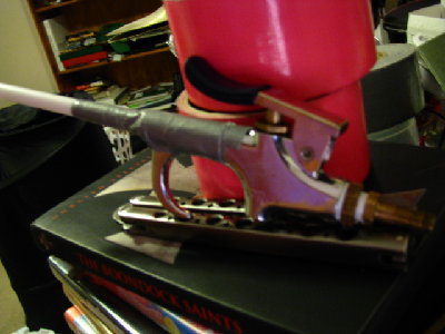

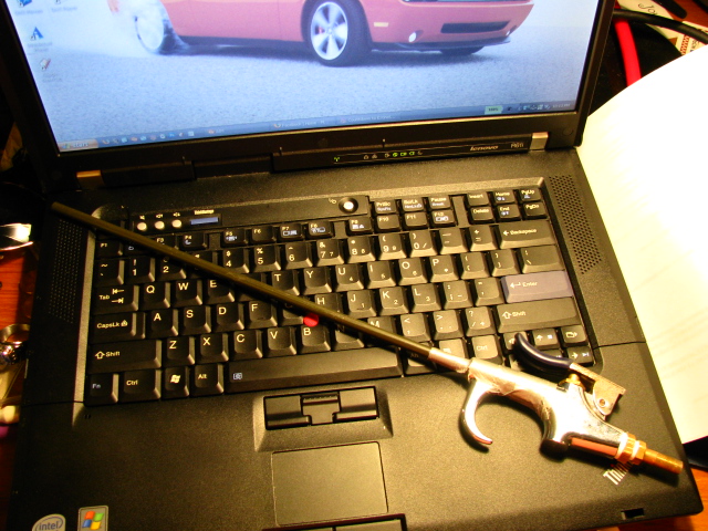

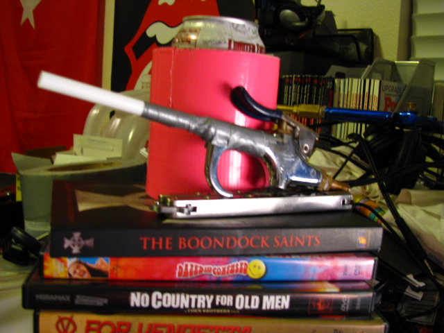

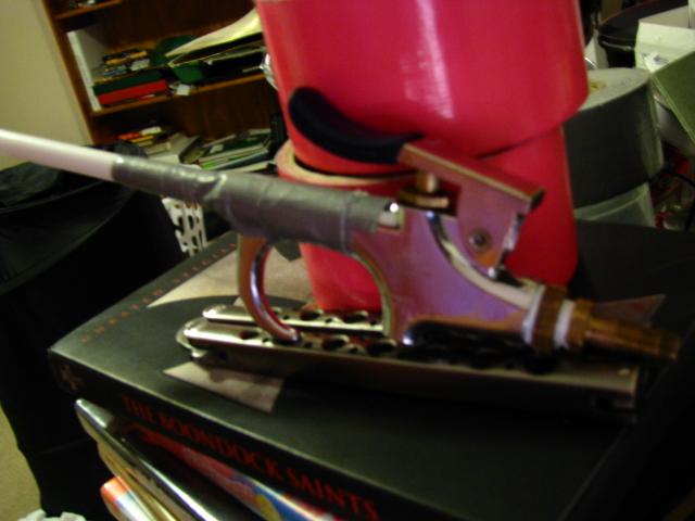

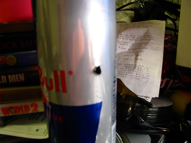

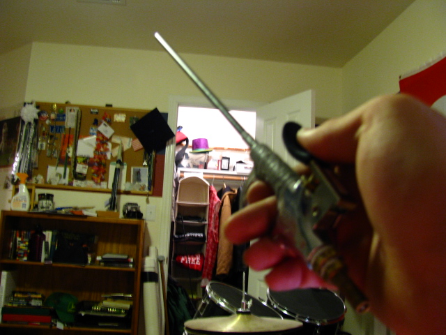

So today I was poking around my garage, and found a bin of small brass parts, a short length of 1/4" brakeline, and some blowguns. naturally, I decided to try and throw something together.
These were the results. One is a 4.5mm plinker and the other is a 6mm plinker.
Enjoy!

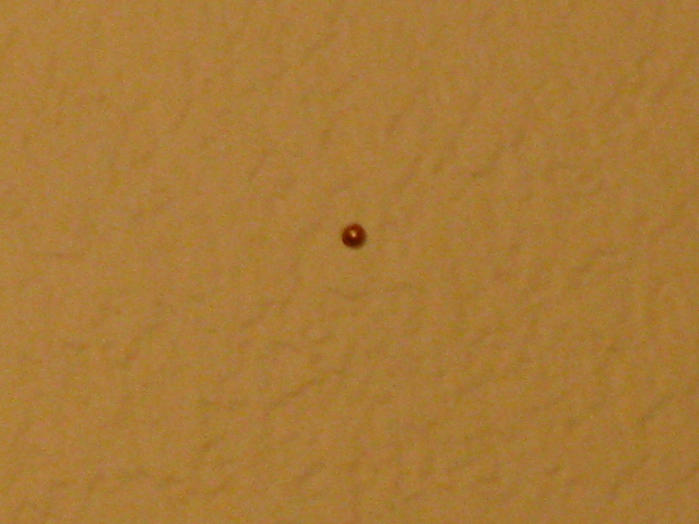

A 4.5mm bb penetrated this side of the can...
 Filesize:  169.19 KB
 Viewed:  7 Time(s)
 Description:
Continued through this side of the can...
 Filesize:  134.86 KB
 Viewed:  7 Time(s)
 Description:
And landed itself here... embedded in the wall in my room.
 Filesize:  141.76 KB
 Viewed:  6 Time(s)
 Description:
The plinker posing with some of my favorite movies ever.

Looks like some quick thrown together fun. Can I assume you're using a compressor connection for power? What psi are you shooting with?
Back to top
rednecktatertosser
PostPosted: 07/09/2008 22:12 PM    Post subject: Reply with quote
Colonel
Colonel
Joined: 22 May 2007
Posts: 601
451.78 Spud Bux
That it is my friend!
No, I'm actually using a shock pump that I bought awhile back and never had a use for. Pressure range is 200-350 psi.
the shot that stuck in my wall was at 350 psi.
Probably should have said that in the original post but oh well.

If you get a piece of lamp pipe (in lamp parts section of home depot), Or take apart a lamp, the pipe threads match the nozzle threads if your blow nozzle.
An ID 1/4" brass pipe fits snugly into the lamp pipe.
Also, the lamp pipe (OD 3/8") fits into 1/2" round stock pipe from the hardware section. And 1/2" copper T's fit the round stock for making magazines.
Also a 1/2" brass T can be drilled slightly with a 1/2" drill bit and will fit. Cool

Hmm... thank you! I have been trying to decide how to make it either breech loaded or magazine fed, and as soon as I get some money, Ill try that out!
