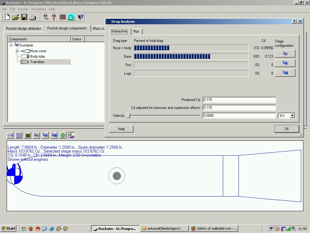

I've found this programme for designing and simulating rockets - http://www.apogeerockets.com/RockSim.asp
The programme has some functions that may be interesting for spudgunners:
+it allows to design a rocket from basic parts such as nose cone, main tube etc. and specify what material they are made of...
+ it calculates stablility of a given 'rocket' and its cd value
I think it might be useful for designing ammo... esspecially long range ammo
what do you think ?
BTW before you ask - I don't want to design ammo with a rocket engine strapped to it - I am talking about using this program to experiment with the shape of a projectile that gives the lowest cd possilbe and is stable in flight

you can download a trial version like I did....
EDIT
pic added - something tells me that you don't really get the idea of what I am talking about
it toke me 1 minute to design a projectile that has a cd of 0.179 and is drag stabilized (well at least according to this programme)

no you don't need to add engine to a rocket body to test its drag coeficient or stability... I am thinking of using the programme only for designing low drag ammo... hte rest can be done using the inbuilt balistic calculator in GGDT or any other programme

anyone has any idea how accurate is this programme ?
I've manged to design several types of ammo with drag coeficients as low as 0.1 so these things would be ideal for anyone who wants to shoot something over 1 mile

I've managed to create several designs of low drag drag stabilized ammo. According to GGDT I could increase the max range by a factor of 2.5 and more with these. If this does not sound good for you then what does ?
@D_hall now I understand what you meant when you said that cd value changes with speed and I realizied that spherical projectiles are not the best shape you can get.
