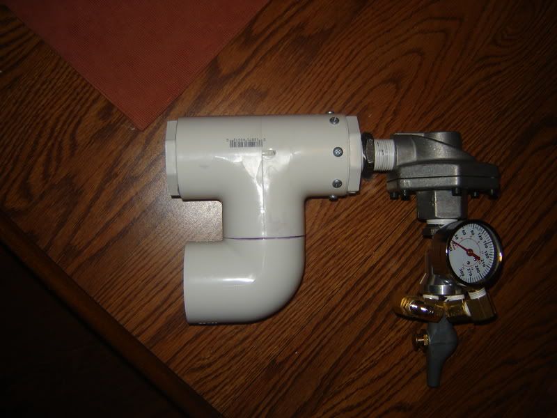

so this is the start to my new GB cannon. i cant wait to finish it but i have to go out of town tomm. so i decided to post what i have done so far.
Valve specs:
Porting - 1.5"
Tee - 2"
piston-1 1/4'' coupling
chamber-3''x3' sch40
barrel-4' GB barrel sch 80 &sdr21
when putting this valve together i took a lot of pics to post for everyone to see the workings. tell me what you think

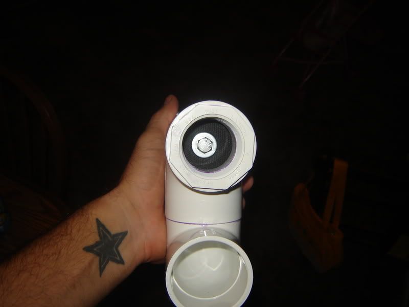

the back plug is a 2''x1'' bushing that i hit with the dremel
<a href="http://photobucket.com" target="_blank"><img src="http://i87.photobucket.com/albums/k154/ ... ure066.jpg" border="0" alt="Photo Sharing and Video Hosting at Photobucket"></a>

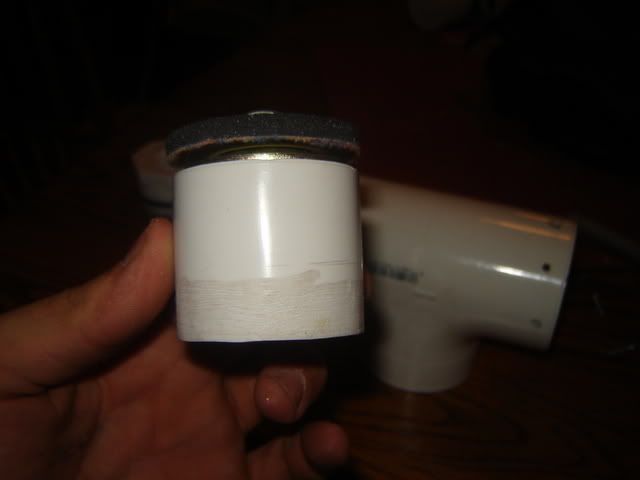

the sealing face 1 1/2'' reducer with a piece 1 1/4'' coupling in it
<a href="http://photobucket.com" target="_blank"><img src="http://i87.photobucket.com/albums/k154/ ... ure068.jpg" border="0" alt="Photo Sharing and Video Hosting at Photobucket"></a>

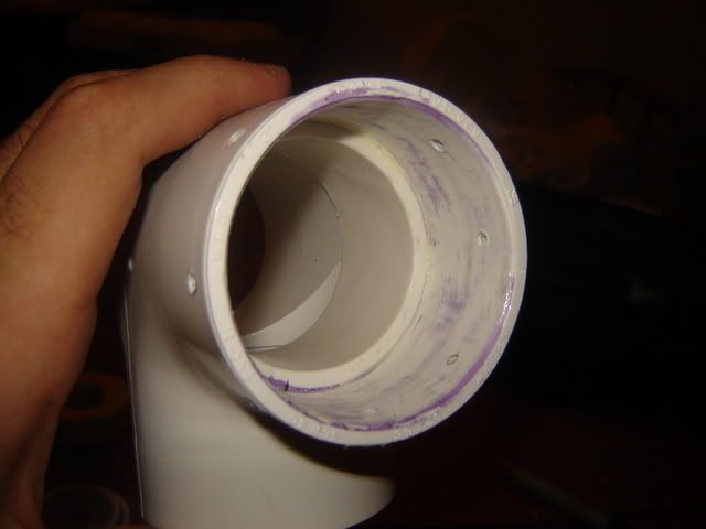

in side if the tee is a piece of 2'' sch40
<a href="http://photobucket.com" target="_blank"><img src="http://i87.photobucket.com/albums/k154/ ... ure070.jpg" border="0" alt="Photo Sharing and Video Hosting at Photobucket"></a>

Looks great. Answered a few of my questions about tee valves also!
How come you kept some threading on that bushing?

Could you throw in a picture of the Piston and the sealing face?Nice and neat looking,but why is there primer stains on in the Tee?Is that a pre loved/used Tee?

pvc- i wanted a close fit so the bolts could catch real good
rna-i put a pic of the piston in and the sealing face was in there 2nd from the top, and no the tee is new the primer is from when i put in the piece of 2'' pipe

Neato! Good idea with using some completed threads as an "O-ring groove". Looks like it turned out real good, (although the seal will reveal it's integrity when you finally pressurize it).

the piston moves back from the sealing face about 3/4in
i did grind down a groove for o-ring and the small part slides into the 2''pipe inside the tee and sandwiches the o-ring in place

its a mouse pad it worked nice up to about 80psi then it would leaks i made a new piston this one was just a little to heavy the new one is a pill bottle filled with foam and a rubber washer for the sealing face

The piston is filled with foam to eliminate pilot volume and to make the piston lighter. If it was solid PVC or something, it would be much heavier and would actuate slower. The sealing face is rubber, which won't leak (hopefully).
