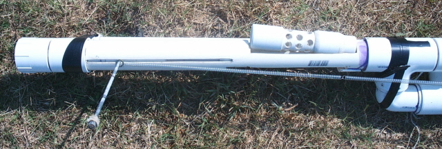

The Wookie gun in all its glory

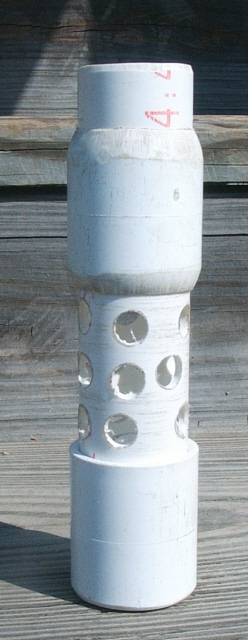

The 1.25cal cannon round which this gun fires; air goes through the case wall instead of the base, which is sealed of with a ¾” endcap Gooped in the hole.<br /><br />Special thanks to Jacksmirkingrevenge for the idea of the “through wall” case.

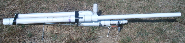

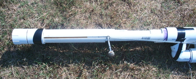

Another view of the full gun
Close up of the receiver.

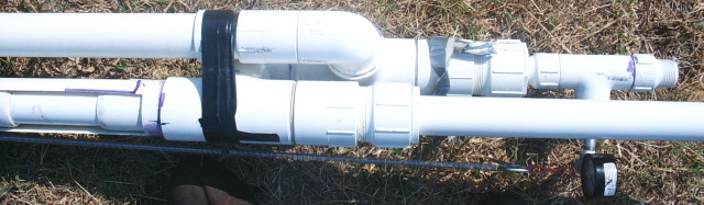

In the foreground of the picture is the mainspring.<br />Behind that is the valve assemble and the chamber (were the rounds go, not compressed air)

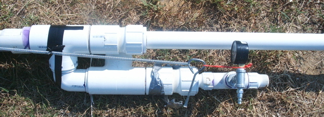

Pressure reservoir is at top, elbowed down to the valve, which is elbowed up to the chamber.<br />At the bottom of the picture you can just barley make out the main spring<br /><br />Sorry about me shoe, I edited most of it out…
Receiver with a round ready to go in the pipe, no pun intended.

How does it eject the casings? Sorry but I'm a very visual-type learner.

As for ejecting, the round is pushed back by the gas from firing and when it gets so far back it just drops, it’s that simple; I’m getting ready to go work on my prototype but if you need a visual I’ll work on it later, once it’s to hot to be out side.
