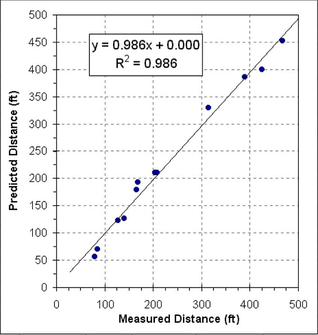

I've built the model for the cited data. Only four of the parameters are needed. The param's along with their contribution to the model are;
<table><tr><td>Parameter</td><td>incremental R^2</td><td>total R^2</td></tr><tr><td>Pressure</td><td>0.648</td><td>0.648</td></tr><tr><td>Air Vol.</td><td>0.229</td><td>0.877</td></tr><tr><td>Angle</td><td>0.0674</td><td>0.945</td></tr><tr><td>Wadding</td><td>0.0414</td><td>0.986</td></tr></table>
The R^2 values indicate how much of the spread in the distance the projectile flew is explained by the particular parameter (incremental R^2) and how much is explained by the parameter and the ones before it (total R^2).
So, pressure is the largest affect and accounts for 65% of the spread in the distances. Air volume is the second largest affect and accounts for 23% of the spread. These two parameters together account for 88% (total R^2) of the spread in the data. Launch angle is the next most important, it picks up another ~7% for a total accounting of ~95% of the data. The last parameter, the wadding, picks up a bit more but is probably down at the level of noise. With all four of the parameters 98.6% of the data is explained by the four parameters.
The model's equation that predictes the distance is;
Distance = (10.349)(Pressure) + (0.259)(Air Vol.) + (-4.444)(Angle) + (52.22)(Wadding) - 40.15
where;
Pressure in PSIG
Air Vol. in cubic inches
Angle in degrees (0deg = horizontal ?)
Wadding 1=paper, 2=cloth (non-parametric)
A graph of the predicted distance versus the actual distances is below;
As you can see, the model almost perfectly predicts the behavior of the cannons.
Unfortunately, the model is of no practical use for predicting the performance of guns that differ from the guns used to generate the data. This includes the inability to correctly model the affect of launch angles that are outside the 45 to 60 degree range. The model won't even correctly handle launch angles outside the 45-60 range for the same cannons.
