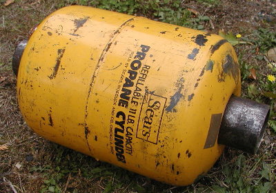

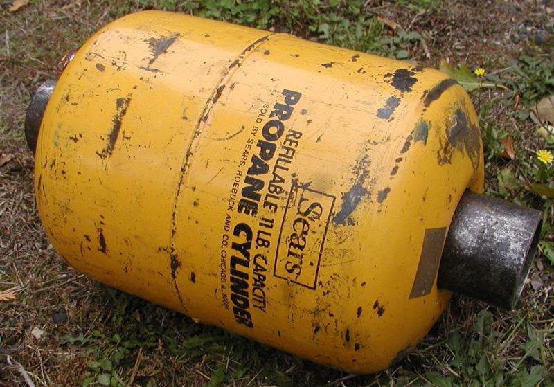

[img][img]http://i14.tinypic.com/6d1fg8x.jpg[/img]
You have to empty your tank so what i do is hook up a stove or torch fitting light it up and burn of the extra. There will still still be propane in the tank when you remove the Pressure relief valve but it won't be pressurized. To remove the Pressure Relief valve use the tool used to remove valve from bike tires. KEEP THE PRESSURE RELIEF VALVE YOU WILL REPLACE IT WHEN YOU ARE DONE. THe large valve in the middle is check you can just chuck itl.
Imagethe hole on the right is the valve you will be replacing. remove the large one in the middle in the same way
The next step is to wash the smelly gunk out of the tank. allow the inside to dry. now drill the hole in the middle to the size you require then tap for threads. next clean the cutting oil out and pour some paint in, make sure you dont get any on you new threads. swish the paint around coating the inside to prevent rust from the damp compressed air.
replace your pressure relief valve and your done now you have found use for that other wise useless tank.

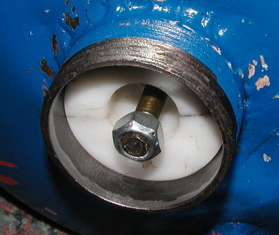

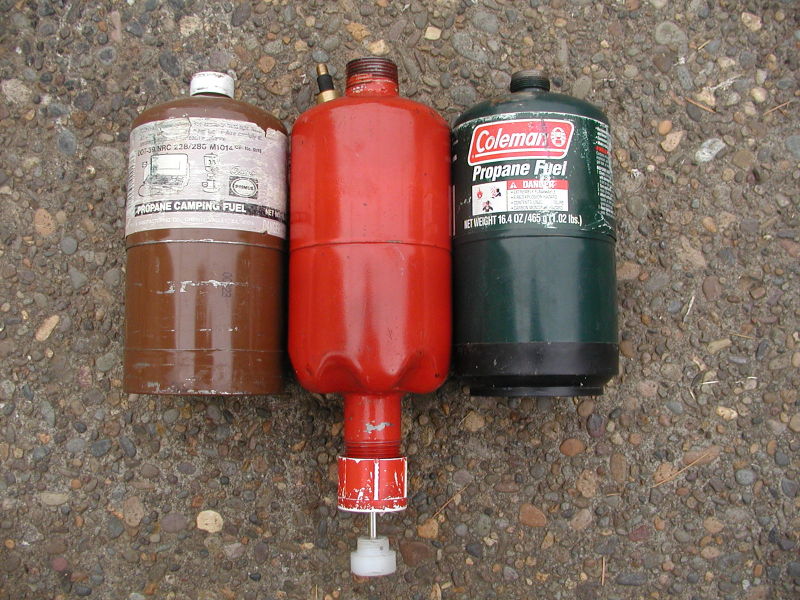

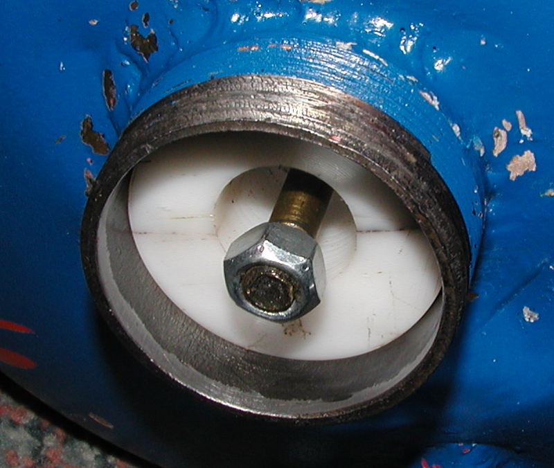

Unread postAuthor: Technician1002 » Wed Nov 04, 2009 4:05 pm
Big-mac wrote:its worth it instant chamber i plan on using a few on my revolver.
The opening into the cylinder under the valve in the neck is pretty tiny. They make a lousy chamber unless the hole is drilled out much larger. Most are too small to fit in the refill from a skinny ink pen. If you carefully remove the plastic sleeve and o ring, the bottom can be drilled out and the o ring and sleeve can be replaced to retain the original seal.
For my uses, I simply remove the undersized stock fitting and weld in something larger for more surge flow. :twisted:
2 unmodified tanks and one modified for better flow as a chamber.

Unread postAuthor: Mr.Sandman » Wed Nov 04, 2009 4:14 pm
Tech I SOO want that launcher. anyways I have used them as a chamber and all i can say is that i would rather use a c02 tank any day. The propane tanks require a good amount of modification to have an efficient flow.
