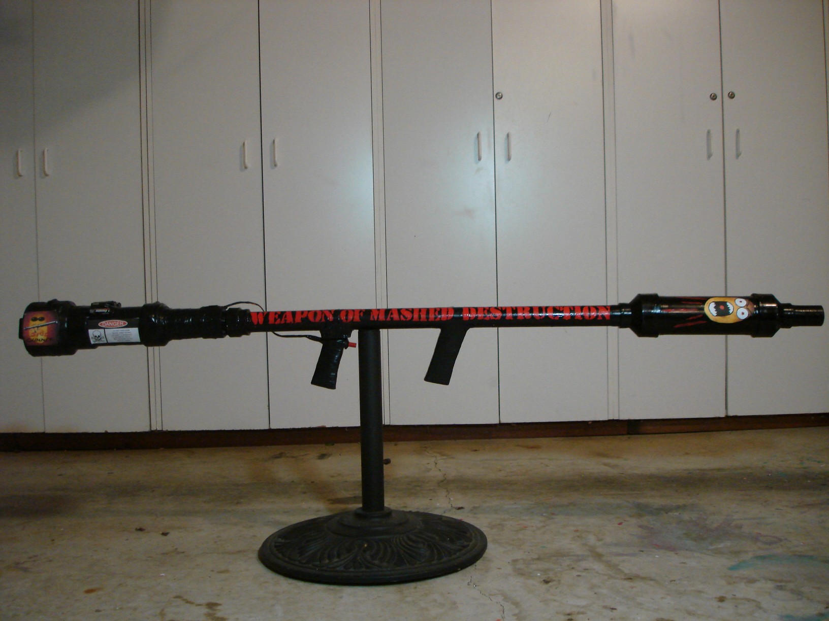

Set up the gun mount (turntable, umbrella holder, homemade, whatever) in the middle of a clear open space. I used the garage, and you can't see much junk in the background. Put your gun on the rotating mount, and set up your camera so that you can see the whole thing. Rotate the gun some more and make sure the whole gun is in the picture for the whole rotation. If you don't, you will be in trouble later on. If your gun refuses to balance, put a wight in either the chamber or barrel to even it out.
Turn on all the lights, and turn off the flash of the camera. Take a picture, and make sure it is not blurry or dark, and that you can see everything. Make sure the camera did not move. Now, get ready for the stop-motion photography. Get a piece of paper, and rip it into pieces. Set them up around the gun, like a clock. I used 16 pieces of paper. Make sure the pieces are spread evenly in a circle. These are the spots you will turn the gun to for each picture. (see the attachment)

Here is my setup. In the 360, I edited it so you could only see the gun, and not the background and floor. This is what you will get following my instructions. It is a lot harder to edit the pictures smaller and still line them up.
