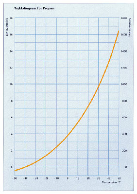

on like 20x mix in a hybrid why does not the propane become liquid?
does there have to be 100% propane under pressure to become in liquid state?
  • 0
liqufication (spelled horribly) pressure for propane

The figure that matters is the partial pressure. This is basically the total pressure times the percentage of the gas mix that is element X. You should work in absolute pressure for these purposes.
For example, the partial pressure of nitrogen in air is ~11.5 psia.
Oxygen would be ~3.1 psia.
Argon and other trace elements make up the remaining ~0.2 psia.
The sum of the partial pressures in a gas will always be equal to the total pressure of the gas mixture.
Basically, in the case of propane, it needs to reach a given density to start to liquefy. In a hybrid, the density of propane is low, being interspersed with the elements of air, so propane wouldn't start to liquefy until around very high mixes.
