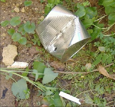

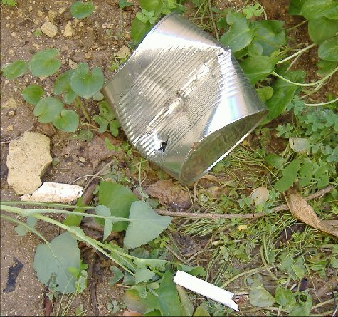

This was shot at about 55psi. from 1/2in. pvc

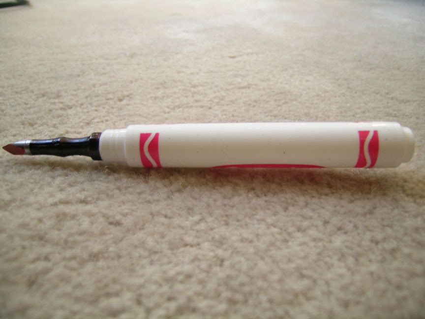

The dart
An old arrowhead

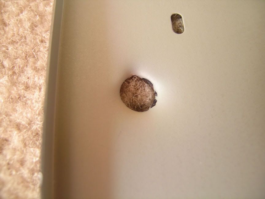

Damage, front
back
My first dart :cry:

Unread postAuthor: NewB » Wed Sep 19, 2007 6:33 pm
It is a sheet of metal I found in an old computer keyboard.
  • 0

Unread postAuthor: jimmy101 » Thu Sep 20, 2007 9:53 am
Very nice. That's darn good damage for such a small gun. And a ball valve to boot.
I wonder if that marker body would work better if the butt was cutoff? It would remove some of the weight from the butt of the shell making it more aerodynamiclly stable. It might also let the body of the marker expand and better seal the barrel when fired.
Hey, take the big fragment of the marker body and a heavy gauge nail. Heat the nail up and shove it into the open end of the marker body until it's tip melts it way through the "butt" of the marker body. You now have another shell with an open butt end and a cheapo steel tip.
(note to self: start collecting old crayola marker bodies)
