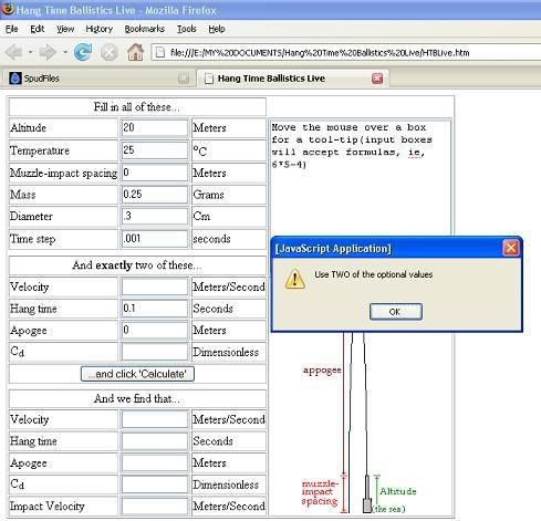

Unread postAuthor: Carlman » Sat Dec 15, 2007 8:10 am
is this a bug or what? I think i entered everything correctly.
EDIT: i found you cannot have zero for the apogee, but what happens if you are shooting from like 1m away? do u put it as 0.0001?

Unread postAuthor: ALIHISGREAT » Sat Dec 15, 2007 8:29 am
aww there is graph, and it doesn't show up on mine :(
and you can't enter an apogee of 0, it has to be above.

Unread postAuthor: Hubb » Sat Dec 15, 2007 8:36 am
The reason the apogee can't be zero is because the projectile is bound to travel some type of distance upward.

Unread postAuthor: jimmy101 » Sat Dec 15, 2007 2:31 pm
Boiling; looks good, you are getting pretty good at these embedded calculations.
Now, along the lines of asking a program to do something that it was not designed to do...
If you set the "Muzzle-impact spacing" to a large number like 100 meters. Then set the muzzle velocity to a very small number (like 0.1 m/s) and use a Cd of 1 ...
It says the object hits the ground at ~0.1 m/s.
I don't think that's right :D
Basically, I was trying to model a projectile dropped from a particular height.
The model assumes the gun is pointing straight up, so you might want to note that on the page somewhere.
Be nice if launch angle and range were also input/output.
I suspect the reason why the apogee (and some of the other variables) can't be zero has little to do with the math. Boiling is using a cell containg zero (or null, or empty) to decide which things are inputs and which things need to be calculated.
<pre> //Determine which algorithm to use
if (InCd > "0" && InVel > "0") { CdVel() }</pre>

Unread postAuthor: boilingleadbath » Sat Dec 15, 2007 7:38 pm
Ok, people asked for the ability to use the programs for other than strait-up launching.
I simply take the sine of the angle you enter and multiply it by the velocity: this calculates the vertical component of your velocity.
The vertical component of your velocity is then used in the calculations, completely ignoring the horizontal speed.
I think I can do this. Johanna, you wanna comment on this?
Yeah, the entered values in the "optional" section have to be above 0... which, as jimmy noted, is because the program doesn't realize you have entered anything if it is zero.
No, no graph... just a helper diagram (in the spirit of the picture in EVBEC Live)
It should work so long as you keep the picture ("helper.png", I believe) in the same folder as the html document.
Speaking of the diagram, I think a slight error in it caused Jimmy's problem: a muzzle-impact spacing of 100 means that the projectile's flight ended at a point 100 meters above the muzzle. Or when the projectile nosed over.
(the simulation ends when the projectile is under the impact point AND it is moving in a downwards direction)
So, Jimmy, simply enter a value of -100 meters if you want to simulate dropping a tater out of a building.
Oh, and the issue with the apogee tool-tip? Fixed that.
I had an apostrophe in the quote, so it wouldn't display, that's all...

Unread postAuthor: jimmy101 » Sun Dec 16, 2007 12:52 pm
Yep, exactly correct. BTW, if you use the sine then straight up is a 90&deg; launch angle.
But it looks like you can fool it buy just entering a very small value, like 0.0001m/s for the muzzle velocity.
Tried the "-100" trick for the "Muzzle-impact spacing" value. Works like you said. I probably should have read the mouse-over description. I figured that distance was to take into account the height of the muzzle above the ground. So a 6' value would mean that the muzzle was 6' above the ground. Looks like you need to enter -6'.
If you use larger and larger magnitude negative numbers of the "Muzzle-impact spacing" you can estimate the terminal velocity from the mass, diameter and Cd of the ammo.
Now, what would be the velocity at ground level of a 0.38 cal pistol fired straight up. Would it be dangerous? Since the calc. probably won't properly handle a supersonic round you would probably need to model it as if the round was just dropped from a great height. Just need the mass, diameter and Cd of a 0.38 (and assuming it doesn't tumble).
Lets see, assume mass=130gr=8.4g, D=0.38"=0.965cm, Cd=0.3
Velocity at -1000 ft = 77m/s
Velocity at -10,000 ft = 79m/s
So it looks like a terminal velocity of ~79m/s, ~260 FPS.
Roughly 1~2% the KE the bullet had when it left the barrel.
I wonder how fast a person can throw a 0.38 slug?
