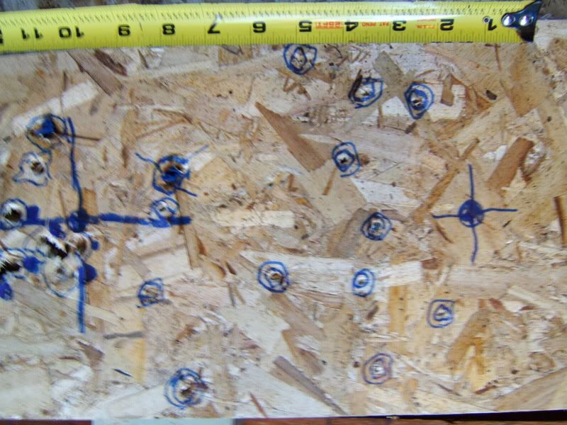

Thought you guys might find this interesting. The accuracy of the lead ball seams to be way better. In the pic you will see lots of holes, the ones with a blue dot next to them are the lead balls, the others were marble slingshot ammo. Both were muzzle loaded with a greased patch and shot with this cannonhttp://www.spudfiles.com/forums/ongoing-progress-update-pictures-small-video-added-t13286.html
I was using it at low pressure, between 110psi and 130psi, as the compressor drained and refilled. Obviously I would have gained accuracy if I had made sure the pressure was always exactly the same.
Also, I replaced the scope with regular sights, because I wasn't sure if I was trusting the scope, but now I do. I will probably be putting the scope back on.
I'm thinking that I would probably have had more accuracy at 350-400 psi, but that would have been alot of pumping.
The shots were all taken at 25 feet. I thought I would get better accuracy, I guess the fact that it is smooth bore has more effect than I thought it would. Especially at such short distances.
I was using a chair as a rest so I'm pretty sure my aim was very close to the same every time, as I can get inch groups at 50 yards with my 22.
Also I should say that I wasn't trying to hit the bulls eye, I was only using it as some thing to aim at for shot to shot accuracy. obviously it needs to be adjusted.

Unread postAuthor: Sticky_Tape » Sun May 04, 2008 7:36 pm
More weight would probably make the projectile keep more consistent trajectory and be less susceptible to bullet drop. This would also make it less susceptible to wind currents due to more momentum. Here is somthing to try stand 20' from a target throw a foam ball and throw and tennis ball and see which is more likly to hit the target. Sence the tennis ball is heavier it keeps better trajectory and is less susceptible to wind currents. Just somthing to have brain farts about.

Unread postAuthor: lockmanslammin » Sun May 04, 2008 7:50 pm
Sticky tape, I was thinking the same thing. The extra weight really helps out.

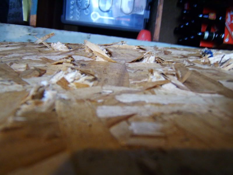

Here is something else you guys might find interesting. I used a plastic sabot and dropped about 10 or twelve .177 lead pellets down the barrel and put a piece of foam on top to keep them in the barrel. Pumped it up to 300psi and shot it at a piece of 1/4" osb from 25 feet away. The first picture is the front and I drew double circles around the pellet holes.
The second picture is the back of the osb.

Unread postAuthor: Ragnarok » Sun May 04, 2008 7:54 pm
Sticky_Tape wrote:More weight would probably make the projectile keep more consistent trajectory and be less susceptible to bullet drop.
Less susceptible to bullet drop? Unless you've developed material that is shielded from gravity, everything is equally susceptible to it.
However, the lower velocity of a lead ball would actually mean the drop would be higher. More time to target, more bullet drop.
At 25 ft, wind is seldom a problem. My own guess is that the higher weight of the lead balls mean that they are less likely to pick up spin from the muzzle blast or have their initial trajectory affected by the same.
I find that in a spudgun, the muzzle blast is the main source of inaccuracy at short ranges. Barrel whip is also something of a problem, particularly in PVC. The problem with the muzzle blast is why air strippers around the muzzle are a wise investment of effort into a cannon where accuracy is fairly key.
One of my cannons had a serious problem with putting spin on the projectiles, and often this would mean spud slugs would go less than about 50 yards because of the extreme drag.
After I added an air stripper... well, I almost thought I had forgotten to load the cannon, because the spud - now flying straight - moved so fast it could barely be seen in the air.
The results spoke for themselves. It's well worth trying if you want more accuracy - the only real expense is a little more length on the end for the porting/air stripper.

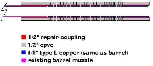

Unread postAuthor: lockmanslammin » Tue May 06, 2008 1:49 pm
Poland, I was kinda thinkin' the same thing, except with crosses/4 ways, and then cutting them off at backward angles, just for looks. But I think I would rather try and find a thicker kind of pipe that will slide over the end of the barrel nicely and drill a nice pattern of holes all around it.........
Never mind I just got back from ace. I found the parts I will use. 1/2" cpvc 4120 fits perfectly over a 1/2" x 12" copper repair coupling. This way It will slide onto the end of the barrel, there by not reducing effective barrel length. I will solder a piece of 1/2" partway into the repair coupling glue the cpvc over the repair coupling(to add thickness for looks) and drill my hole pattern. Then paint it black. Wadduyu think?

Unread postAuthor: lockmanslammin » Fri May 09, 2008 2:06 am
Alright, I finished the air stripper/ muzzle break. Tomorrow I hope to shoot some groups to see how well it preforms. Also I will try and do a little mspaint drawing of how it is made and post a pic of the actual thing as well. I wish I could test shoot it tonight , but my landlord/ downstairs neighbor is parked on the other side of the garage right in the , hehe, shooting range, so I can't.

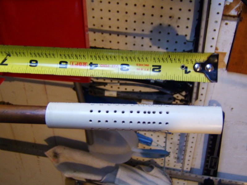

Unread postAuthor: lockmanslammin » Fri May 09, 2008 11:55 am
Well, no such luck on the test shooting this morning, he is still parked in the way.
I did take a couple pics and make a (not to scale) drawing for you though.
The whole thing at this point is just pushed onto the end of the cannon so it is still removable. The plastic is a tight friction fit over the coupling and the two copper parts inside are soldered together. The holes were spaced by eye so they aren't super accurate, but good enough for me. They are pretty much pilot holes at this point I may enlarge some after testing, that is why no paint job yet. There are 8 rows of holes.
Here are the pics,

Unread postAuthor: Ragnarok » Fri May 09, 2008 12:36 pm
That looks pretty good.
You might find you need larger holes to get the optimum results, but that should help your accuracy noticeably anyway.

Unread postAuthor: POLAND_SPUD » Fri May 09, 2008 1:12 pm
looks good... you can easily upgrade it into a silencer if you want to

Unread postAuthor: JDP12 » Fri May 09, 2008 1:13 pm
yea that's true, i say make the holes a bit bigger, but its your gun
