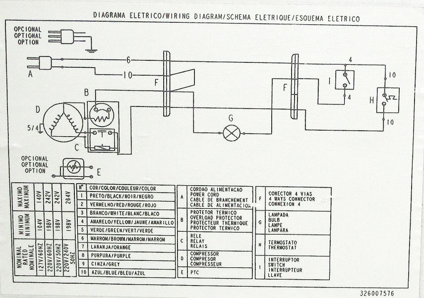

lose the control board and manually wire it up....
here is a basic diagram on how to wire one of these up
  • 0

Heimo wrote:lose the control board and manually wire it up....
Looks good, I have to clarify a few things though.
What is the overload protector? Is there one on the circuit board that I can remove? And same question for the relay basically i.e. Do you see one on the circuit board I can remove?
Also the voltage is 220-240v/50hz and 1.3A current, so is it good to go straight from the wall plug?

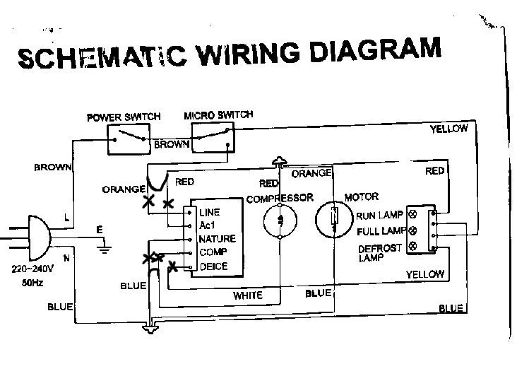

Unread postAuthor: jimmy101 » Sun Aug 15, 2010 4:09 pm
Looks like the circuit board is just a timer, nothing that looks like a power supply or anything like that. So you should be able to just omit the circuit board completely. Also omit the micro switch.
Looks to me like the brown wire from the main switch goes to the red wire of the compressor. The white wire on the compressor goes to the blue wire of the power plug.
Does the compressor label say 240V?
  • 0

Unread postAuthor: Matt_NZ » Sun Aug 15, 2010 4:22 pm
jimmy101 wrote:Looks like the circuit board is just a timer, nothing that looks like a power supply or anything like that. So you should be able to just omit the circuit board completely. Also omit the micro switch.
It says 220-240v ~50hz :o

Unread postAuthor: al-xg » Sun Aug 15, 2010 4:25 pm
Yep thats it, red, white comming from the relay and earth is all you need.

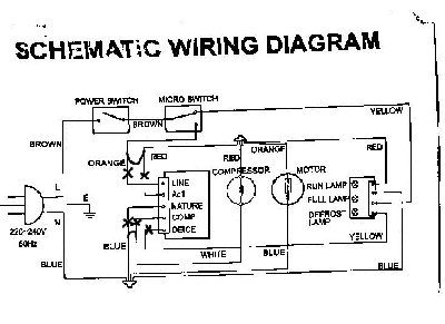

To make it simple, I modified your wire diagram. The de-ice is a timer to shut off the compressor to defrost it on a regular cycle. Remove the board and tie the wires together as shown. This will connect power directly to the compressor without the timer.
  • 0

Technician1002 wrote:To make it simple, I modified your wire diagram. The de-ice is a timer to shut off the compressor to defrost it on a regular cycle. Remove the board and tie the wires together as shown. This will connect power directly to the compressor without the timer.
Thanks, Techician. That will come in handy.
