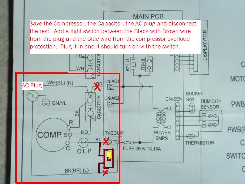

The old dehumidifier was just released to me for deconstruction and use for parts. I think I understand what I'm looking at, but I'd like somebody with a little more experience to tell me what I need to keep to operate the compressor, and what I can toss out. I believe I've identified the compressor, and the converter from a US wall outlet to whatever the compressor requires to run, but I'm lost as to the purpose of the brown wire... is an on/off switch connection to the control panel?

The Capacitor is too big to be a run cap for the fan, so I assume it is a run or start run cap for the compressor. The printer circuit board is the cycle timer and logic to defrost it to prevent it from building a layer of ice. It also prevents trying to start against high head pressure by providing a delayed start.
You will need to retain the capacitor. The timer board functions can be replaced with a switch.
If you can get a good macro photo of the cap label, I could tell if it is a start cap or a run/start cap. A start cap would have only one section and the label would list only one MFD value. A run/start cap will have 2 sections with two MFD values. and 3 connections on top. Before disconnecting the cap or compressor, note which wires from the cap connect directly to the compressor. You will want to retain this exact configuration. Drawing it out with the wire colors would be a help.
A run/start configuration is like this. A sealed compressor would use a start relay instead of a centrifugal switch.
A run cap configuration is like this;

Unread postAuthor: saefroch » Sun May 15, 2011 7:35 pm
The only wires going in and out of capacitor are the direct connections to a wall outlet plug, with the white connected and the green grounded. There are then the black and red which connect directly to the compressor, the compressor is grounded to the casing, but there is still the brown wire, whose function is as yet unknown to me...
All that aside, are you suggesting I just find the correct configuration to wire the control panel together in one "master switch" and bypass all the control options, and leave all the other control functions intact?
Pictures added to original post for clarification.
Quite frankly, I know most of this is way over my head, since I'm not used to dealing with circuits this complex, and I've never done anything with some AC circuit elements. I'd appreciate newbie-level explanations in this :roll:.

Unread postAuthor: Technician1002 » Sun May 15, 2011 8:03 pm
I'll edit up the diagram to show what to keep later. The included diagram is great. The cap is a single section run cap that is next to the Compressor marked COMP on the diagram. It shows the red and black wires. They are abbreviated RD and BK on the diagram.

Unread postAuthor: saefroch » Sun May 15, 2011 8:23 pm
Ohhhhhh by "cap" you mean capacitor. I think I can relate that small part of the diagram to the actual device, but I don't know what to actually DO to be able to liberate the compressor and equip it with a simple on/off switch...

Unread postAuthor: Technician1002 » Mon May 16, 2011 12:04 am
Here is the modification. The compressor, capacitor, and power cord is removed from the cabinet. You don't need the printed circuit board. A relay on the printed circuit board is replaced by a light switch as shown in the diagram. The diagram shows there is a smaller capacitor used for the fan. If you keep the fan for another project you will need to save the capacitor for the fan. The fan capacitor is the black rectangular one with the yellow and white wires attached.
The capacitor even though shown rectangular in the diagram, it is the round item you took a photo of.
