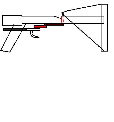

Have any of you made a crossbow not using rubber bands or anything like that.
I mean a crossbow that actually uses a wooden bow to shoot things
I mostly looking for an easy triggering system
If you have made a crossbow would you be able to post some pics
Im in the process of making a mini crossbow ive made the bow :)
If you can help it would be great

a triggering system that you could use could be heavy gage wire possibly a coat hanger (depending on how heavy the load the bow produces) in the shape of an "s" where the "s" is tilted to the left to lay on its side and bottom part of the s extends straight out for the trigger and the top part of the "s" acts to hold the bow string. the lower half where the lower loop occurs is where the mechanism is turned about an axis. the tension of the bowstring acually makes the mechanism hold until you squeeze the elongates bottom of the "s" rotating the whole mechanism about its axis releasing the bowstring. this was very difficult to type however i hope you can understand it or that at least it sends you in the right direction.

Unread postAuthor: Pyro Ninja » Wed Dec 06, 2006 2:42 am
I understand
but i dont know how i would attach it to the stock

in the stock where the bow is at full tencion make a notch then put a hole down to were the trigger should be then make a trigger so when it is pulled back when u pull the trigger it lifts the string over the notch

My friend used a door knob. The handle was the trigger and the actual metal part that would go into a door frame held back the string until the handle was turned.

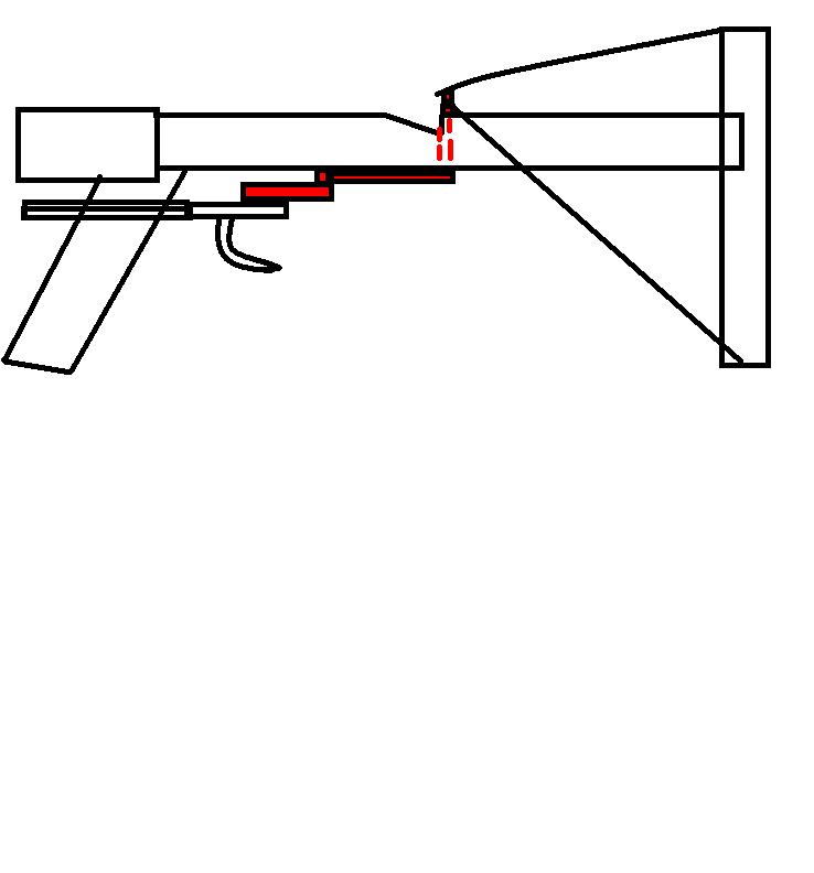

Unread postAuthor: King_TaTer » Wed Dec 06, 2006 7:10 pm
i have some ideas. there to hard to explain (well for me) but here are some pictures. you may be able to mod them to your liking

Unread postAuthor: Pyro Ninja » Thu Dec 07, 2006 2:41 am
Thanks king_Tater their good designs
I might use the first one if i dont see any better ones :)
