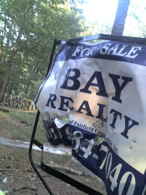

These were from shooting table legs wrapped in ducktape at a metal sign, and also a d size battery.

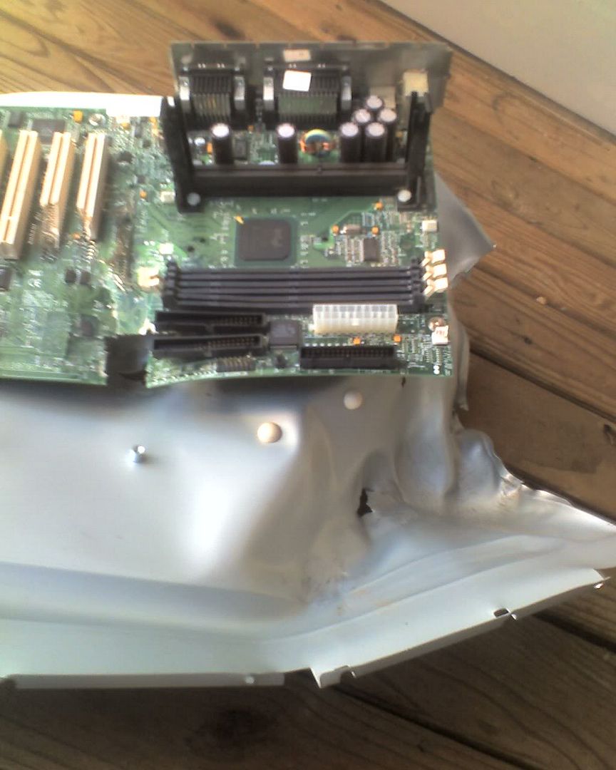

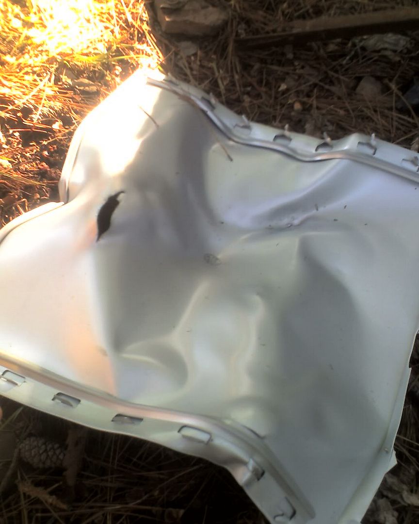

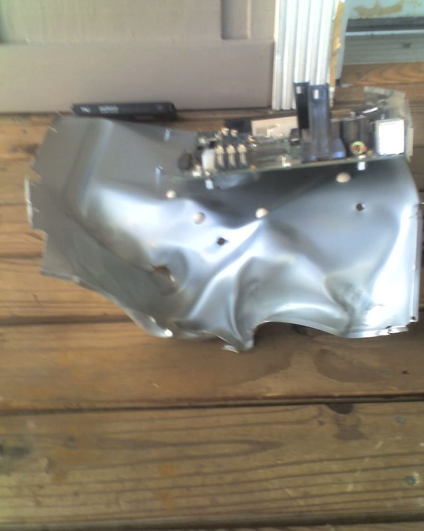

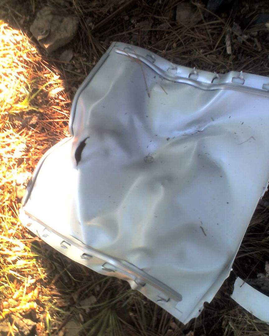

UPDATE:
I took some pics of the computer i shot and here they are, also a new video but i set the backspin too high so it hit the trees on the other side not the water like i intended.
The metal plate with the circuit board on it was attatched to the other metal plate, i shot them from both sides.
NOTE: The quality if the vid isnt so good because i took it with my phone

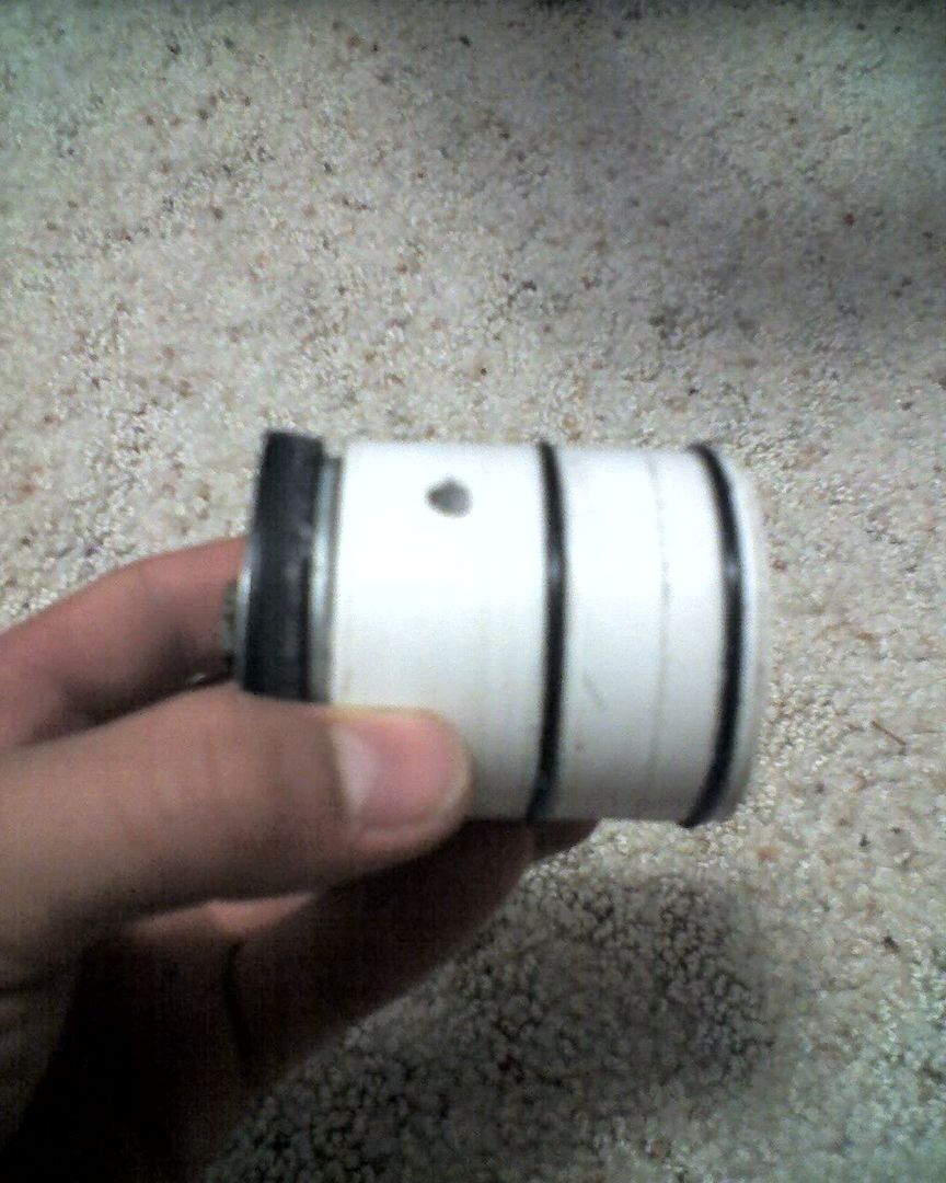

Unread postAuthor: e1337 » Mon Sep 10, 2007 8:59 pm
Very nice work, Did you lathe the o-ring groves?
And what is the piston made from?
Peace,
E1337

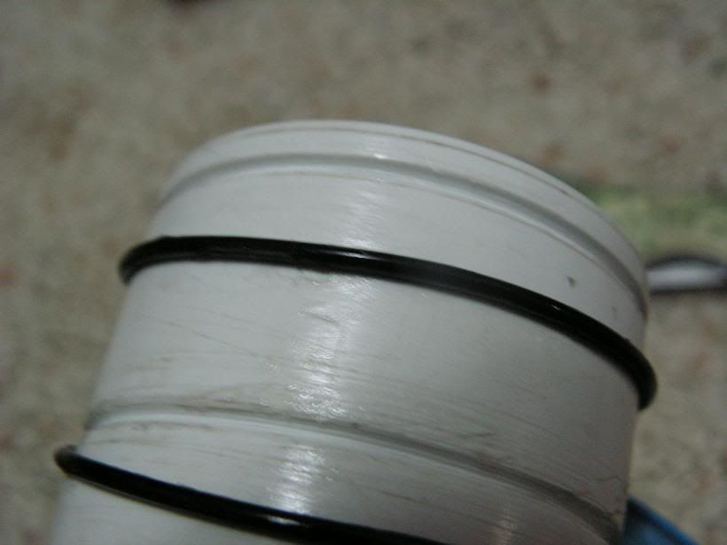

Unread postAuthor: c19o » Mon Sep 10, 2007 9:02 pm
Nope, i used a drill with some tape on it. Heres a pic of it with the o-rings off.

Unread postAuthor: e1337 » Mon Sep 10, 2007 9:06 pm
Ahh. Very good idea. I have to try that sometime. Thick or thin tape?
WHats the piston made of?
-E1337
  • 0
e1337
Posts: 110
Joined: Mon May 28, 2007 8:00 pm
Reputation: 0
Unread postAuthor: c19o » Mon Sep 10, 2007 9:07 pm
i used alot of thin, clear tape so that i get the perfect fit. I think its a 1 1/4" coupler i forgot or 1 1/2".

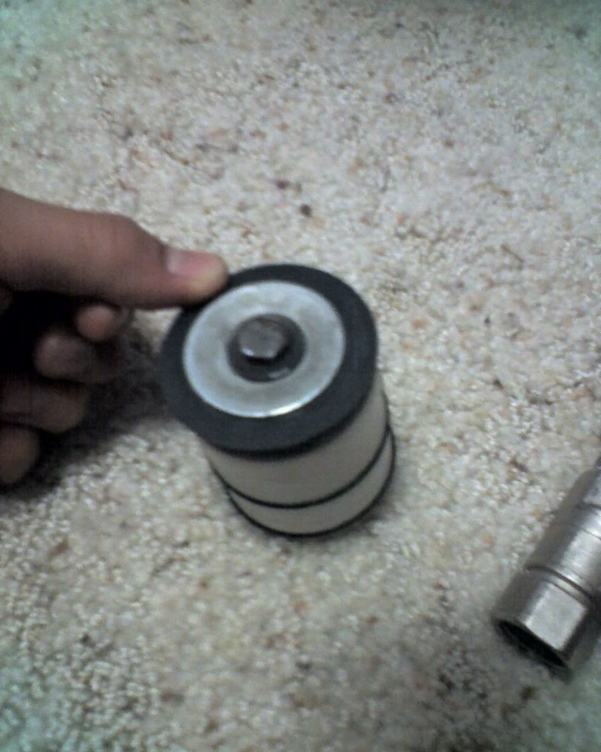

Unread postAuthor: e1337 » Mon Sep 10, 2007 9:11 pm
I think It has to be 1 1/4" Coupler. (Fits snug in 2" sch 40.)
Whats that between the sealing face and the coupler?

Unread postAuthor: MrCrowley » Mon Sep 10, 2007 9:17 pm
Nice cannon. How did you get those grooves? Mind explaining this tape thing?
  • 0
Posts: 10209
Country: New Zealand (nz)
Reputation: 6
Unread postAuthor: c19o » Mon Sep 10, 2007 9:19 pm
Well i took the bare coupler, and a drill. Turned the drill and let some tape spin onto it. stuck the coupler on and spun some more tape until i had a snug fit,then used a knife, xacto knive, and a small, sharp screw driver to cut the grooves.
