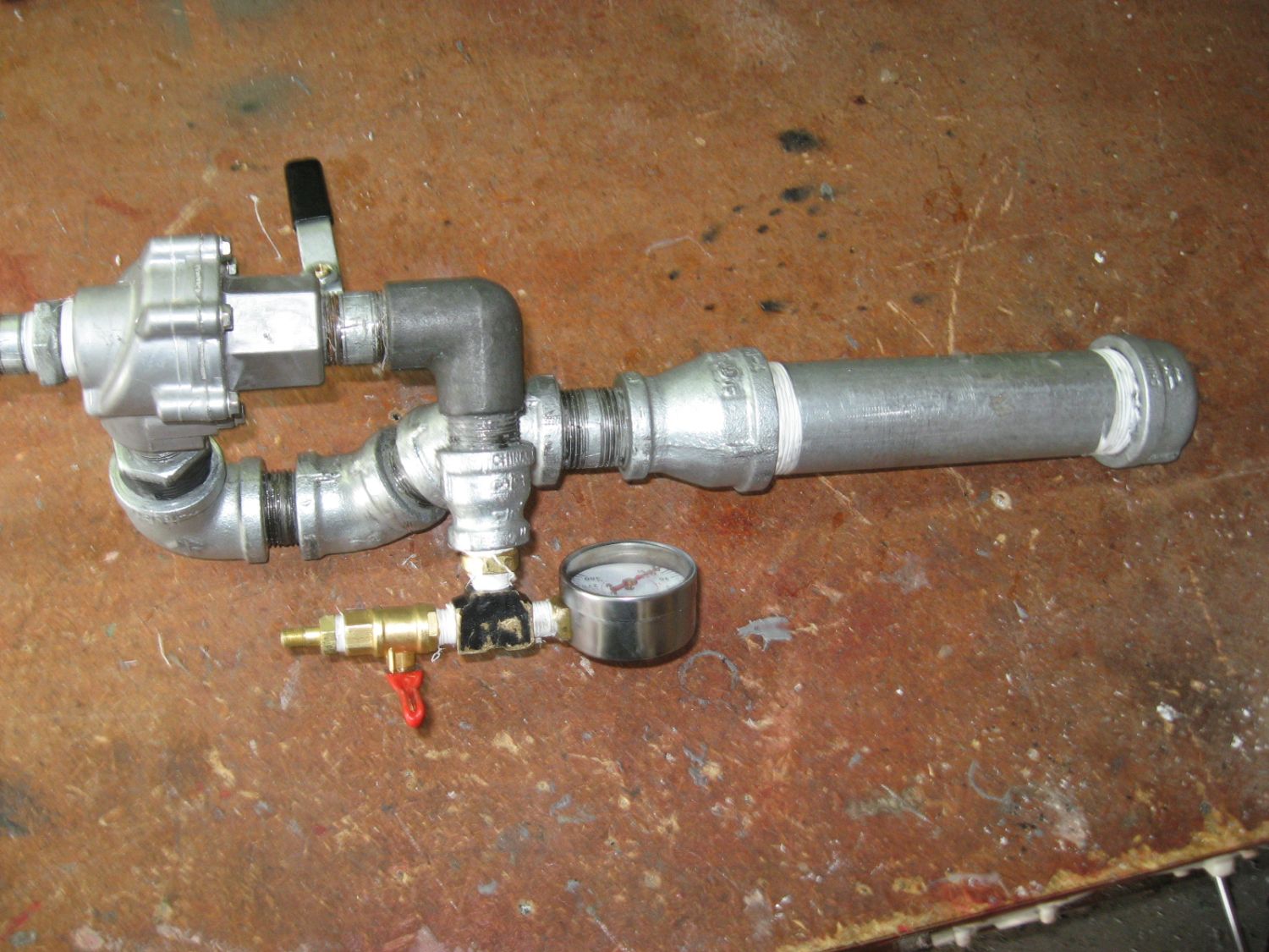

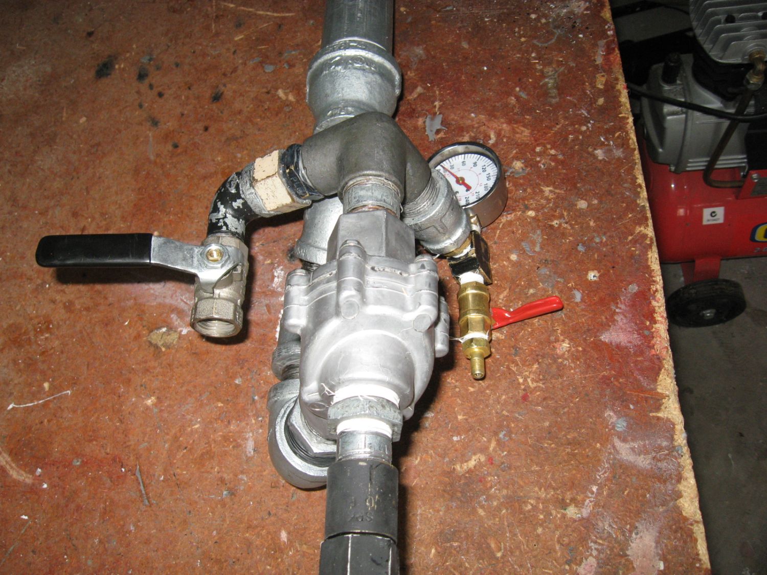

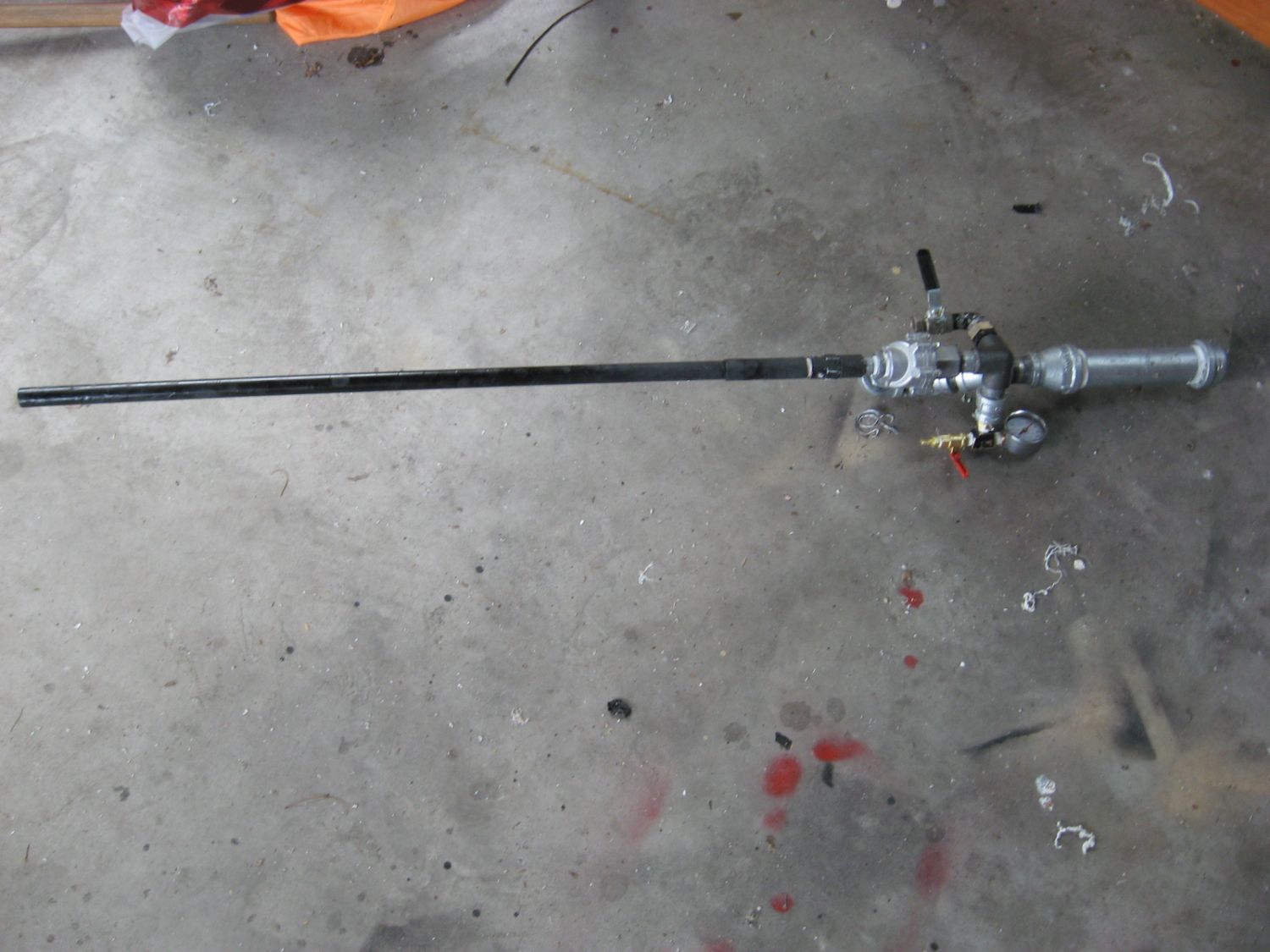

This is my second gun from the supplies I got from America.
This one is called SG - Penetrator because of the awesome damage it can do with a paintball.
Until I get a metal barrel i'm borrowing my DSGR/SGI paintball barrel which works like a charm.
Specs:
Barrel Diameter: Currently .5"/15mm
Chamber Diameter: 1" and 1.5"/25mm and 40mm
Barrel Length: 36"/90cm
Chamber Length: Around 30cm I guess
Valve: 3/4" QEV
Fill Valve: Schrader
Pilot Valve: 1/2" ball valve
Operating Pressure: Around 100-120psi
Ammo: .68" paintballs
Not really much to say here, pictures say it all. Video coming soon, just need to upload it.
Oh yeah it's not exactly clean looking, but hey it works :D

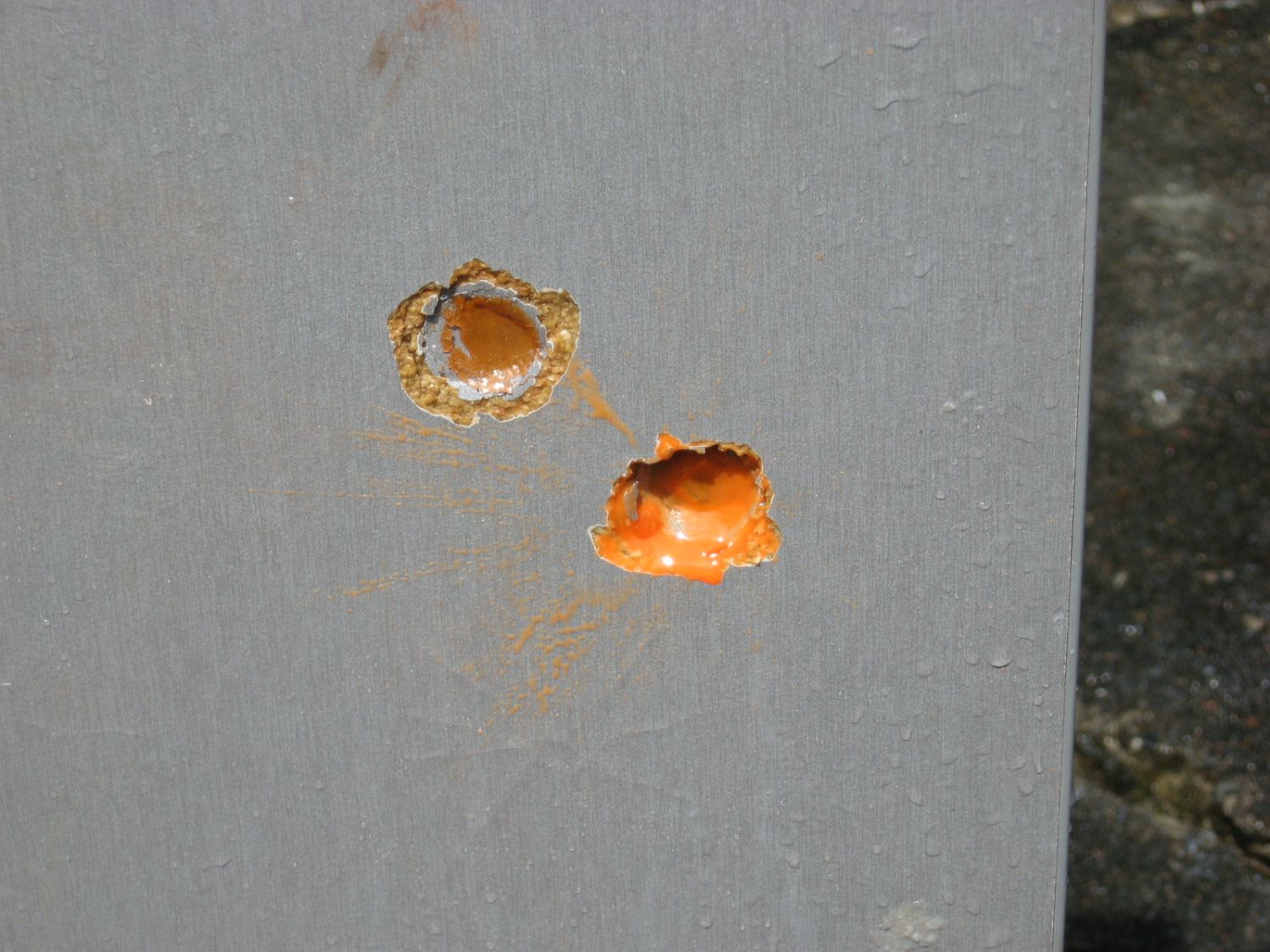

I call that penetration, just got through at the bottom. Paintball at 120psi

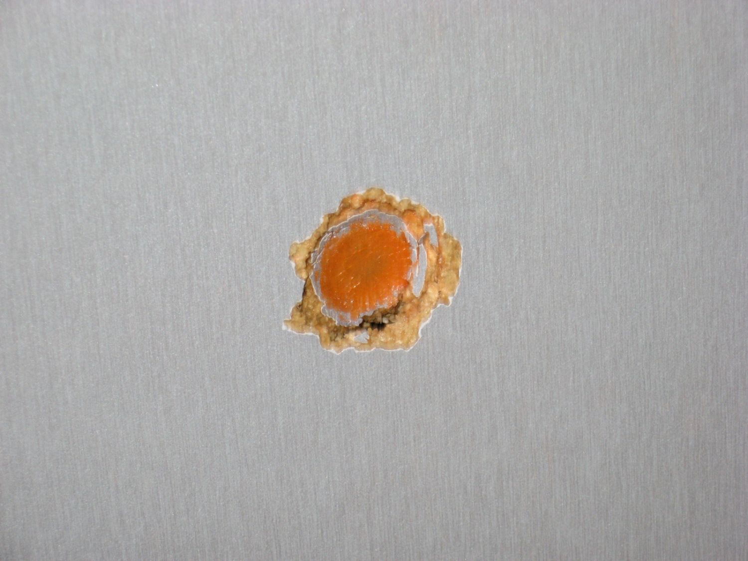

Almost there at 100psi

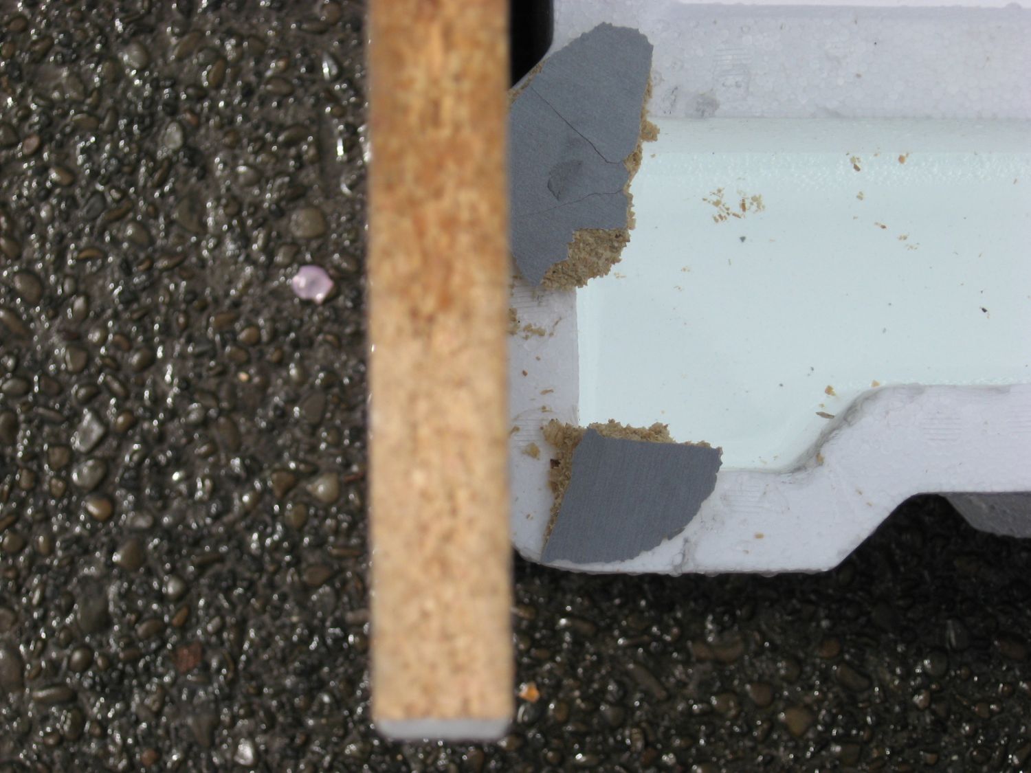

Thickness of the chipboard I was shooting

Unread postAuthor: th3p0p0 » Sat Oct 06, 2007 8:22 pm
nice very nice. i like it,it looks very easy to shoot and hold. what kind of range do you get??
  • 0
th3p0p0
Sergeant Major
Sergeant Major
Posts: 194
Joined: Tue Oct 31, 2006 12:34 pm
Reputation: 0
Unread postAuthor: MrCrowley » Sat Oct 06, 2007 8:27 pm
Dunno, just finished it about 15minutes ago, I've only done damage shots.
  • 0

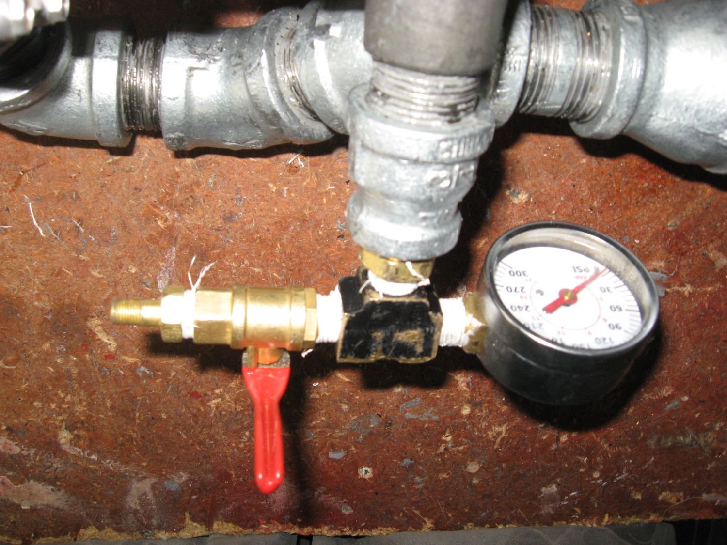

Unread postAuthor: HaiThar » Sat Oct 06, 2007 8:55 pm
How does the ball valve compare to using a blow gun? Is the difference that noticable?
  • 0
HaiThar
Donating Member
Donating Member
Posts: 227
Joined: Fri Sep 14, 2007 12:12 am
Reputation: 0
Unread postAuthor: MrCrowley » Sat Oct 06, 2007 8:59 pm
Hell yeah, my pilot volume is way to big for a blow gun. It actuates the QEV but lets out a lot of air before the QEV actuates.
  • 0

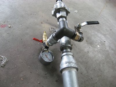

Unread postAuthor: mopherman » Sat Oct 06, 2007 9:22 pm
have you already used up all your american parts? The gun looks great, aside from the big pilot. what is that fitting on your pilot setup?
  • 0
-Bad religion
mopherman
Brigadier General
Brigadier General
Posts: 788
Joined: Sat Feb 03, 2007 8:20 pm
Reputation: 0
Unread postAuthor: MrCrowley » Sat Oct 06, 2007 9:28 pm
Nah, well I got a GB gun in the making, similar to my PB gun I just made, except it has a 4" chamber and a GB barrel. I also bought some fittings for 2 other guns I need to fix up but I still have quite a few left over.
Not sure what it is, I bought a whole box of galv fittings awhile back and it came with them. I have a few more.
  • 0

Unread postAuthor: jackssmirkingrevenge » Sat Oct 06, 2007 10:00 pm
a) shame on you for the gargantuan pilot volume :?
b) don't you think 120 psi is a little too kind on an all-metal launcher?
  • 0
Donating Member
Donating Member
Posts: 24976
Reputation: 120
Unread postAuthor: MrCrowley » Sat Oct 06, 2007 10:07 pm
Well the QEV is only rated for 150psi, my crappy Wal*Mart pump can't do more then 120, and my compressor is limited to 115psi.
Yeah I know it's a tad huge, but I had an extra 1/4" tee I was gonna use so I could fit everything in(guage, schrader,pilot valve etc) but a fitting snapped inside it and rendered it useless. So I had to improvise with the little small diameter fittings I had left.
I'm thinking of putting a tee where the 90* elbow is on the chamber, and having the guage come out the back of it, then I could get rid of the huge 3 way thingy in my pilot area and just have that 1/4" tee there and hook my blowgun up to that where the guage is.
  • 0
Posts: 10209
Country: New Zealand (nz)
Reputation: 6
Unread postAuthor: MrCrowley » Sun Oct 07, 2007 12:36 am
GGDT says otherwise, I can't get an increase or decrease in velocity by increasing or decreasing the pilot volume within a reasonable amount.
Though my figures for the QEV were pretty half ass mixed figures from an old SGTC thread. Does anyone have some proper ones?
  • 0

Unread postAuthor: nivekatoz » Sat Dec 29, 2007 5:11 pm
I don't know much about QEV's but couldn't you trigger the valve with a blow gun???? because all the ball valves makes it look a little bulky...but thats just me.....other than that I like it, its cool....
  • 0
nivekatoz
2nd Lieutenant
2nd Lieutenant
Posts: 237
Joined: Sat Nov 25, 2006 7:05 pm
Reputation: 0
Unread postAuthor: BigJon » Sat Dec 29, 2007 5:44 pm
Yes you could. Most quick exhaust valves trigger by just a slight drop of pressure in the pilot if im not mistaken.
  • 0
BigJon
Posts: 120
Joined: Wed May 30, 2007 12:21 pm
Reputation: 0
Unread postAuthor: MrCrowley » Sat Dec 29, 2007 6:01 pm
nivekatoz wrote:I don't know much about QEV's but couldn't you trigger the valve with a blow gun???? because all the ball valves makes it look a little bulky...but thats just me.....other than that I like it, its cool....
Yes but I would have poor performance. I actually have a 1" sprinkler piloted by a blow gun as the pilot valve now.
  • 0
