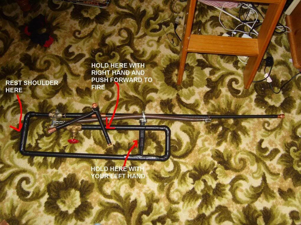

Unread postAuthor: trollhameran » Thu Jan 03, 2008 3:34 pm
ive labeled this pic to answer both your questions
Image[/img]
@Mr. Beaver, no it isnt hard to aim because you can hold it like a rifle and then look down the barrel

Unread postAuthor: Hotwired » Thu Jan 03, 2008 3:41 pm
That must be the longest spring I've ever seen on a spudgun.
Also the first time I've heard the sounds of mooing in a spudgun video :lol:
Still, that spring seems to do the job.
Good stuff :)

Unread postAuthor: trollhameran » Thu Jan 03, 2008 3:55 pm
lol yeah its the only decent spring i could find anywhere, according to my dad its a pipe bending spring (he's a plumber). Its a really strong spring though and it works how i wanted it to when i as designing it so its all good.
haha yh the cows dont like spud guns lol.
ill try get some more videos at the weekend and find out what it can do with some different ammo, because havnt tested it much yet because my dad had to take the compressor to work.
Thanks for the possitive replies.

Unread postAuthor: Ragnarok » Thu Jan 03, 2008 4:51 pm
trollhameran wrote:lol yeah its the only decent spring i could find anywhere, according to my dad its a pipe bending spring (he's a plumber).
It is indeed a pipe bending spring, it was the first thing I spotted. Interesting use of it. Watch your fingers, they're very stiff - if you're just slightly careless, you could be nursing a nasty injury for some weeks.
