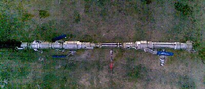

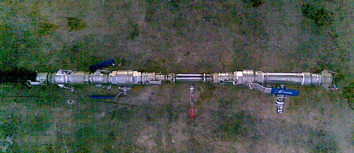

I've often mentioned making launchers out of the pipe fittings at work, well I bought myself a half decent cellphone recently, looks a bit like an F117 stealth but anyway, I thought I'd snap a picture. That's basically lots of fittings camlocked together to make the chamber, the black pipe on the left is 2.5 inch hydraulic tubing which is the current barrel. Air is fed from the quick fit next to the red ball valve and the burst disk is placed at the camlock which is connected to the barrel.

Today we made a fitting for a 3" barrel, so we might be firing that 2.75" ball bearing in the near future :) To give an idea of scale, the large ball valves with blue handles are 2", it's all 316L stainless :D

From the pictures it looks like a 1/2" or even a BB gun, but 2.5" dia. barrel? Wow!
What pressures are you using in this? 120PSI from a standard compressor or like Nitrogen/Helium?

I was wondering if you could seal a burst disk in a cam lock, any leaks or such?
I do have a regulated nitrogen cylinder on hand but for safety's sake we're using the plant air suplly, aroind 70-80 psi

Don't tempt me! - but I think we've reached the practical limit of power that can be safely used within what it after all a chemical plant.
