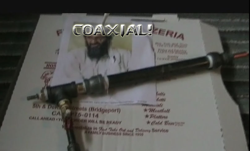

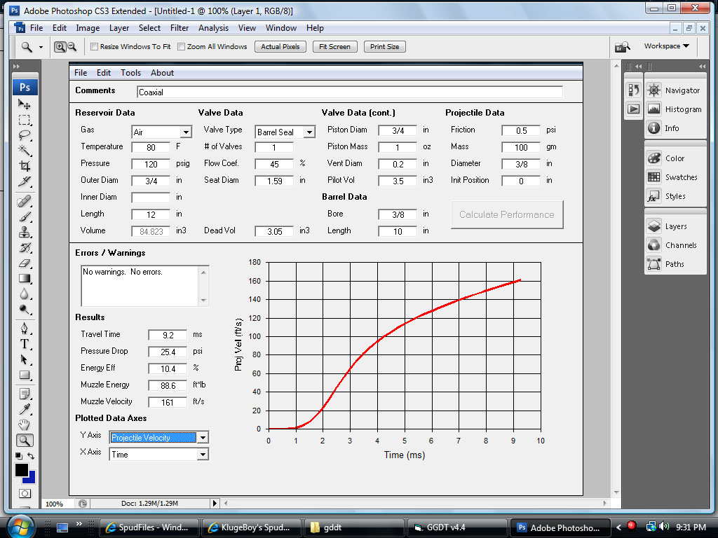

Thanks to everyone it is finished! :D I fixed all the kinks out and it's awsome! Keep in mind its only about 20-30 Psi in the vid.
If you want the specs just ask!
Click the GGDT picture and maximize it.

Unread postAuthor: STHORNE » Sat Mar 29, 2008 7:02 pm
wow, for your first, that thing is wicked.
and yes, i would like specs please.

Unread postAuthor: elitesniper » Sat Mar 29, 2008 7:08 pm
what size barrel and chamber?
  • 0
elitesniper
Brigadier General
Brigadier General
Posts: 1090
Reputation: 0
Unread postAuthor: Counterstriker » Sat Mar 29, 2008 7:15 pm
The barrel is 11 inches, The piston is in the 1/2" brass steel nipple, The chamber is 10", The piston is a crayola marker with epoxy in it with a neoprene sealing face, The valve is a 1/4" ball valve. If I am missing something tell me and I will tell you.
Thanks for the positive feed back!

Unread postAuthor: elitesniper » Sat Mar 29, 2008 7:17 pm
I ment the diameter of the chamber, its probably 3/4
  • 0
elitesniper
Brigadier General
Brigadier General
Posts: 1090
Reputation: 0
Unread postAuthor: Counterstriker » Sat Mar 29, 2008 7:18 pm
elitesniper wrote:I ment the diameter of the chamber, its probably 3/4
Correct :D
