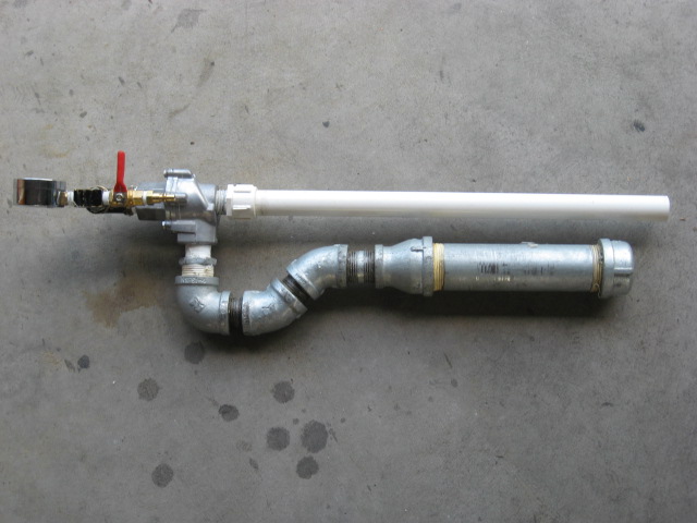

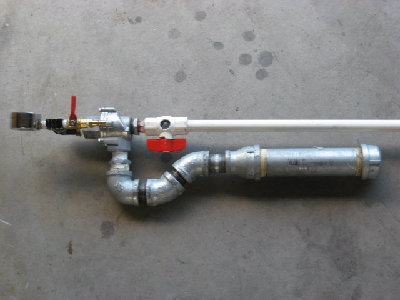

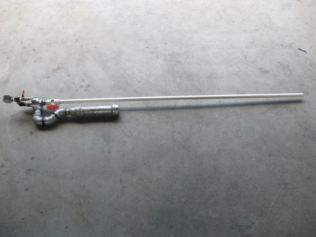

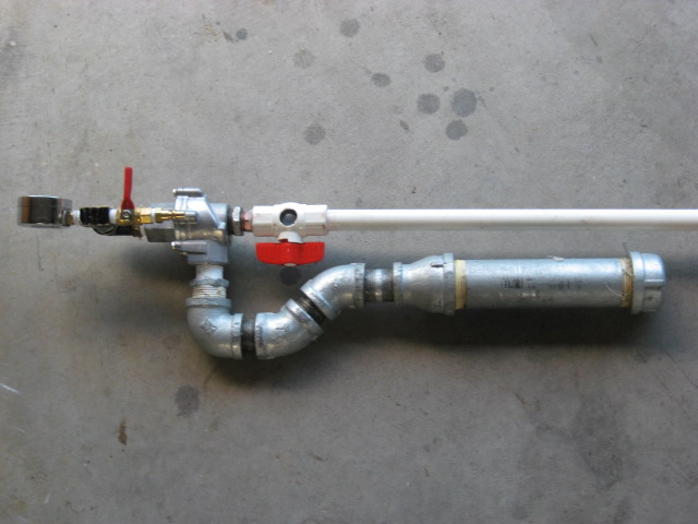

I was getting bored over the holidays so I gave the <A HREF="http://www.spudfiles.com/forums/viewtopic,p,123928.html#123928">SGP</a> a little make over :)
The main setup:
Barrel: 1400mmx15mm paintball barrel
Chamber: 1.5"x12" and ~1"x12"

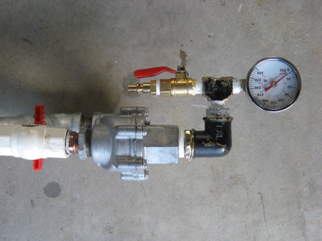

Valve: 3/4" Quick Exhaust Valve
Pilot Valve: 1/4" ball valve
Fill Valve: Same 1/4" ball valve
Operating Pressure: 80-115psi (150psi when I make a pump)
Ammo: .68 paintballs
The other variation, is more of a BtB tribute sawn-off style (without the high pressure :( )
I don't have any damage pictures but I did do a few test shots.
At 90psi with the long barrel, paintballs go through one side of my mini-fridge. With the short barrel at 90psi, the mouseballs also go straight through.
Just thought of a name: Slim Biggin's :D
Oh and yeah she's not very pretty, got no spraypaint to paint the pilot setup and the teflon tape on the chamber is a few months old and has yellowed :shock:
Anyway, here she is:

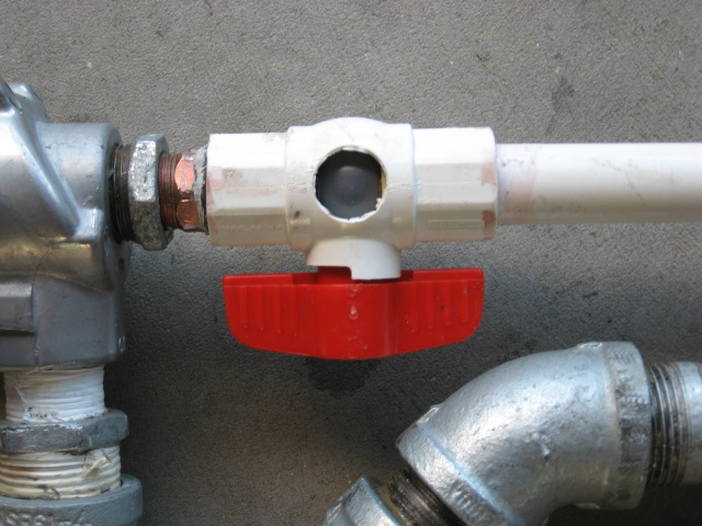

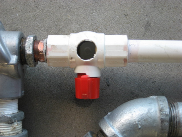

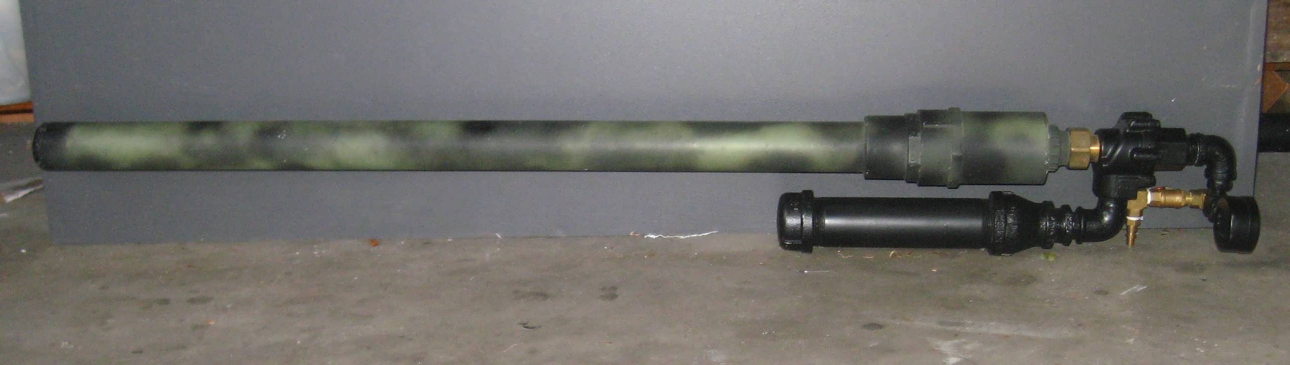

New look. Showing off its golfball gun potential.

Unread postAuthor: biggsauce » Wed Apr 23, 2008 10:46 pm
Nice name for a nice cannon
Puts a paintball through a side of a mini fridge...
To say the least, OUCH

Unread postAuthor: elitesniper » Wed Apr 23, 2008 10:48 pm
Cool Mr.C, I love the name, nifty high powered plinker eh?

Unread postAuthor: MrCrowley » Wed Apr 23, 2008 11:00 pm
Thanks guys, and yeah it's pretty damn powerful.
The paintballs were denting my fence pretty badly too, some cracking the otherside. I've actually got the gun in my lap as I type now, I love the look and feel of the 'sawn-off' setup :)

Unread postAuthor: Lentamentalisk » Wed Apr 23, 2008 11:30 pm
Wow, that has got to be the ugliest gun you have made yet :) Still, it more than makes up for it in power. Double thumbs up!

Unread postAuthor: MrCrowley » Wed Apr 23, 2008 11:38 pm
Lentamentalisk wrote:Wow, that has got to be the ugliest gun you have made yet :)
Hell yeah! :) I was going to name it the Ugly Duckling, but I like Slim Biggins better :wink:
I'm thinking of painting it, the whole pilot volume setup is old parts that have been painted and then scratched over so they look like sh|t.

Unread postAuthor: MrCrowley » Thu Apr 24, 2008 12:02 am
Thanks Gippeto and jook13 :)
Yeah I know, i'd take it up to 200psi, doesn't bother me even though the QEV has only a 150psi rating. :P

Unread postAuthor: MrCrowley » Thu Apr 24, 2008 5:28 am
Thanks, I decided i'm going to paint it, for the intimidating factor and I can't stand to have such a shotty looking cannon :D

Unread postAuthor: psycix » Thu Apr 24, 2008 9:59 am
Ah thats a nice one.
Though whats the PVC barrel needed for?
Just go all-metal :)

Unread postAuthor: Brian the brain » Thu Apr 24, 2008 1:02 pm
Eehmm..The sawed-off style requires a reservoir as snug under the barrel as possible ( use an elbow wich threads right into the valve)
Some trimming might be needed.
But absolute essential is the ballvalve trigger and bend as handle.
Other than that it does seem like a very nice gun to play around with.
Just not something I would compare to the sawed-off when it comes to looks.
Coming to think of it, I have seen a lot of "copies" that did not even look like it.
Not that that's a bad thing though.
I like the use of the 45's
  • 0

Unread postAuthor: MrCrowley » Thu Apr 24, 2008 5:50 pm
psycix wrote:Ah thats a nice one.
Thanks. And because copper is expensive and hard to get. Well not hard to get, I just have to go for a drive for 40minutes so I can get an off-cut of 1m.
Brian the brain wrote:Eehmm..The sawed-off style requires a reservoir as snug under the barrel as possible ( use an elbow wich threads right into the valve)
Yeah I was thinking about that, but nothing threads all the way into a QEV. It was really bugging me, I tried a bunch of fittings too.
Brian the brain wrote:But absolute essential is the ballvalve trigger and bend as handle.
I actually had a spare 1" sprinkler valve piloting it at one stage :lol:
Definitely not, it is bloody ugly and fittings aren't exactly snug like on your sawn-offs. And your Sawn-offs have piston valves, which I'm tempted to put on this. And use the QEV for something else. So once I make a pump, I can go high pressure. Tempted.
Brian the brain wrote:Coming to think of it, I have seen a lot of "copies" that did not even look like it.
Well it's not like I set out to copy your design or anything, just rotating the chamber 180 from it's last design, ended up like a sawn-off because of the short length, and everyone knows sawn-offs are automatically directed at you :wink: :)
Thanks, those galv fittings were a b|tch to line up, at one stage I was sitting on the plumbing wrench with all my weight and it didn't move one bit. I had to get out the sledge :D
  • 0
