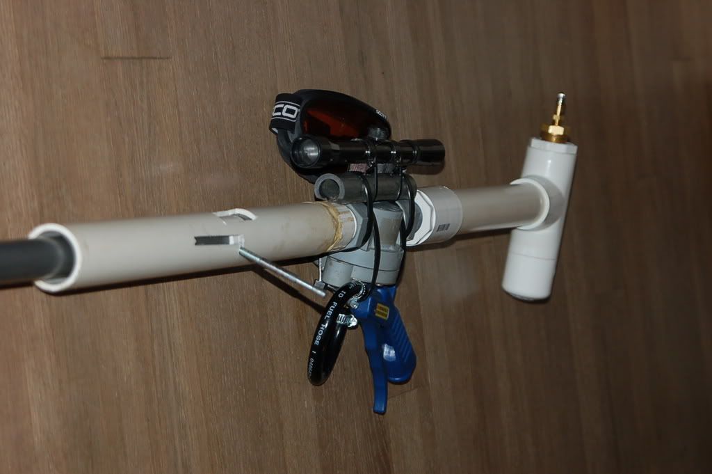

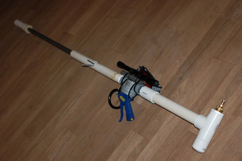

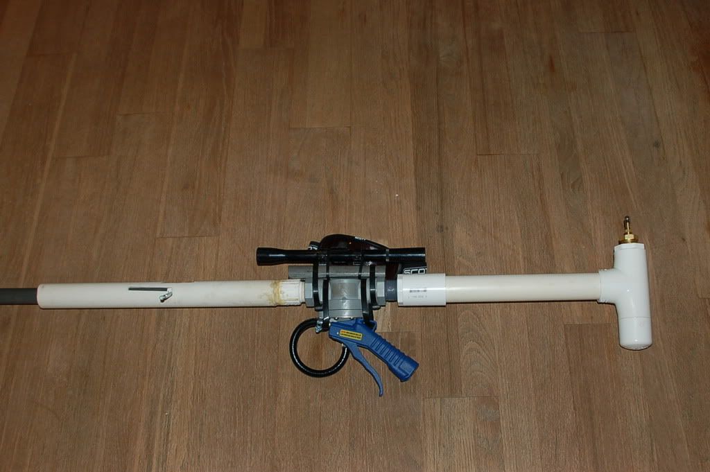

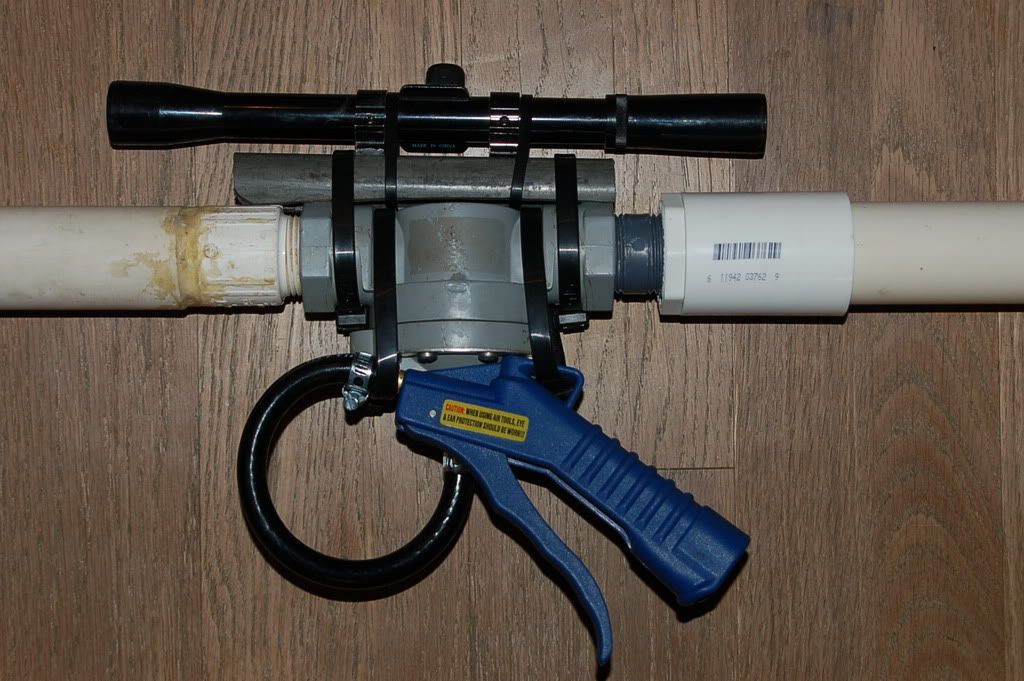

Unread postAuthor: Mateo » Mon Dec 29, 2008 10:41 pm
Oh Shiz!
this is my first modded sprinkler valve cannon. its primarily used as a smooth bore long range "rifle". it was made as a paintball sniper to be used in skirmishes from long distances on my friends property. this cannon can be broken down into 3 pieces. barrel, valve, chamber. right now im filling it up with a bike pump until i can buy a co2 regulator. then i just unscrew this chamber and put a diff one on :D
barrel: 3/4 in
chamber: 1 1/4 in
sprinkler: 1 in
silencer: iron wool filled
hosing: 200psi fuel line
any questions just ask.
and i found a tiny leak in the chamber. is there any way to patch it?

Unread postAuthor: JDP12 » Mon Dec 29, 2008 10:45 pm
well where is the leak?
  • 0

Unread postAuthor: john bunsenburner » Mon Dec 29, 2008 10:46 pm
Nice cannon, next time use teflon on your threads, show vids and dammage pics, oh and i have the same skiing glasses. To stop leaks i like using bondo, or teflon tape as well.

Unread postAuthor: Mateo » Mon Dec 29, 2008 10:46 pm
in the shoulder section between the tee and cap. there is teflon on the threads. there is no leaking from there

Unread postAuthor: john bunsenburner » Mon Dec 29, 2008 10:49 pm
it looks more like snot, thats not teflon...

Unread postAuthor: Mateo » Mon Dec 29, 2008 10:53 pm
you cant see the teflon in any of the pics. the yellow is epoxy to hold the sleeve to the fitting. there is 3/4 in pvc inside it that the barrel gets locked onto

Unread postAuthor: grock » Mon Dec 29, 2008 10:53 pm
well, if you already glued it you could do one of 2 things. you could put superglue over the leak, that will pretty much melt it closed, however, that will also make a failure-prone weak spot in the chamber. the other option is to cut off the chamber pipe and put a new T assembly on it. other quick-fix options include putting more primer/glue over the leak, and just using good old duct tape, but neither will be permanent i'm sure

Unread postAuthor: STHORNE » Mon Dec 29, 2008 11:32 pm
looks fantabulouse mate!
good work, can't wait to see a paint job on it :wink: (hint hint)
and as far as the leak.... JB WELD!!!! lol
  • 0
