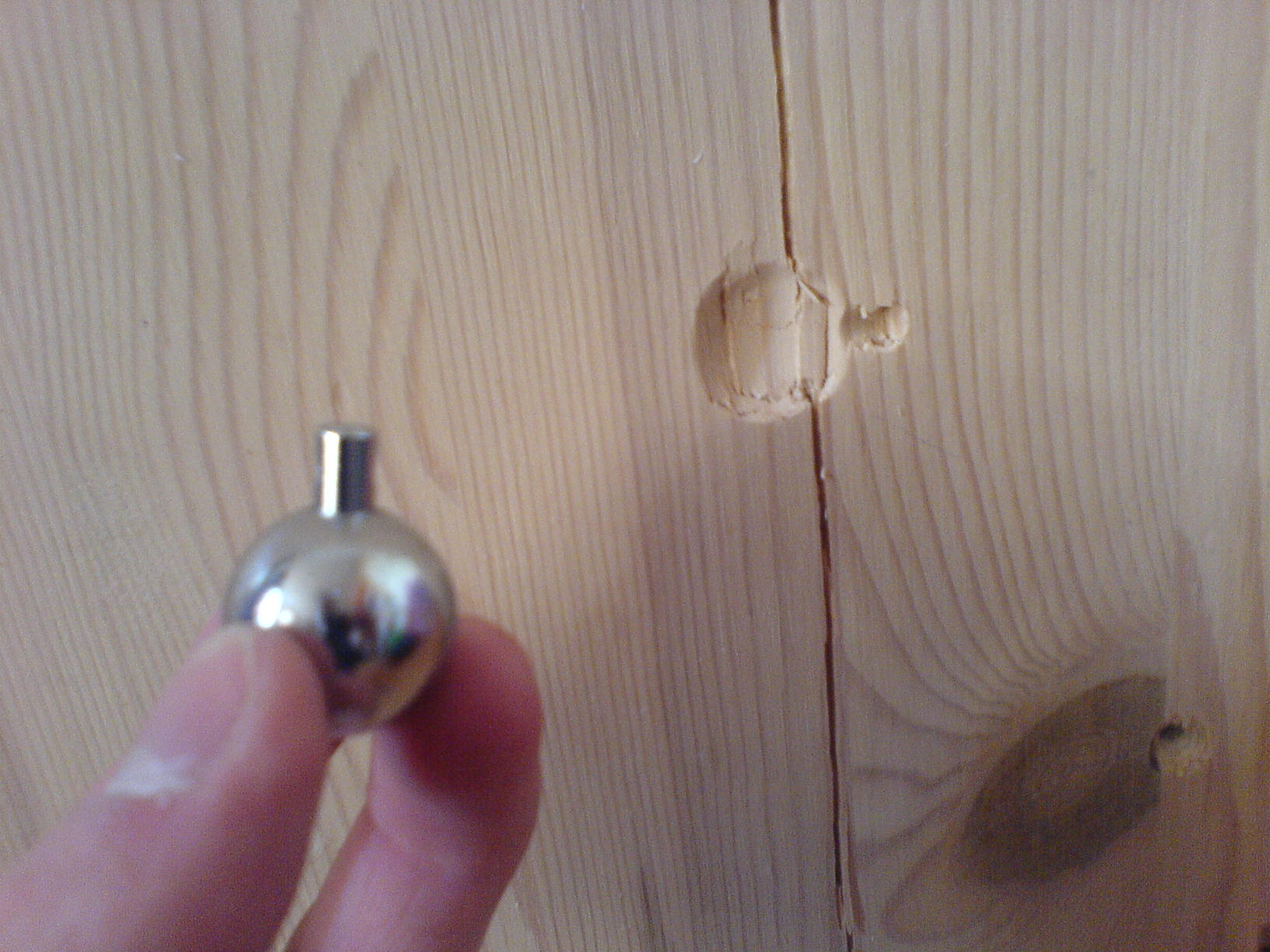

I shot this metal ball with a wadding.
It split the board and left a beautiful imprint.

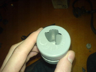

The piston before it was glued, after the first shot before I installed the bumper.
I replaced the broken endcap and installed a bumper.

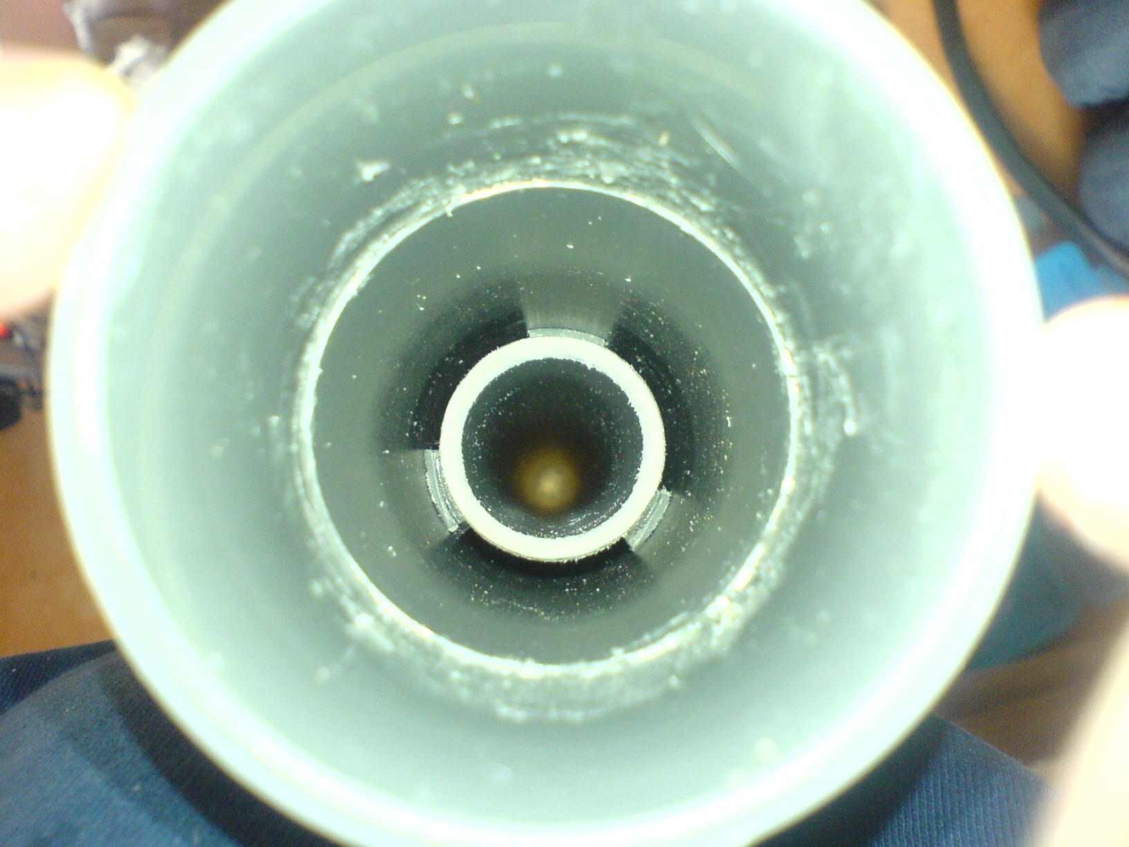

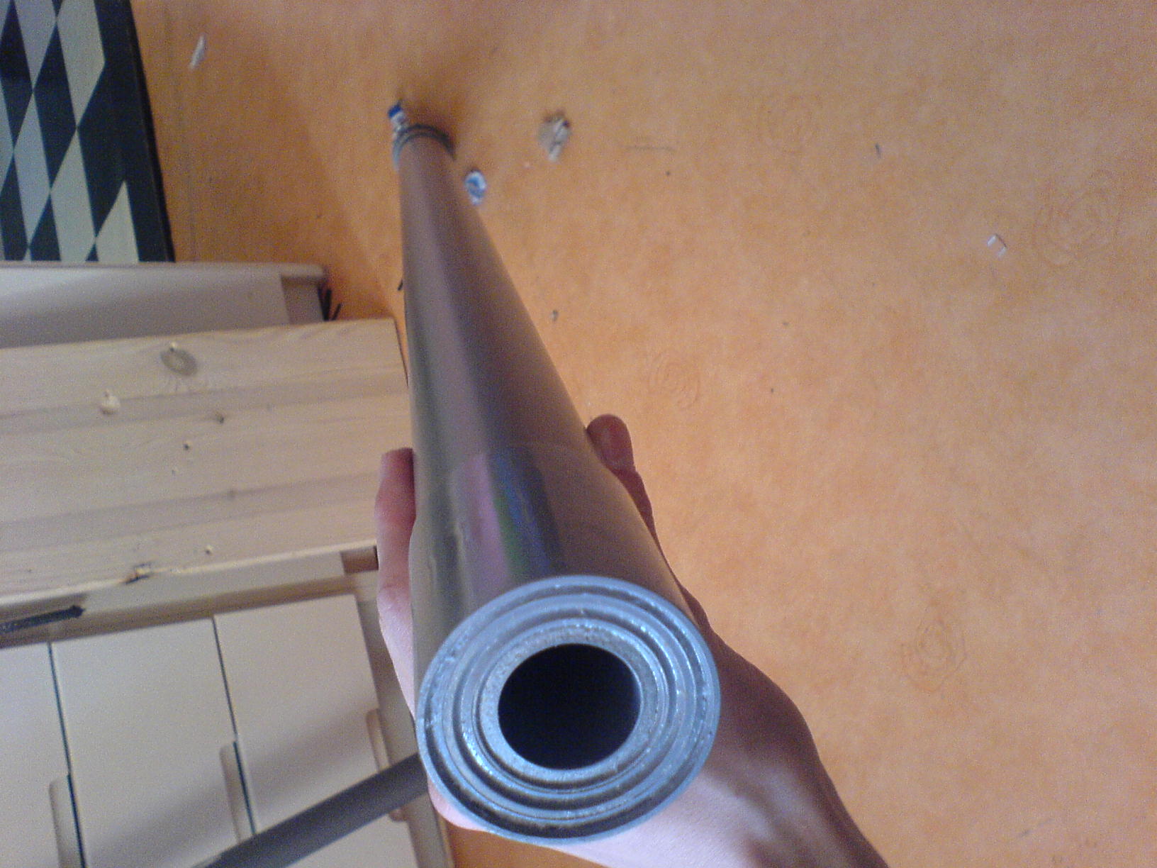

Looking down the chamber.

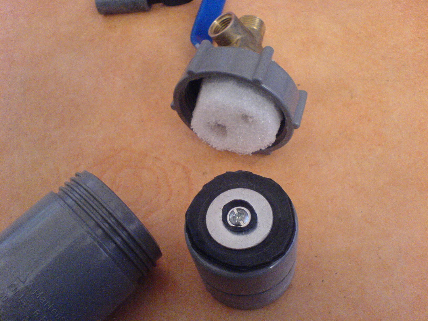

The finished piston and the screw-on cap with bumper.
I like the look of this. No barrel sticking out.

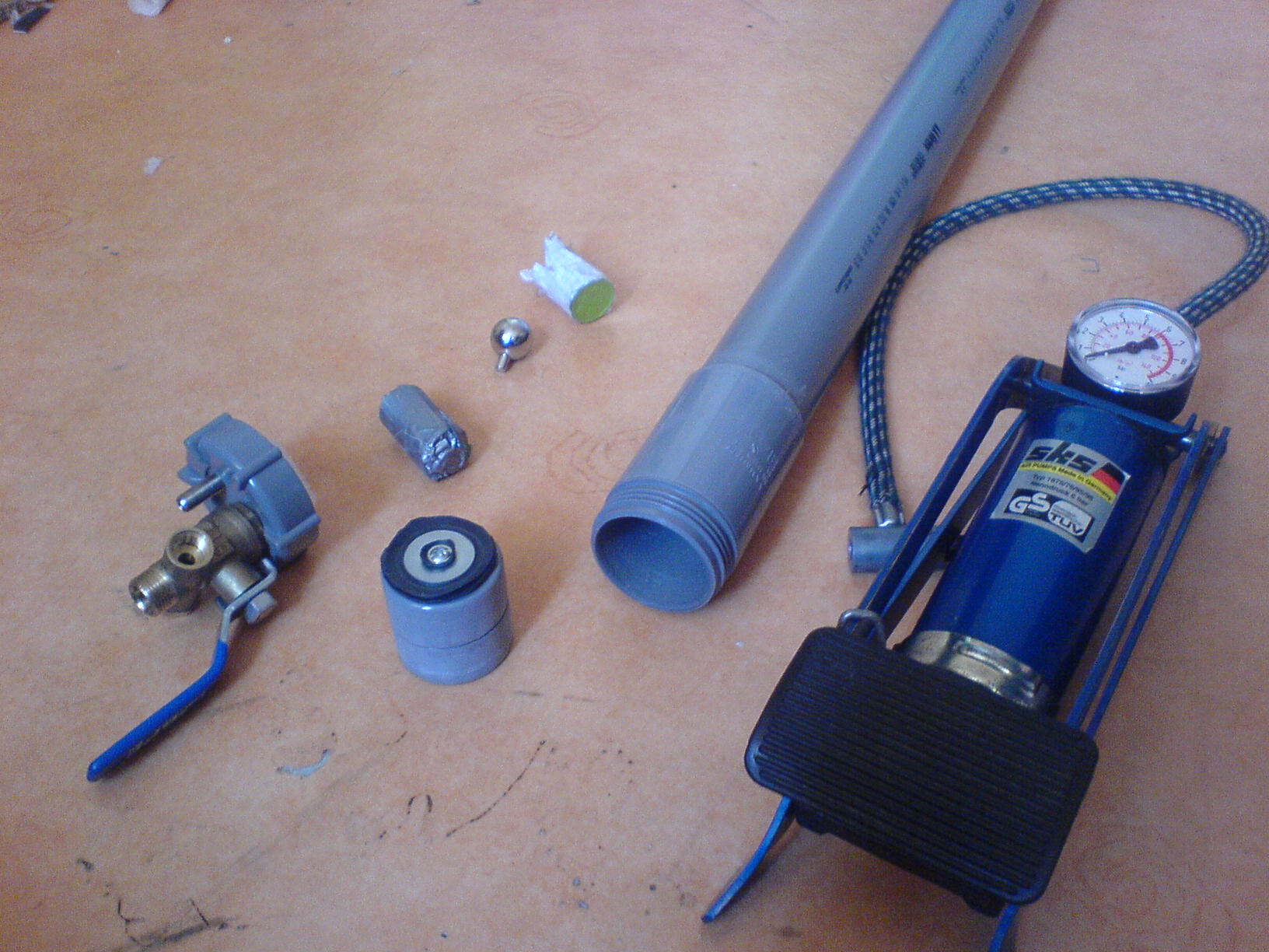

The rear of the gun along with some ammo.

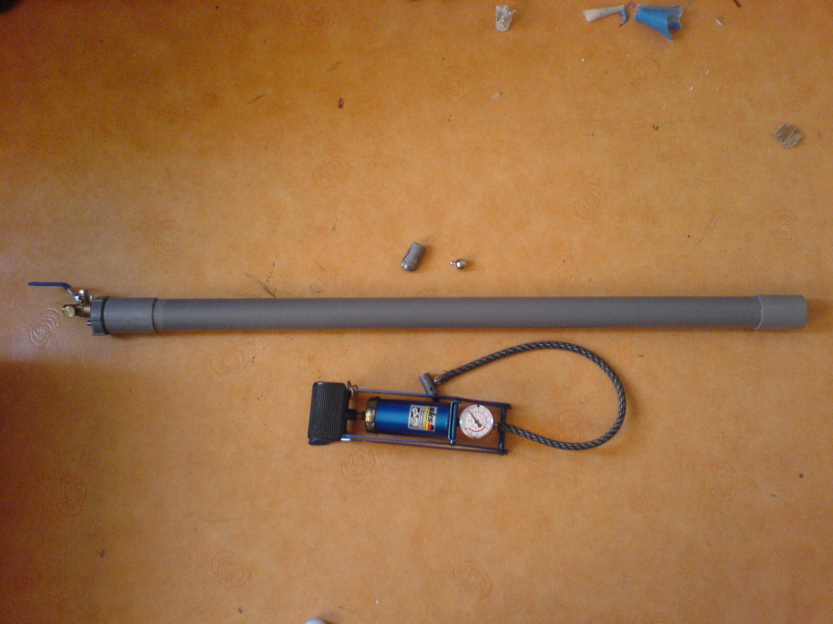

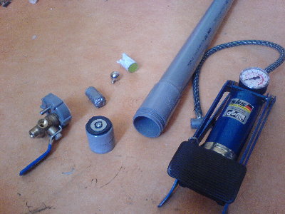

The gun along with the pump I used. I didnt have a compressor back then.
The outside is plain, simple and smooth. Its just one big stick with a valve on the end.
