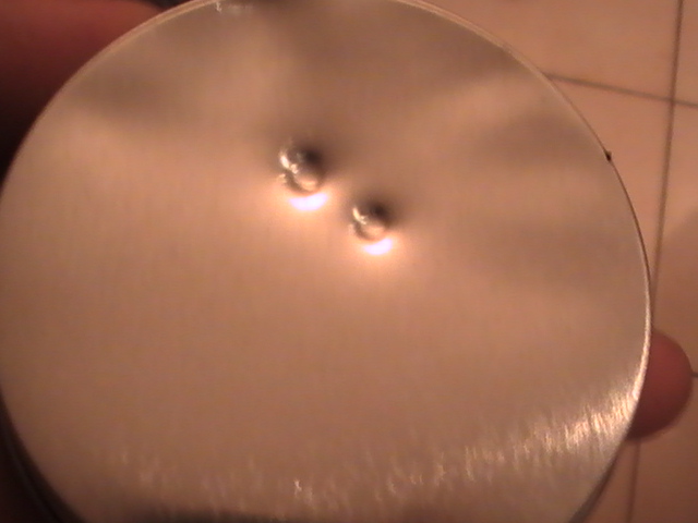

some dents in a gamo tin at 170 psi with 18 grain(1.16 gram) pellets

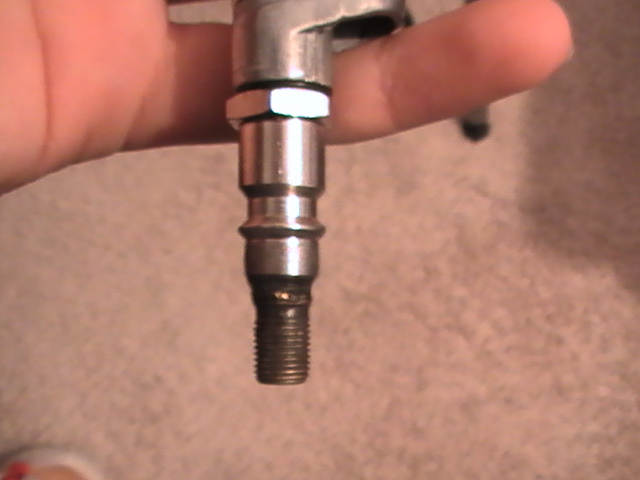

the valve glued in
