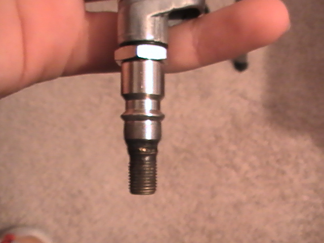

my goal was to make a pneumatic pellet pistol
1for under €30 that was
2easy to operate
3looked clean
4was accurate and above all
5could easily fire through cardboard and soda cans!
so did i succeed?
1cost gun
blowgun €4.95
valve €5.50
8mmOD barrel €2.70/meter
that's €13.15
2 to operate
connect pump
pump it up
put a projectile in the barrel
shove it down the barrel
faiah!
this can all be don in less then 30 seconds
3decide for yourself
4 at 5 meters i get a 3" grouping without sights, haven't put any on

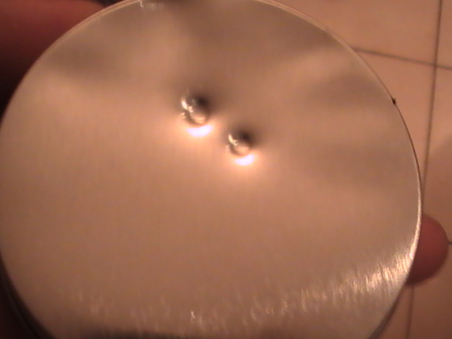

5 at 200 psi, less then half the max power, it goes through 2 soda cans or 3 sheets of cardboard
sorry for any bad grammar, i'm 13 and dutch

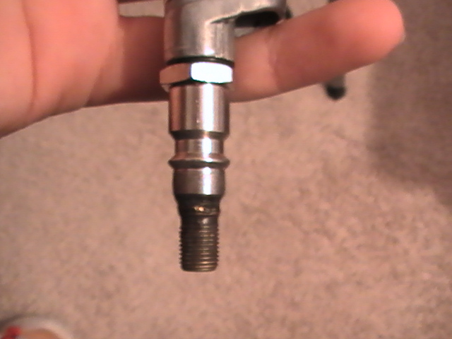

it uses the space inside a blowgun between the inlet and the valve as chamber
it have got it to +- 470 psi without leaks, i know it can go higher but my pump only goes so far :wink:
it has a 5.7mmID barrel (just a little bigger then 0.22") glued in the outlet of the blowgun
so .22 gamo long distance and pro magnum fit perfectly in it
I use a SKS Suspensioneer shock pump with a scale of 0-360 psi to pump it up(although it can go to >450)
[youtube]http://www.youtube.com/watch?v=f4CB7FUQX10[/youtube]
some firing
[youtube]http://www.youtube.com/watch?v=3AwfUXS7Xh8[/youtube]
the whole charging, loading and firing sequence
pressure
lead pellets >100, best at 200-300
spitballs 30-150 best at 100, starts unfolding at >200

some dents in a gamo tin at 170 psi with 18 grain(1.16 gram) pellets
the valve glued in
