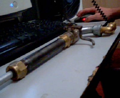

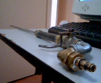

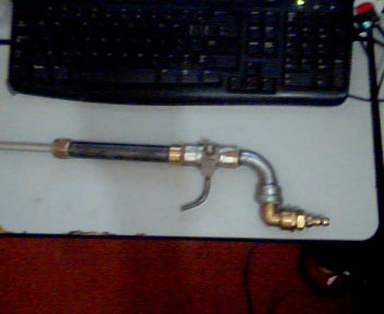

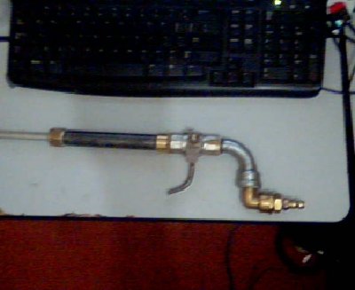

Nothing special but none the less a very reliable gun. I have another high pressure pump getting built at the moment. This is my first gun in over a year! ...Mainly because I just got that bored that I had to make something!
It's just a 8mm coaxial piston gun. Virtually fool proof! :D
The barrel is about 500mm long.

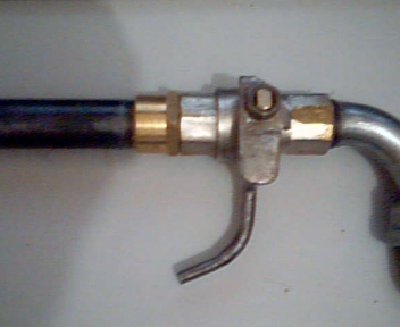

Unread postAuthor: daberno123 » Sun Mar 08, 2009 9:11 pm
Nice little plinker you got there. I especially like the trigger and that curved elbow.
Where did you find an elbow like that? I've never seen one like it before.

Unread postAuthor: Mitchza89 » Sun Mar 08, 2009 10:00 pm
Holy hell those comments came in quick! Everything on the gun I got from my local hardware shop called Bunnings. The elbow is just a standard galvanised 1/2'' M/F bend. Cost me 3 bucks.
The piston setup is stupidly simple. In the brass M/F fitting between the galvanised chamber and the ball valve, there is a cast hot glue (soon to be lathed aluminium) piston with a rubber coated tack in the top. That simple!
There is a steel washer between the brass fitting and the ball valve, that stops the piston from exiting the gun!
