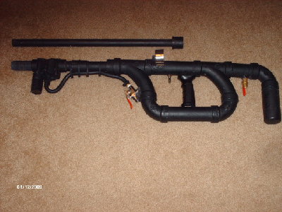

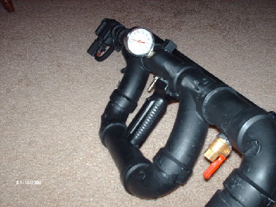

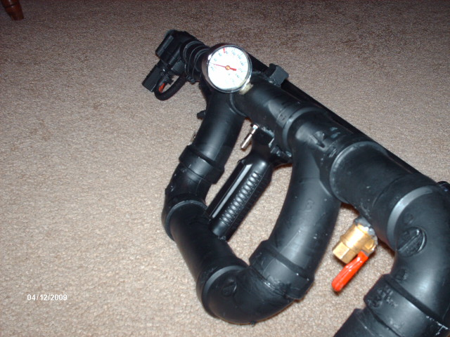

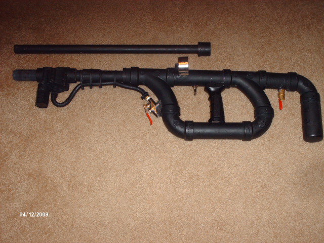

This is my portable pneumatic,it is full of DWV and I am well aware of it.This cannon has a shreader and Co2 adapter. It has a 1" sprinkler very ergonomic handgrip.
  • 0
This it with the .75 barrel.
side view

Unread postAuthor: Mitchza89 » Sun Apr 12, 2009 9:43 pm
:shock: Great job on the gun mate but you better be very, very careful with the pressure you put into it. I can see you put a hell of a lot of work into but the risk is just a bit too high.
Damn shame though...

Unread postAuthor: irisher » Sun Apr 12, 2009 9:49 pm
I handle it with kid gloves and operate at less than 60 psi.

Unread postAuthor: Mitchza89 » Sun Apr 12, 2009 9:56 pm
It's still extremely dangerous though. Your playing with fire there mate... I just hope you don't get too badly burnt.
DWV is reasonable in a combustion because there is a small pressure spike on ignition but it can't handle sustained pressure in this application.
Your choice though. Get ready for a slamming by other spudders. We like to do things as safe as possible so another silly kid doesn't do things wrong, get himself killed and then give the people who do things by the book a bad name.
(that silly kid remark wasn't directed at you. Just in general).

Unread postAuthor: grock » Sun Apr 12, 2009 10:26 pm
nice cannon, mitch is right, some of the other guys might give you some crap for the dwv parts, but as long as you keep it at lower pressures, its fine. i really like how ergo it looks though. does anyone know if you can get presure rated wyes? (i think thats what the curvy T thing is)

Unread postAuthor: rp181 » Sun Apr 12, 2009 10:40 pm
OMG! DWV!
no really, just because its not pressure rated doesn't mean that it can't handle pressure.... (I am not supporting anyone here)
Thats a funky chamber design. If those were Tee's rather than wyes, it would look much better.
