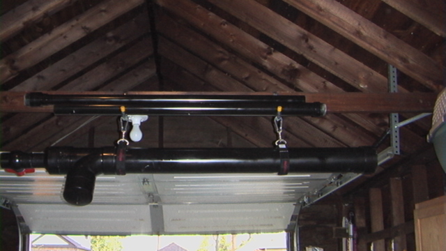

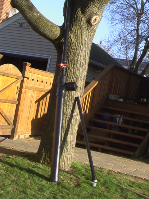

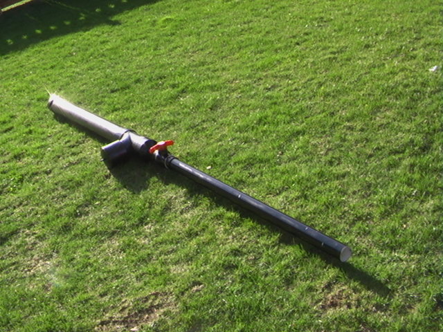

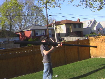

This is my second pneumatic cannon. It has a ball valve trigger system. The expansion chamber is 4' long and 4'' in diameter. I fill it with a schraeder valve. There are two inter changeable barrels, they are both 4' long and one is 2'' in diameter and the other is 1.5''. I typically shoot at 65 psi but my cannon is capable of higher pressures
  • 0
Laying down

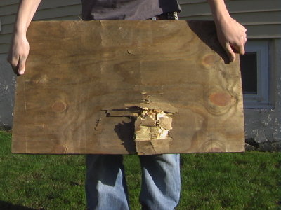

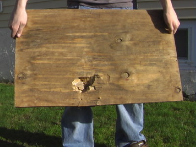

Frontal view of 3/4" plywood after a hit from a duct tape wrapped golf ball at 65 psi
Rear view of 3/4" plywood after a hit from a duct tape wrapped golf ball at 65 psi

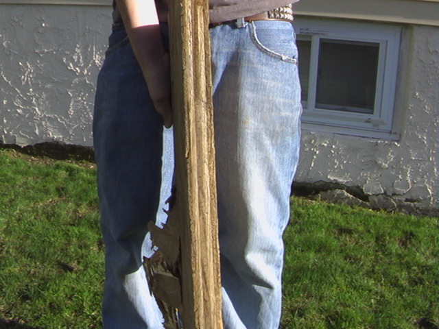

Profile of 3/4'' plywood

Ready for battle!!!
Hanging up

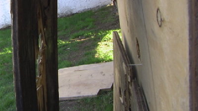

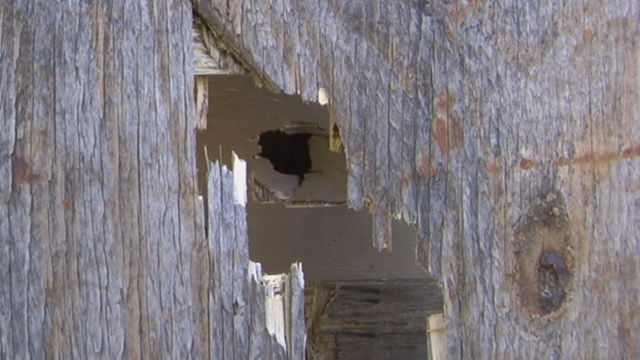

At 65 psi a duct tape wrapped golfball went through two layers of 1/2 inch plywood! (front view)
At 65 psi a duct tape wrapped golfball went through two layers of 1/2 inch plywood! (side view)

couple things though:
1. What's the purpose of the Wye you have near the valve...do you use it as a shoulder rest or something? or is it there "just cause"
2. You might want to fashion a spring or small pnuematic ram to your ball valve, to lower the opening time, or better yet go with a sprinkler valve!.
3. doesnt look like you have the best spot to shoot from, from your backyard (or where ever this picture was taken) so be careful where you point that beast!
4.you said you're using golf balls, as ammo...you might want to check out pimpmann's signature, or some hardware store and pick up some SDR-21 1.5" pvc..its a perfect fit for golf balls.
On that note, with the right barrel, and the sprinkler valve, i can shoot golf balls through a 2x4 easily with one of my cannons thats not too much larger than yours 8) (just thought i'd give an example of how great a couple little upgrades can make a cannon!)
anyways, great cannon, and happy spudding!

Your chamber is a overkill, but I guess it doesnt hurt anything. Check your local pipe stores for SDR 21 and if you cannot get it, you can buy from me. GB's are defintly the way to go for power, by the way nice destruction pic. By covering the dimples your loosing performance. You can get 400% better performance with a un-wrapped ball. Proably even more considering the duct tape creates drag by its self. By all means a duct tape wrapped GB is more destructive then a potato.
