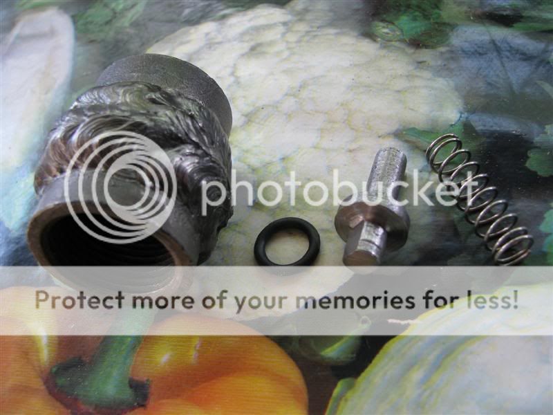

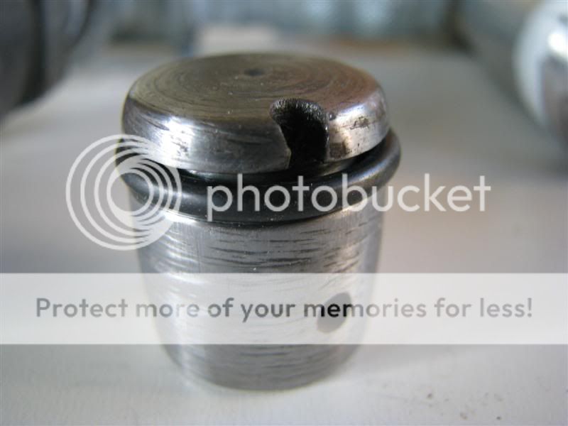

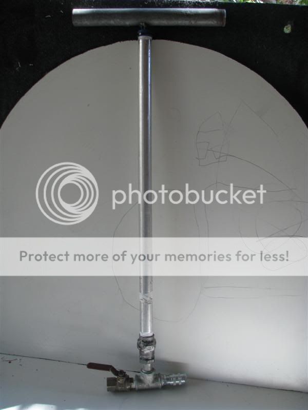

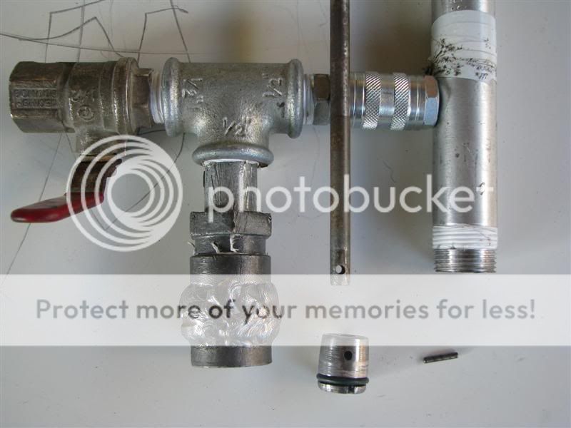

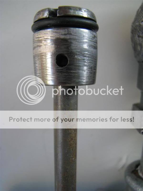

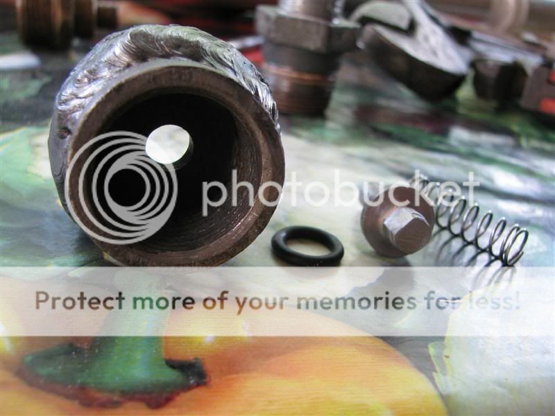

i finished building my new hand pump .and she work nice
the highest pressure i get from this pump is 700 psi
the cylinder is 2.7mm in diameter
the shaft rod is 8mm
any questions ? fell free to ask
and here the pictures of the lady shocky
the chick valve parts
the piston
the cylinder+shaft+chick valve
the pump stand waiting for work

Unread postAuthor: jonnyboy » Tue Jul 07, 2009 8:05 pm
Nice build, I thought about building a shock pump but I really don't have the need for one. :cry: I do have a high pressure project in the works but co2 sounds better anyway.
On your chick valve what 2 pieces did you weld together?
BTW nice welding job :lol:

jonnyboy wrote:Nice build, I thought about building a shock pump but I really don't have the need for one. :cry: I do have a high pressure project in the works but co2 sounds better anyway.
thank you.i have been welding a lot in my life.and the chick valve is galvanized 3\4" nipple with inner threads (i did not know what they call it)
twizi wrote:btw whats the cylinder
he is 3\4" aluminium pipe

Unread postAuthor: spudamine » Wed Jul 08, 2009 5:11 pm
Looks nice. Good work on the checkvalve, just watch that sucker for rust. mine needed rebuilding after a month, the steel bolt was severly corroded from water condensing inside the valve. used stainless the second time around.

Unread postAuthor: boyntonstu » Wed Jul 08, 2009 6:47 pm
I finished building my new hand pump .and she work nice
the cylinder is 20.7mm in diameter
Nice work.
A question about 20.7 mm and 700 psi.
20.7 mm is about 0.8" and that works out to about 0.5 sq in.
To get 700 psi out of 0.5 sq in you need to apply 350 pounds of force.
How do you apply 350 pounds of force?
How many cu in are in your chamber and how many pumps does it take to fill it?
I am following in your footsteps and I want to get it right.
BoyntonStu
