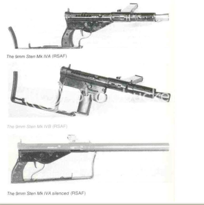

Unread postAuthor: boyntonstu » Sat Oct 24, 2009 9:17 am
jackssmirkingrevenge wrote:Have you considered a co-axial configuration?
I believe that the 180* turn around of a coax robs power.
Also, I wanted a 3/4" barrel to be able to shoot .611 marbles etc.
I may be wrong about the power, and if I am, a coax may be my next project.
I like the look an the feel of the Sten design more than a coax.
I can't explain why though.
Considering that design, could I have built it with fewer parts?
  • 0

Unread postAuthor: boyntonstu » Sat Oct 24, 2009 11:10 am
Ragnarok wrote:
boyntonstu wrote:I believe that the 180* turn around of a coax robs power.
While this is partly true, it'll be minor and not something I'd start worrying about until you've considered every other possibility for keeping up power - and I can see enough ways to coax more efficiency out of cannons that I'm not going to start chasing down this.
Indeed, although I like a cannon to be powerful, if you were to look at all of my cannons, there's one recurring theme. Some degree of ergonomics.
If they can't be practically hand fired, I don't make them. I wouldn't even consider making a cannon that was bench mounted or remote fired.
So, while something like HEAL does have its power hindered slightly by the two 45s and the 90 elbow around the back of the chamber (visible in this picture), I'm perfectly prepared to sacrifice that insignificant amount of power for the more practical design.
I like your HEAL very much.
My goal is ergonomics at minimum cost and complexity.
My gun is very light and easy to hold, aim, and fire.
The ball valve trigger handle needs a little more thickness for comfort and that would improve it somewhat.
According to Technician's analysis of the .wav file, the 1/2" ball valve opens fast enough to avoid the need for a QEV. That is practical..
A single shot needs to be held for just a moment.
A repeater needs to become part of you for comfort.
I was on the rifle team in college and we had to practically wear those Remington 52's.

Unread postAuthor: boyntonstu » Sun Oct 25, 2009 7:49 am
The Sten design was made by the thousands.
There are many add-ons possible to improve my gun if necessary.
BoyntonStu
  • 0

boyntonstu wrote:The Sten design was made by the thousands.
Millions, actually - but that doesn't mean it was notable for long range accuracy or controllability. There was a war on - the primary objective was arming as many troops as cheaply as possible.
They were made in their millions because they were the cheapest and simplest option, not because they were the best weapon - they frequently had problems.
In simple terms, they were better than having no gun, but they were far from ideal.

Unread postAuthor: boyntonstu » Sun Oct 25, 2009 11:56 am
OK
My gun has surprisingly little recoil kick. Almost zero.
(I wonder of the downward chamber position has something to do with it?)
I plan to install a laser below the barrel for aiming.
With a laser, I wouldn't have to hold the gun up at eye level to aim.
No kick, no down the barrel sighting, makes my gun ideal for me to shoot from the hip.
YMMV
BoyntonStu
