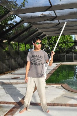

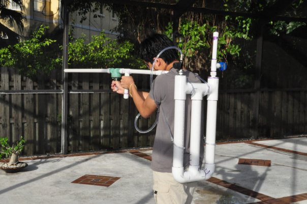

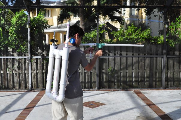

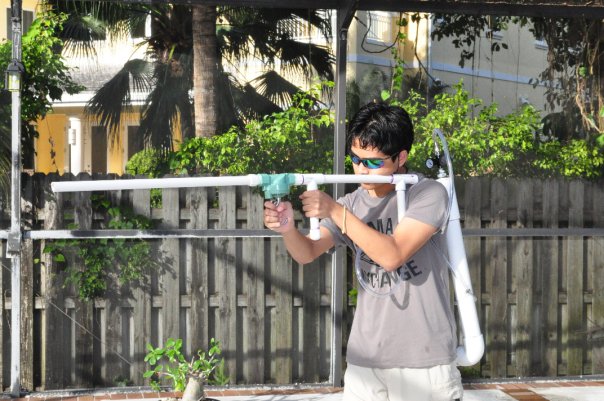

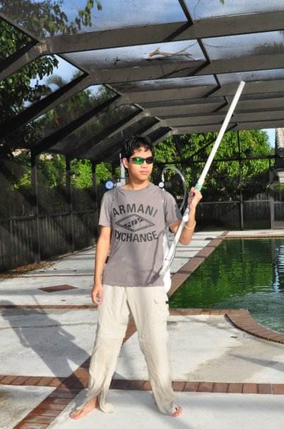

In each cannon, I try to add in 1 new feature. In this cannon, I added in an air regulator in order to get multiple shots. I have pressurized this to 80 psi.
Backpack: 3x 2" by 1.5' with fittings (~200 cubic inches)
Chamber: 3/4" by 2' with fittings (~11 cubic inches)
Barrel: 3/4" and 1/2" (~11 cubic inches and 5 cubic inches)
Straps: I use leftover tubing to create straps and no they are not pressurized)
Firing Valve: 3/4" Mod Sprinkler
The weird extension thing on the backpack contains my gauge and at the top is a schrader valve.
So far, I can get 3 40psi shots when the backpack is charged to 80psi.
