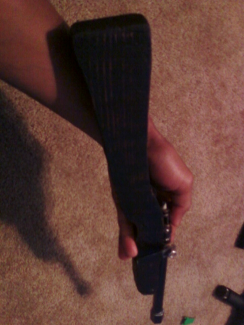

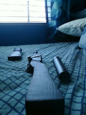

Been a work in progress for days now. i still need to apply clear coat/laquer. It is a single shot propane operated pneumatic. The chamber is very small(its the silver T behind the ball valve). To fill, you hold the propane with an airsoft propane adapter connected upside down, press down the bottle on the fill valve, then you are ready to fire. here is the fill valve http://www.airsoftpost.com/product_info ... s_id=27269 . I got this Idea from green gas powered airsoft pistols. this is what the propane looks like with the adapter http://www.airsoft.com/images/Green-Gas ... apater.jpg . I will make a video on how to fill/use it later to make it a little more clear.

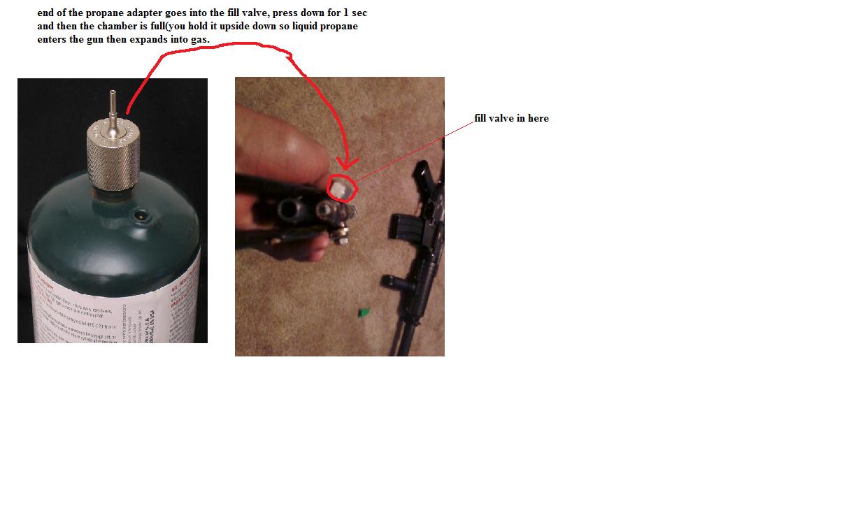

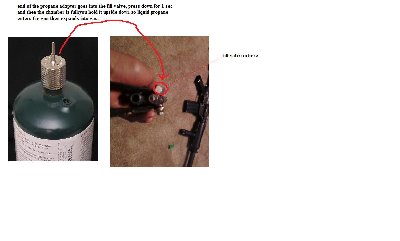

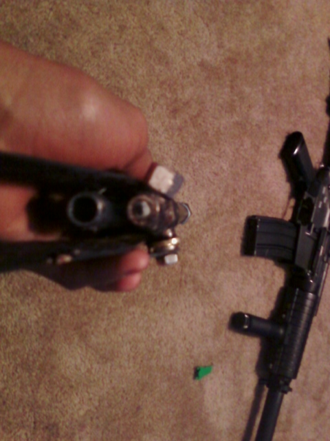

Neither, I have an airsoft green gas fill valve on the chamber. the chamber is only the T fitting. there is a plug on one end of the T, fill valve on the other end of the T, then the firing valve on the other. ill draw up a quick MS paint diagram for ya

Unread postAuthor: blind909 » Sat Jul 03, 2010 3:47 am
Okay, so this works just like an airsoft gas gun. you take the propane with the propane adapter, hold it upside down, put the nozzle up to the fill valve, push down, hold for a sec, then the gun is full. then you just pull teh trigger(open BV), then the liquid propane expands into a gas, therefore expelling the projectile. its VERY simple, and i get 1 shot per fill.

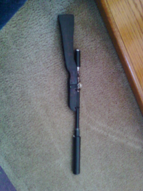

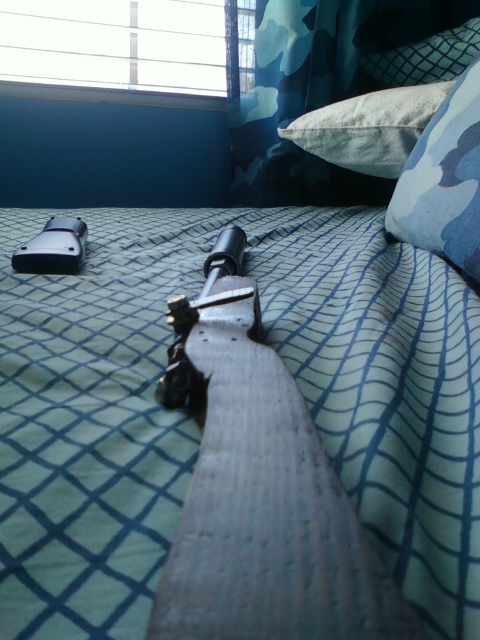

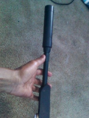

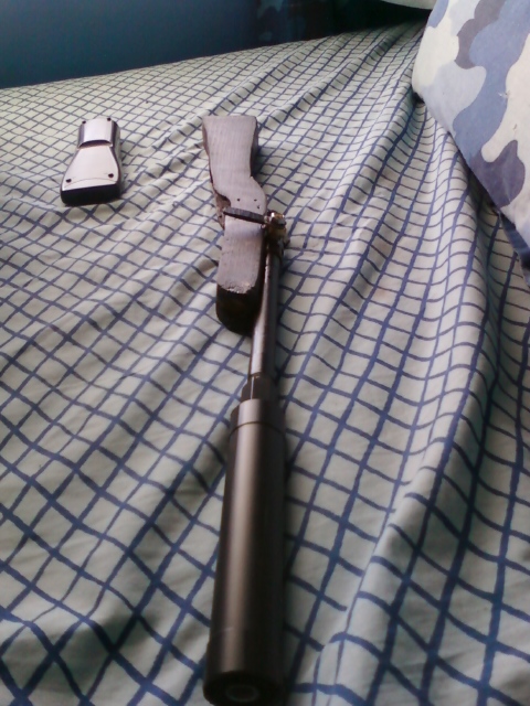

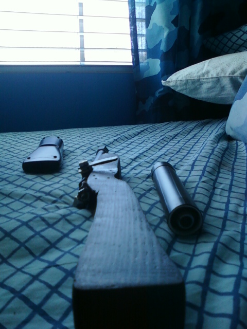

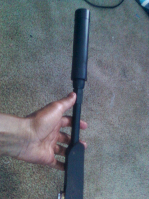

Unread postAuthor: blind909 » Sat Jul 03, 2010 12:24 pm
